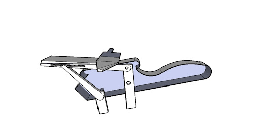

I would like to have a portable and easy tool to set my edge angles. For now I use my 2X72 belt grinder, but I would love to have a solution that I would carry it to some customers who have some really blunt or damaged edged kitchen knives. Some times I pick some of those and grind a proper edge at my shop then I drive to give those knives. But it is really a waste of time for a penny.
So I came up with an idea to have a portable belt sander attached with an angle adjustable platen. I have found a sander that comes with table mounting clamps.

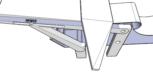

I sketched a plan of how to make the platen.
What do you think of this device, anyone using a similar system?
