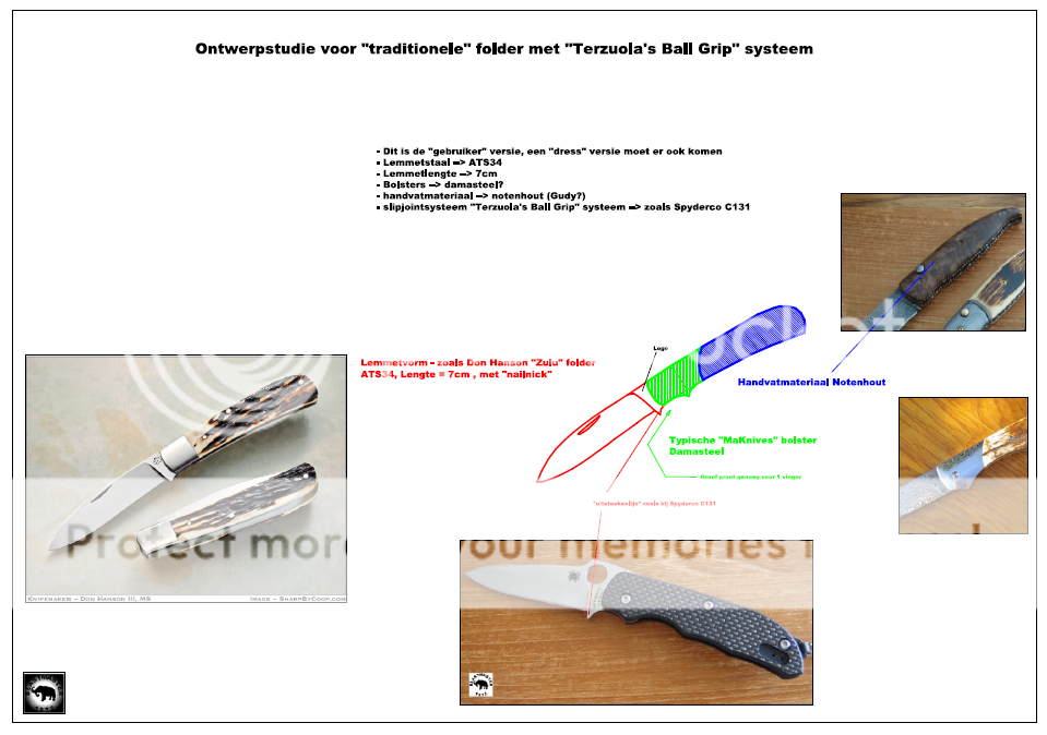

Maybe interesting for you guys (and girls) to see how this knife came to be:
Martin received from me a Spyderco C131 to study the system, and this "design study" of what I wanted:
First I planned to have the EDC with walnut scales and damasteel bolsters, but then it would have been "too nice" again to carry, so I asked Martin to switch to plain bolsters and green micarta scales.

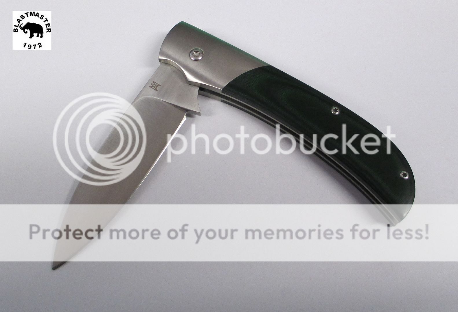

Perfect "Half-stop":

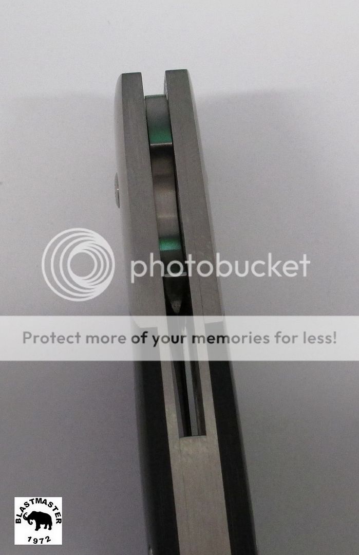

Detail of the back:

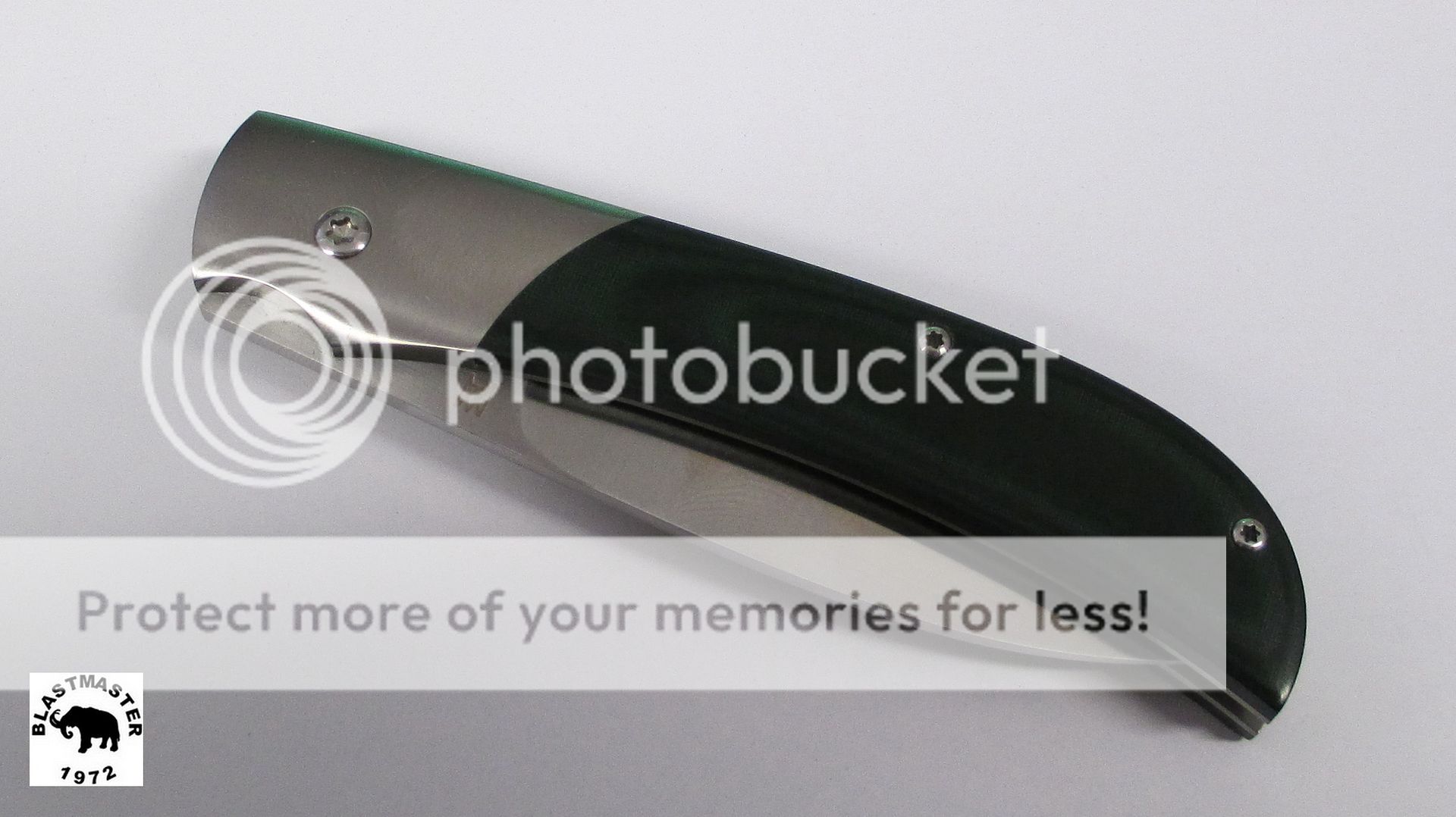

Closed:
