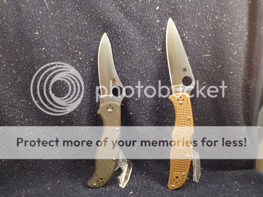

the stretch is a compact package , actually i like it better than my endura ffg zdp. the bradley is somewhat heavier & thicker but the m4 alloy will cut even longer than the zdp. also the bradley is smoother in operation.
I may have to snag a stretch eventually, but I did grab a delica in zdp-189, and its absolutely astounding. GREAT attention to grinds and angles from the factory, it sharpens up easily at 30 inclusive on the sharpmaker, and its kicked everything else out of my pocket for quite some time. I totally agree about the impressiveness of zdp, its my first "super steel" (if you don't count s30v), and I think its definitely head and shoulders above the rest.

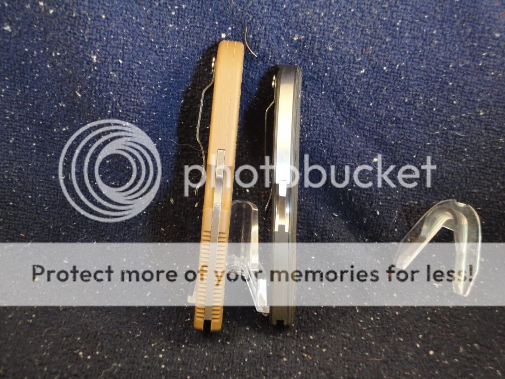

stretch on left & endura on right
although the endura in vg10 has about 1/4 in. more blade the stretch in zdp has a much more sturdy construction. however the stretch costs almost triple the endura. of course the zdp is much more durable in cutting ability. you may notice the tiny dimples on the knife tangs--both these knives were rockwell tested before formites tested them on sisal for edge abrasion qualities.

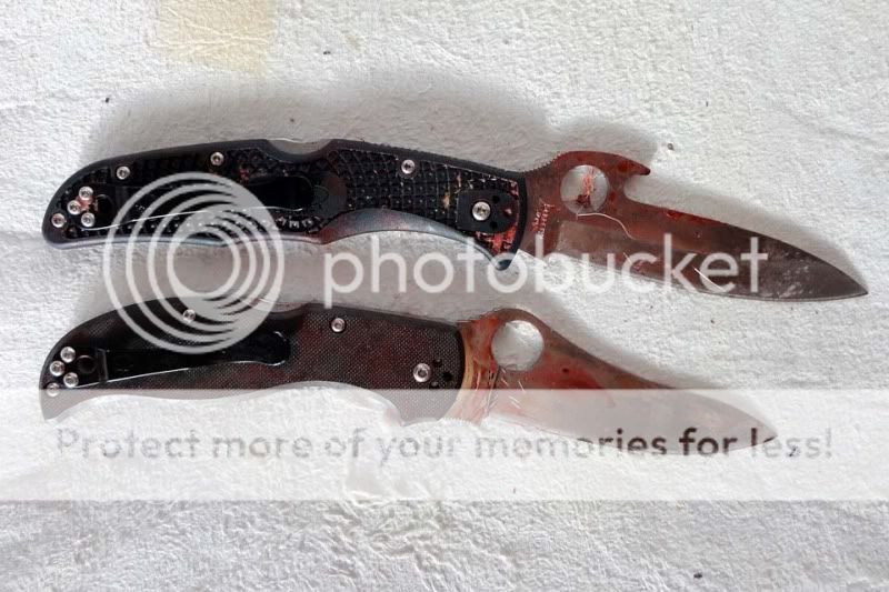

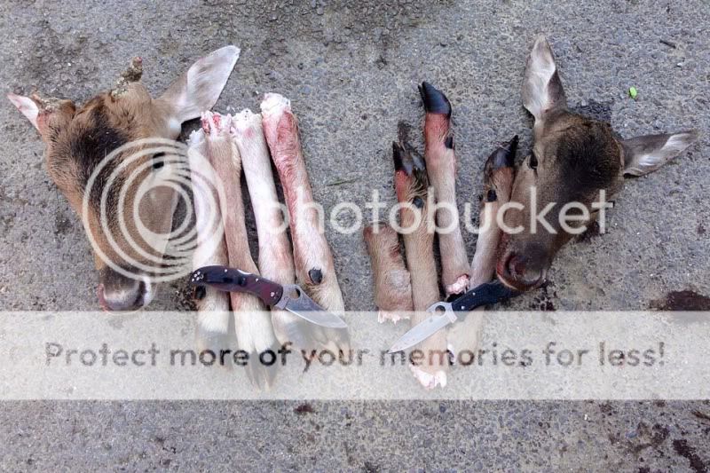

I did a side-by-side comparison of a Stretch CF/ZDP189 versus an Endura VG10 (Sabre grind) on a couple of deer:
Each knife did one deer, start-to-finish (field-to-freezer :D)
Taking off the legs, head and butchering the deer inevitably means contact with bone along the way:
I had no chipping with either knife and the ZDP was much sharper at the end (though both were pretty good.)
I must write-up the review as I photographed and video'd it specifically. Both knives had also done some wood and rabbit.
I wouldn't be worried about fish bones but corrosion might be more of an issue.
My Stretches have seen a lot of salty blood but have no patina or pitting:
This is no guarantee of how it would hold up to salt water, though.
