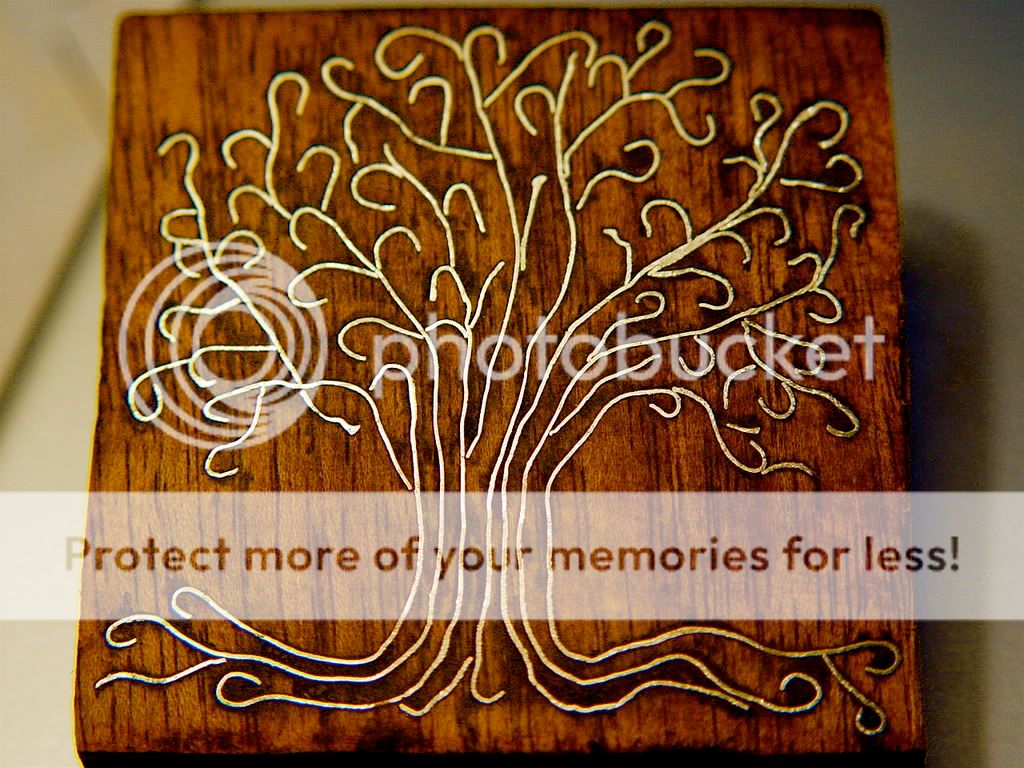

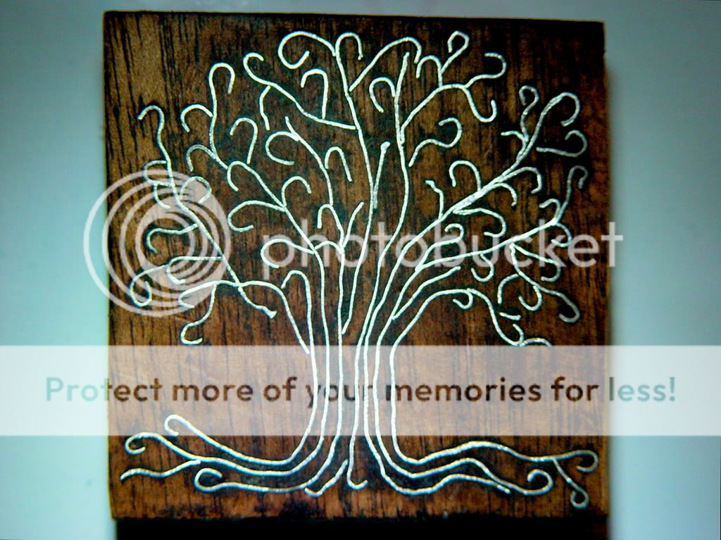

This is a little "practice run" I did this past week, took about 11 hrs., starting with a raw piece of mahogany and an old hacksaw blade for a "notcher." I used .010" sterling wire, dead soft. What fun!

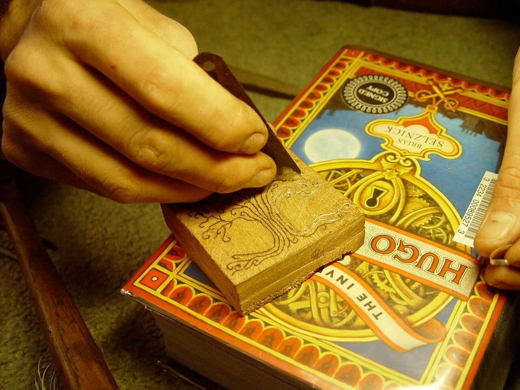

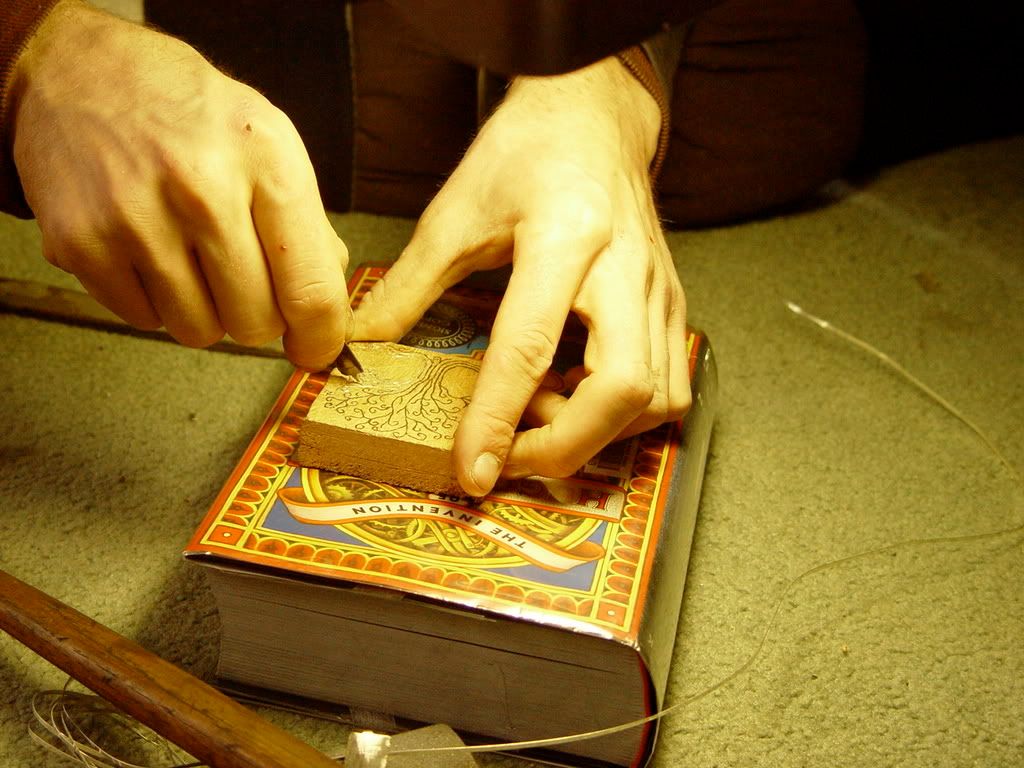

First I drew it out on paper, made up my mind about the final image, then drew it freehand on the wood with a ballpoint pen, using the paper as a reference. I made a hacksaw blade tool about 1.3 mm wide and notched it in little by little. I used a simple pair of scissors to cut the wire, and a small-faced hammer to pound it in. Then of course I sanded it all down and stained the wood.

Nice job on the tree of life theme.
On future projects, use a small flat file ( #2 barrette works well) and taper the end of the pieces that merge into another strip...as where a branch or spiral separates.
Set the long strips first and then cut the lines for the branches. In cutting the lines, start at the end of the branch, and work back into the main strips. The tapered end on the branch wire will make the branch strip flow out of the main strip almost invisibly. Tapering the terminal end of a branch wire makes it not end so bluntly.
Also, cutting the wire strips at a slight angle, about 60-70 degrees ( top to bottom), makes insertion of the strip easier to start. On branches, this will cause the tip end to push tighter against the main strip it merges with. On the ends of any wire, it makes the end of the cut line disappear completely.
Other effects that greatly enhance the eye-appeal of inlay are:
Use two or three different thickness of flat wire for the lines. Start with the thicker at the base, and go to thinner as you progress toward the ends. Do side shoots/spirals in the next size down from the main wire they diverge from.
Make some of the branch tips end in a snake's tongue split.
Drill a hole, and drive in a piece of round silver wire at the end of a spiral. Vary the round wire size a bit ,say 16,18,20 gauge.
Run a very short strip of wire off a branch , and drill a group of three holes at the end. Use round wire in the holes to simulate leaves. You can do this at the end of any branch,too.
One of the old books to teach women charm said,"A little lipstick makes a girl look like a woman....too much makes a woman look cheap. ", so don't add too many leaves, a few go a long way. Brass or gold round wire make great leaves.
On a flowing spiral motif, with lots of short spiral off-shoots, make it into a grapevine. Add the short off-shoot as with the leaves mentioned above, but make it into a grape cluster. Using brass or gold wire for the grapes make for more contrast. Reduce the wire gauge as the grapes get toward the end of the cluster.
These simple changes in wire size and taper perspective make a huge difference in the look of inlay. The work quality can be the same, but the look will be much more detailed.
