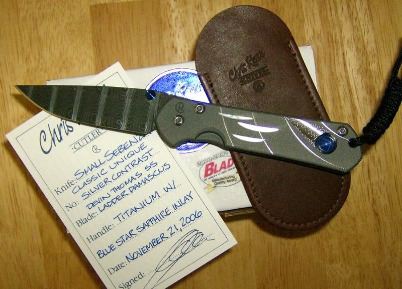

The picture below is a small classic with ladder pattern SS Damascus. I've used it to whittle more sticks than I can count. The blade has is still factory sharp and never been resharpened. USE THIS STEEL!!
