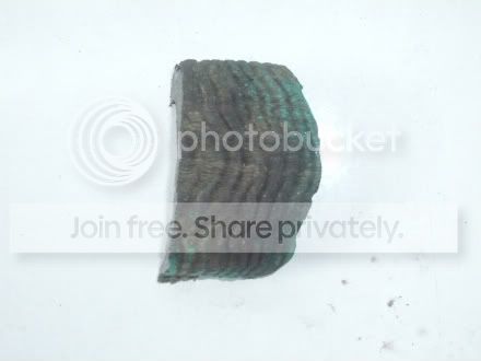

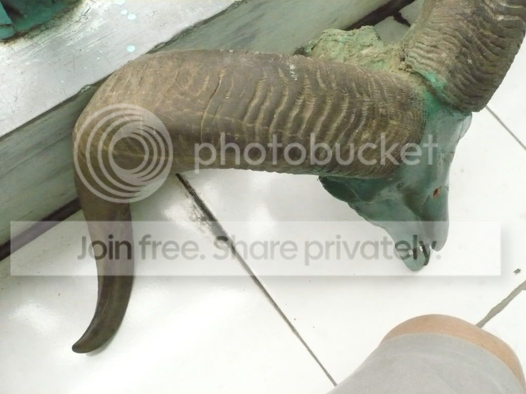

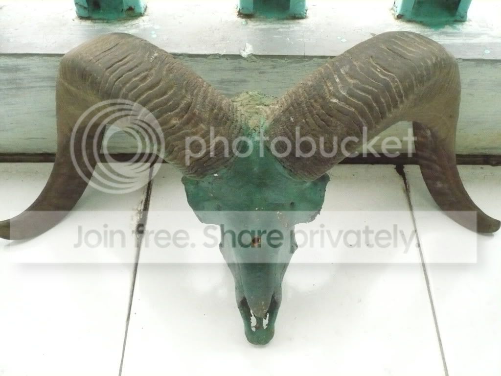

hi, i'm starting to make my first knife (as hobby) and want a sheep horn as my handle material.
so i buy a horn from local farmer. not the best specimen though and just buy it for a learning purpose.
I wanna ask:
1. can this type of horn can be used or good as knife handle
2. can i used and flatten this horn as knife scale
this horn feel stiff. any input will be much appreciated
best regards hendra

Yes those will make several sets of scales. You can boil them for several minutes and then straighten them in a vice. You may need to do that more than once to get them straight. Great Score Though!
Jason
Jason
You will need everything ready to clamp in vice. Wear gloves and go straight from pot to clamping!
A word of advice this is best done outside and not in Mamma's best pot! :eek: It stinks to high heaven when you are boiling! ;)
It stinks to high heaven when boiling,it stinks when cutting,it stinks when grinding,it stinks when sanding,but sure makes a pretty handle.
Stan

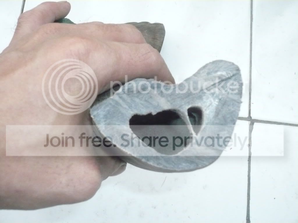

If it is a small handle or just inlays, you dont need to boil and straighten, just find a flattish spot and sand down what you need. Doesn't look right for 9mm.. maybe 30-06 or 308.
@ all thank you for the input and very much appreciated
i will try the method , hopefully i can straight it cos it's very hard more than water buffalo.
i think the hole is not a bullet, it's a nail. coz here civilian cannot have gun. and the sheep is domestic animal mainly use to fight.

Don't boil the horn unless you want to let the horn dry for 2-3 years. you need to use dry heat like an oven to straighten horn.
They seem like a very impressive set of horns. How much does an entire sheep head cost? Can you tell us where you are located please?

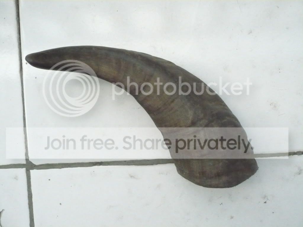

i think this one is old and dry. just cut a small piece and boil it and flatten in 2 piece of wood. hope it works.
You can boil the sheep horne but use vegetable oil instead of water as the horne will need to be dried for a while as stated above. I cut the horne first with a band saw. The top face will be the thickest and usually has the best pattern so I cut around where the corners are. This gives me a thick strip which gets boiled in vege oil and clamped between two pieces of wood untill it's cool. I pad the wood with two strips of leather on the inside so the pattern of the horne isn't squashed flat.
thank's i will try it. i don't have band saw. cut it with hand saw and wrong. oh well i will use this horn as learning.

thank you sir, this one is not the best. i missed 2 pair bigger than this one :(
this pair cost me around 22 US$ at front of my door. i hope this price is not too expensive.
i live in the south east :)
