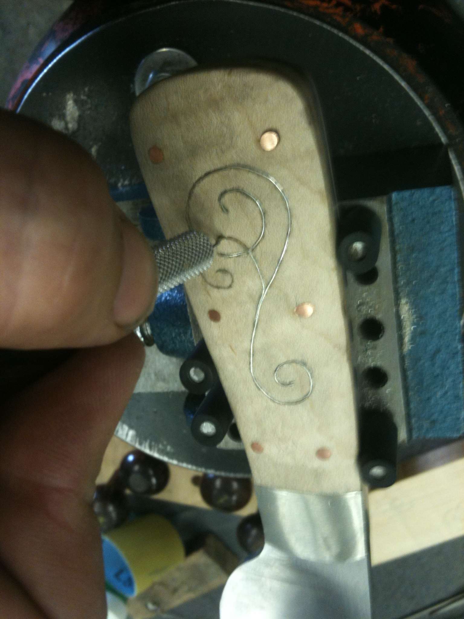

Next we covered silver wire inlay. Which I of course wanted to learn so I decided to put some on my chopper. I went with the demonstration pattern Joe used as it gave me the chance to use pins and have lines crossing over each other etc.

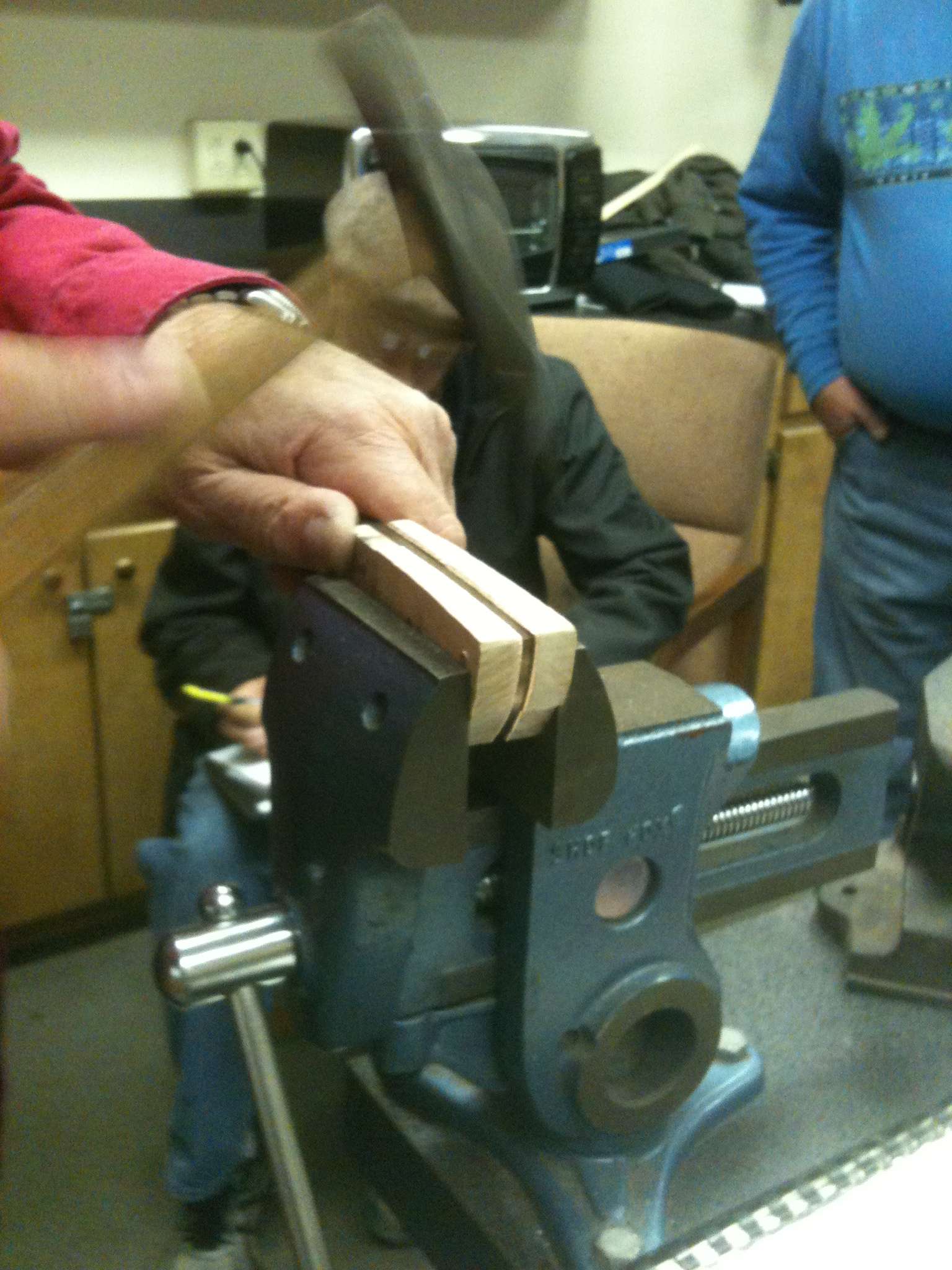

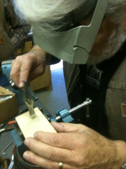

After covering the finishing of a maple handle we moved on to the narrow tangs. Mr. Keeslar favors soldered guards so that is how we did it. I would suspect that if you took the class from someone who presses their guards that would be what you would learn. Here is Joe Keeslar soldering a guard:

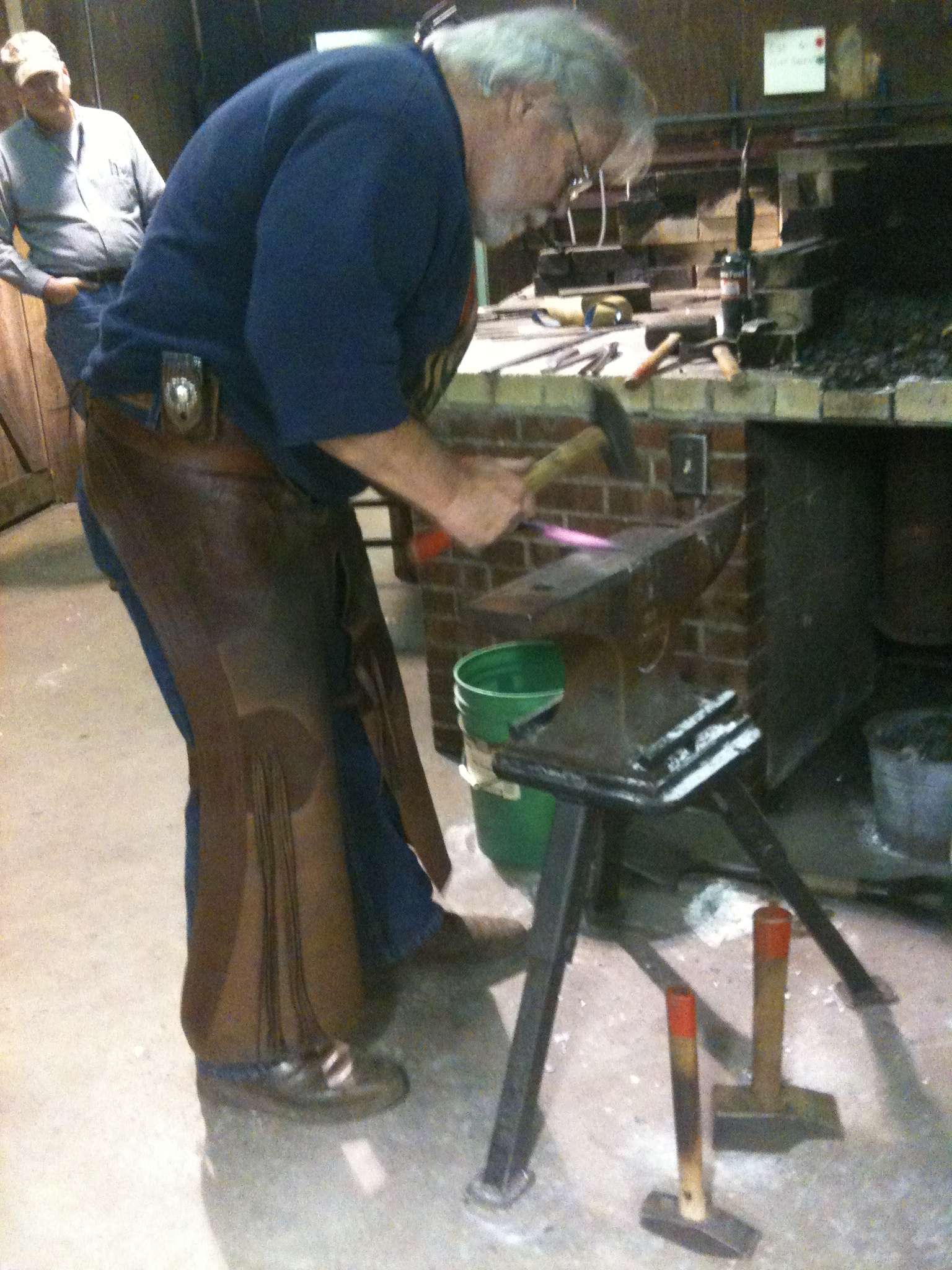

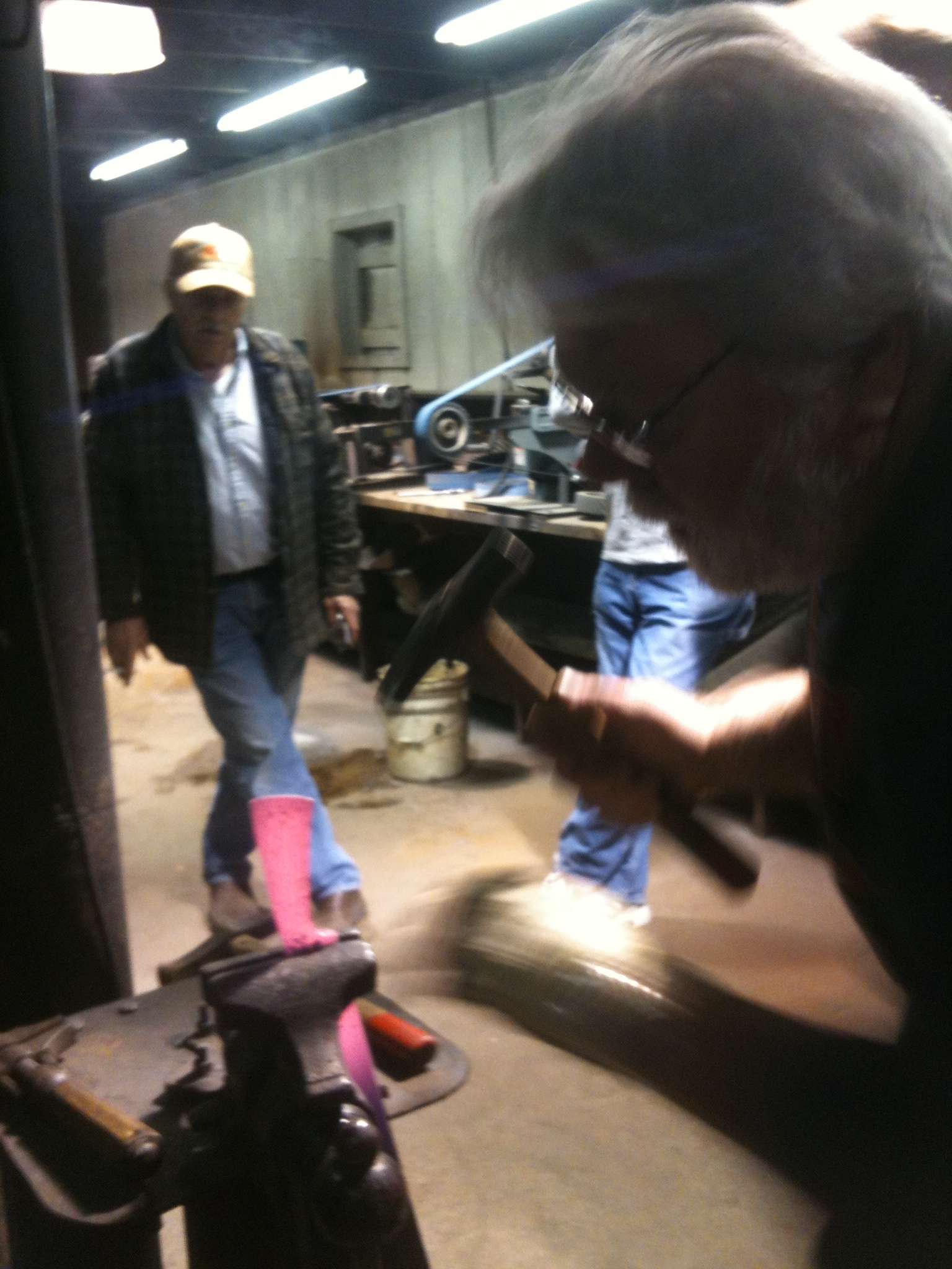

Other topics that were covered included: Pin usage in keeping spacers lined up with handles, laying out a leather sheath, butt cap construction, and by popular request the forging of a Brute De Forge knife:
By the way, the man swings a BIG hammer!

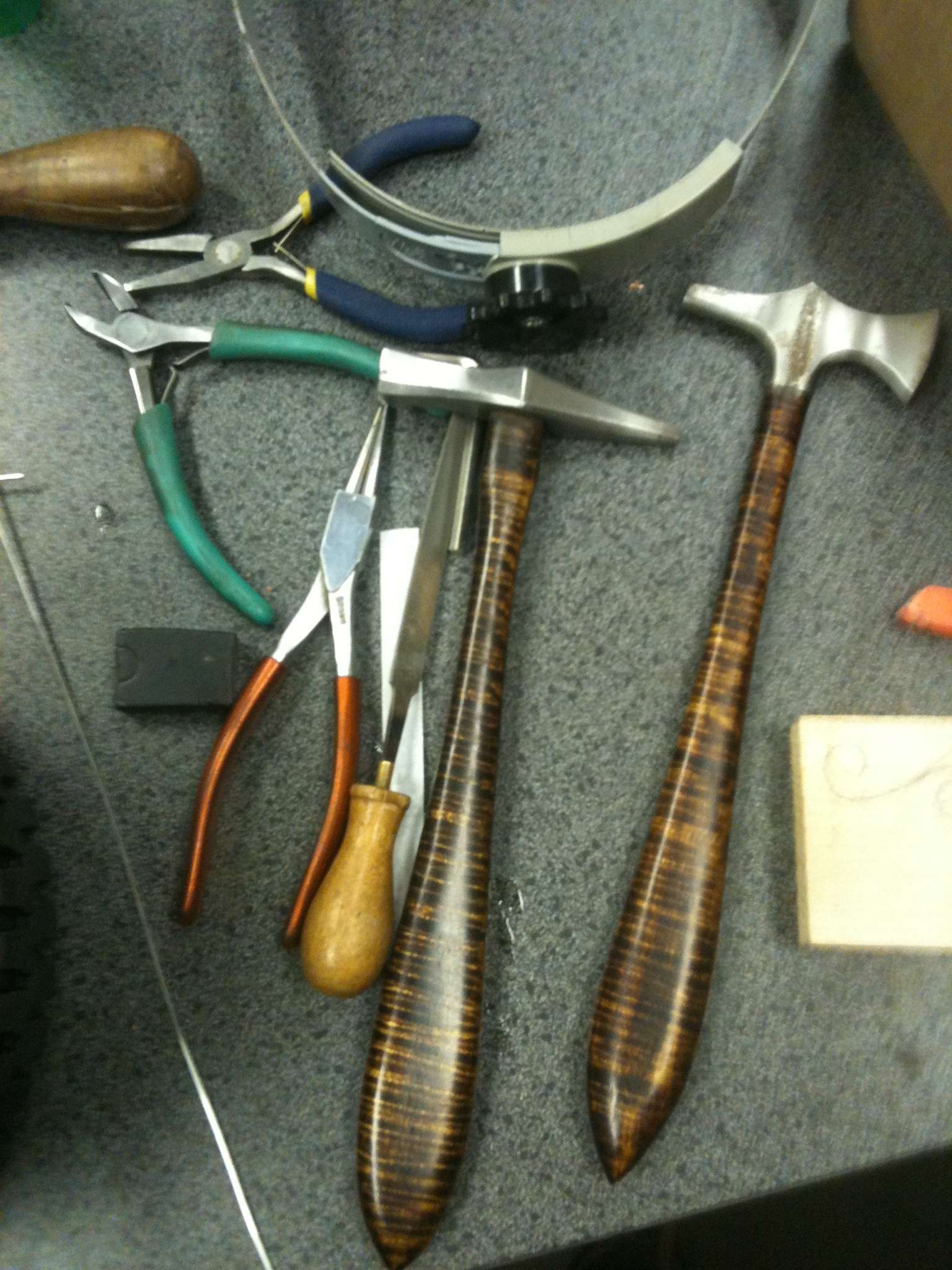

In this picture you can see two hammers that are used for inlaying. The one on the right is a Moran style hammer the one on the left is the one I preferred.
And here is a shot of Joe Keeslar demonstrating silver wire inlay.
Here is a link to an article about silver wire inlay also by Mr. Keeslar: http://www.blademag.com/article/silverwireinlaypartone/
This is part two of the article: http://www.blademag.com/article/silverwireinlayparttwo/

Am I the only one blown away by the grogeous maple handles on those two inlay hammers? :eek:
Roger
Roger
They did have some really tight figure. I took away a greater appreciation for curly maple. In fact both of the knives I worked on there will have curly maple handles. And I will also have to try my hand at making one of those little hammers when I get some free time.

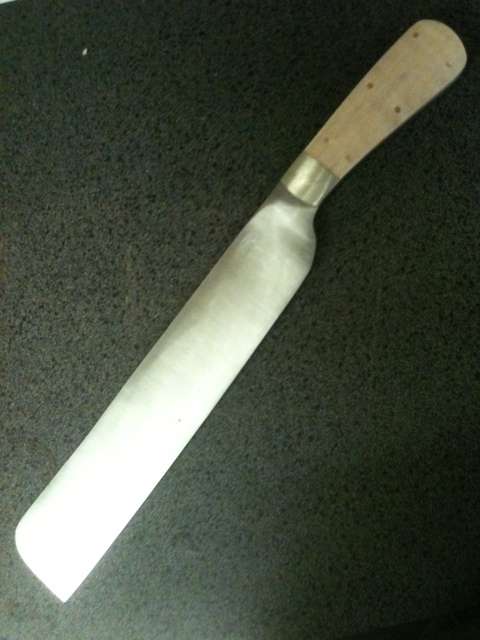

Here is a quick picture of the first of the two knives to be finished. I made it to be competition cutter sized (10'' blade 15'' overall) so that I could practice cutting things. I also gave it a scotch-bright belt finish so I can clean it up quickly after the abuse I plan on giving it.
