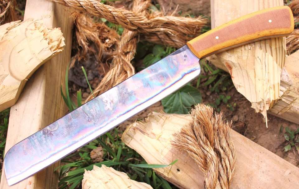

This past Thursday I took the ABS J.S. performance test under the supervision of Master Smith Lin Rhea. I PASSED!
This first video is of me cutting a 1'' hanging manila rope:
[video=facebook;10150959311799864]https://www.facebook.com/photo.php?v=10150959311799864[/video]
In this Video I am cutting through one of the two required 2x4's.
[video=facebook;10150959305464864]https://www.facebook.com/photo.php?v=10150959305464864[/video]
In this last video I am bending the 90 degrees.
[video=facebook;10150959297384864]https://www.facebook.com/photo.php?v=10150959297384864[/video]
This was done at the monthly knifemakers/collectors meetings that take place in Little Rock, AR. Chris Montgomery (Who happens to make some nice knives.) took the videos.

I'm not yet upgraded as the second part of becoming a Journeyman Smith is to take five knives to be judged at either the Blade Show or at the ABS's show in San Antonio. However, I am very happy to have successfully completed the first test.
Congrats Allen. You and your knife performed great. I am sorry for the poor video quality. I wish I had a good camera with me but the phone was all I had. You nailed the heat treatment on your performance test knife.
Some additional information, Allen performed the required cuts and then after the two 2X4 cuts he cut the hanging rope again without even the smallest hesitation from the knife.

Allen's knife sprang back very well with a nice even curve throughout the length. That shows a thorough draw back and good distal taper. His understanding this speaks well of his future work. Great job Allen.
