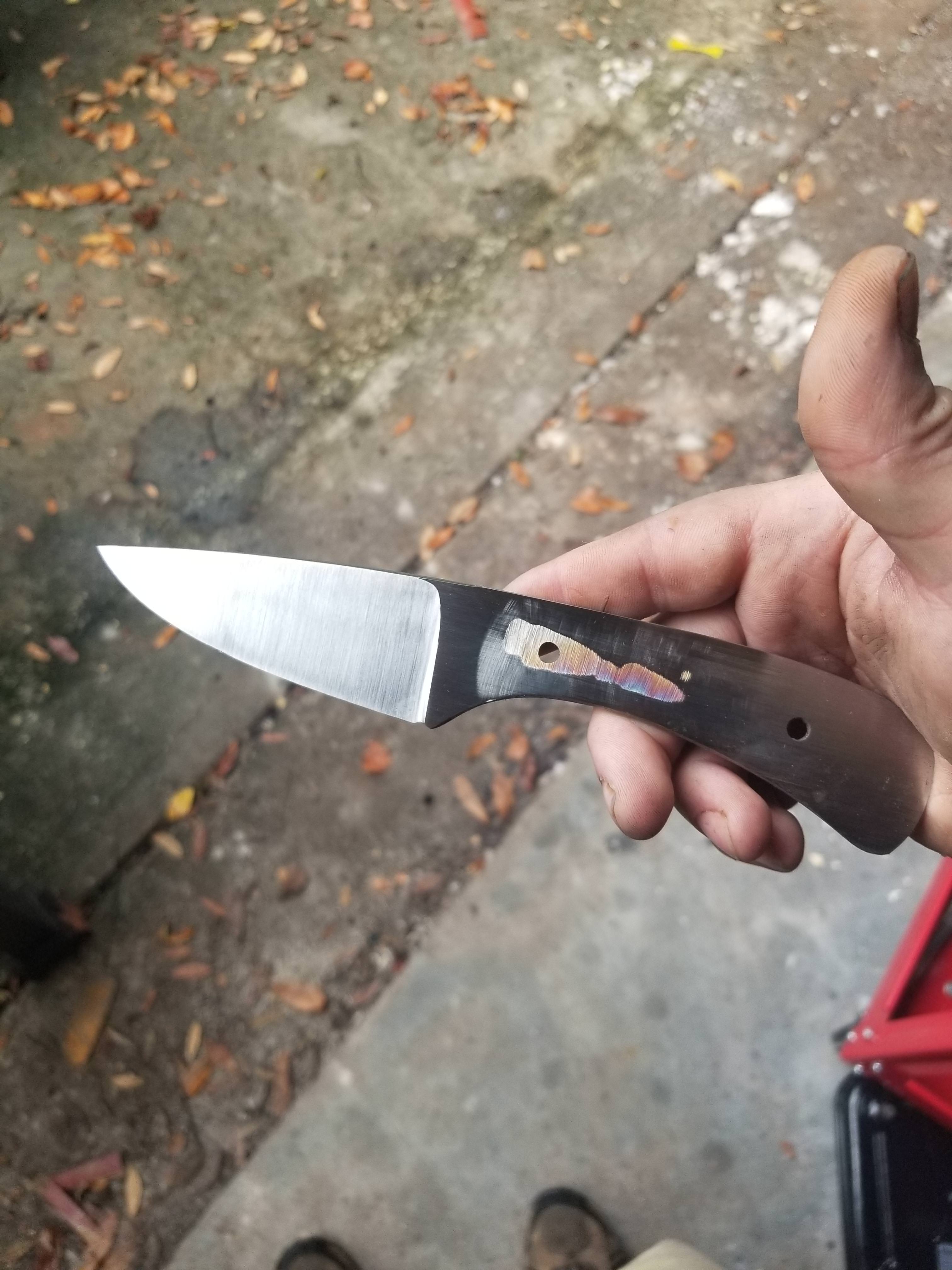

I work through A100, A65, A45, A16 then go to a 400g cork. Works for me.
