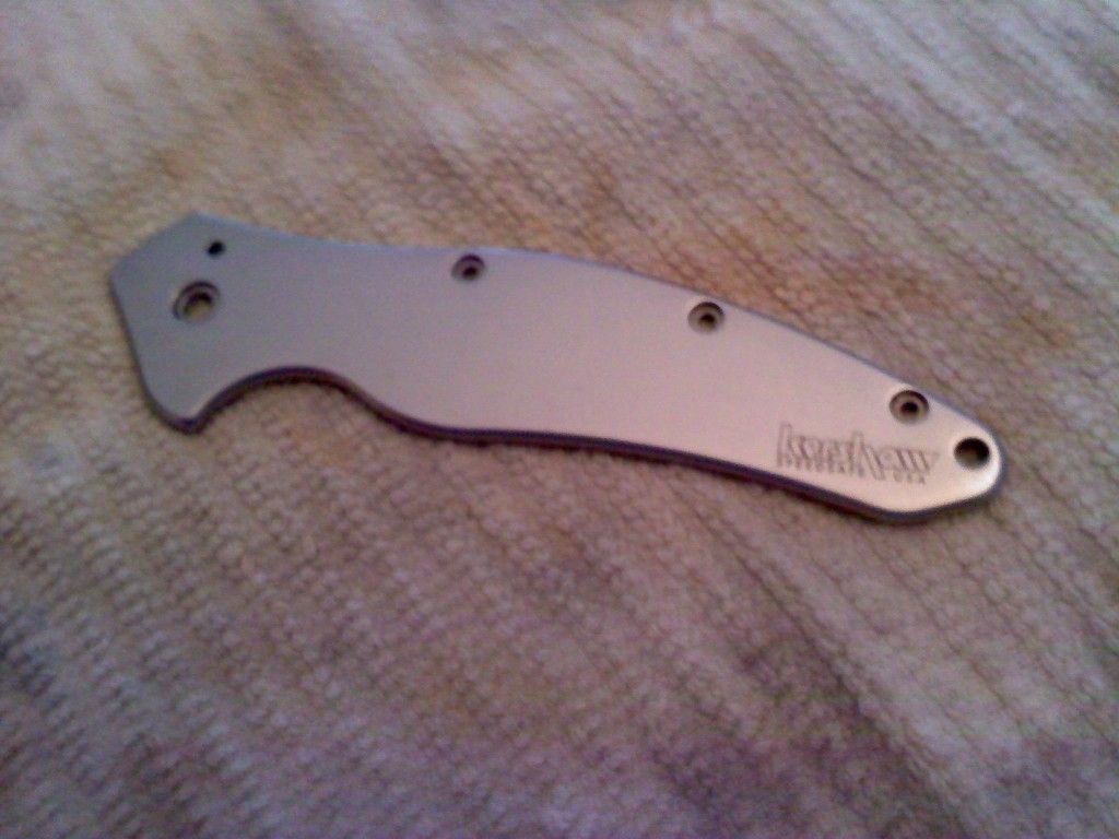

The first picture shows the plain scale that has been degreased

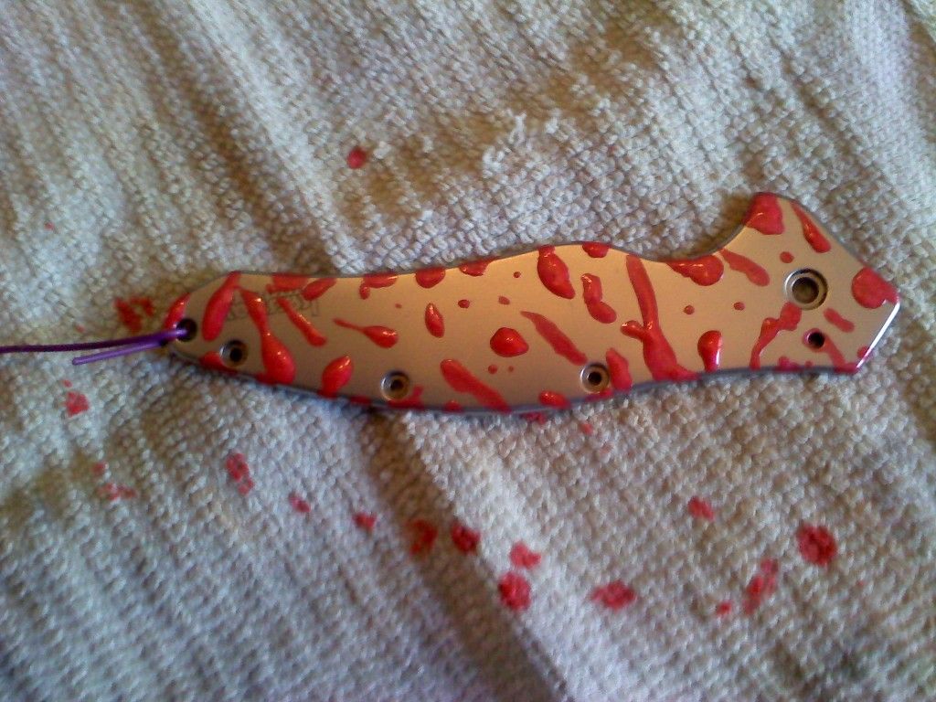

Next I splash red finger nail polish on the scale to block the acid in those areas. (I used red for people to be able to see, but generally I use clear).

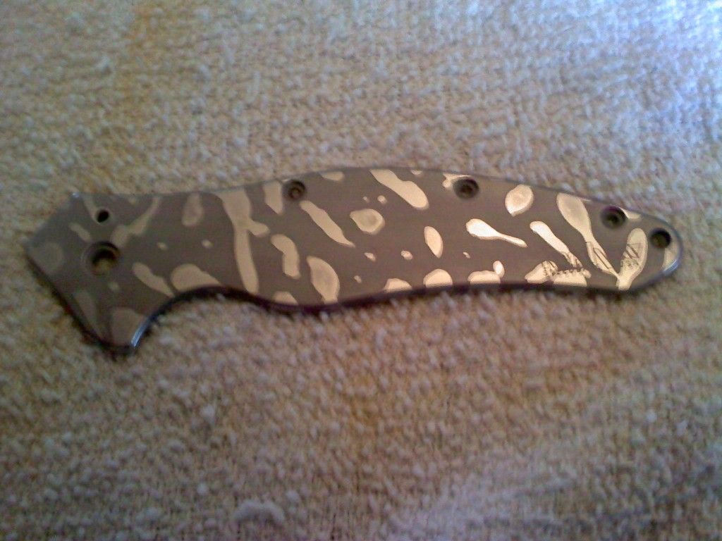

The next stage wasn't shown but I dipped the scale in Ferric chloride for 45mins, then neutralized with hot water.
after using finger nail polish remover (with acetone) the knife was left with this finish.

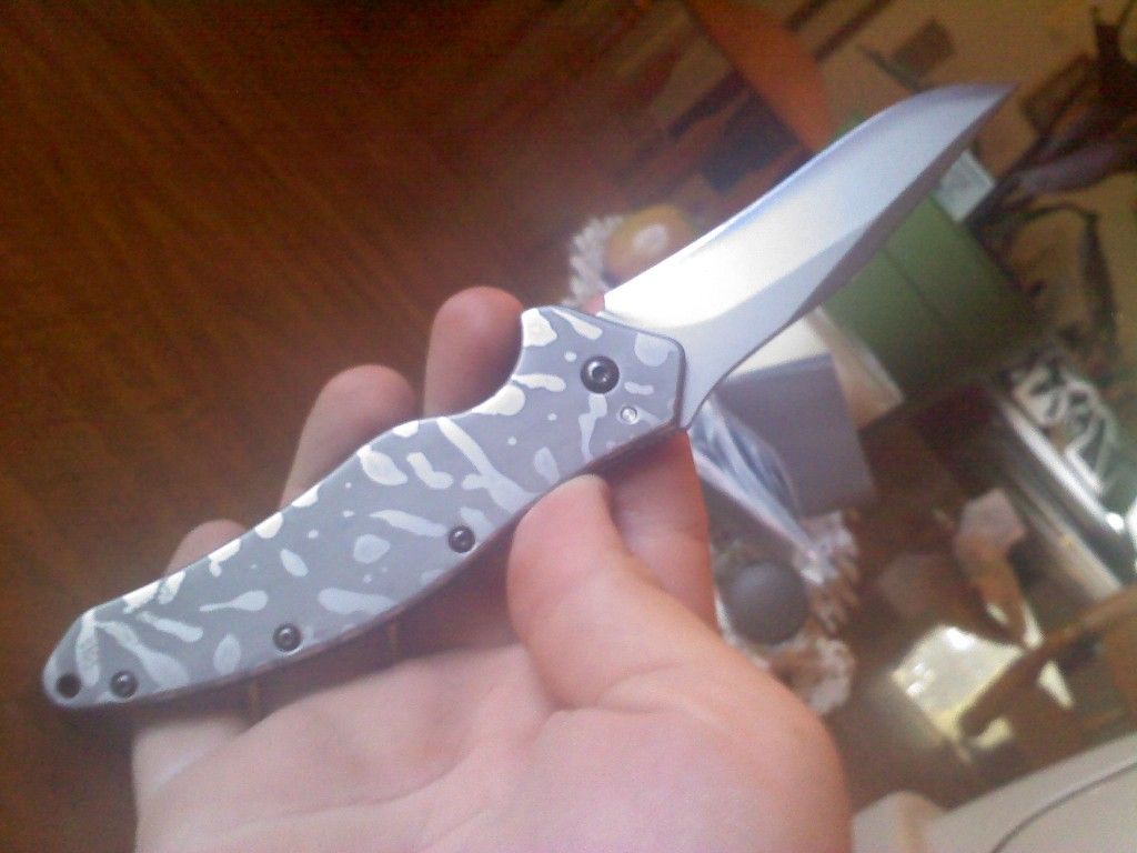

all reassembled and pretty after steel wooling with 000 steel wool.
Super cool! How do you do the fingernail polish splash? Is it a drip technique or flinging of the brush? Where do you get Ferric Chloride?
1) I just flicked the brush at the scale. Nothing too specific, just get it to drip :)
2) Ferric chloride can be bought at any radio shack. Its also known as PCB etching solution. If you go to Radio shacks website type it in and you'll see it. I payed like 15 bucks for it about a year ago, and I'm still using it.
hope this helps
Will this work on the blade as well? I'm not very familiar with this process and might give it a go as well since you peaked my curiosity. Yours came out great BTW.
Thanks, I have done it to blades before so yes it does work.
Some steels get darker than others and some steel stays lighter but still etches. I find stainless steels take longer to etch than carbon steels.
