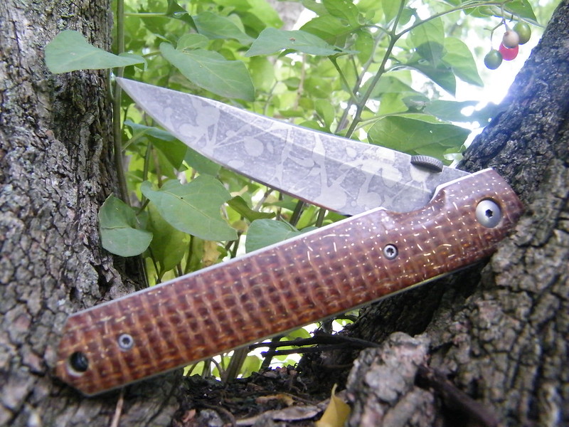

Acid stonewashing refers to two separate processes. It starts with soaking the knife in ferric chloride (etching solution) to get a dark etched coating/patina on the blade. From there it is cleaned and dried. The next step is a stonewash, which provides a high contrast between the dark acid etch & fresh scratches from the stonewashing...like this:
Here is one with a splatter pattern in addition to the acid/stonewash:

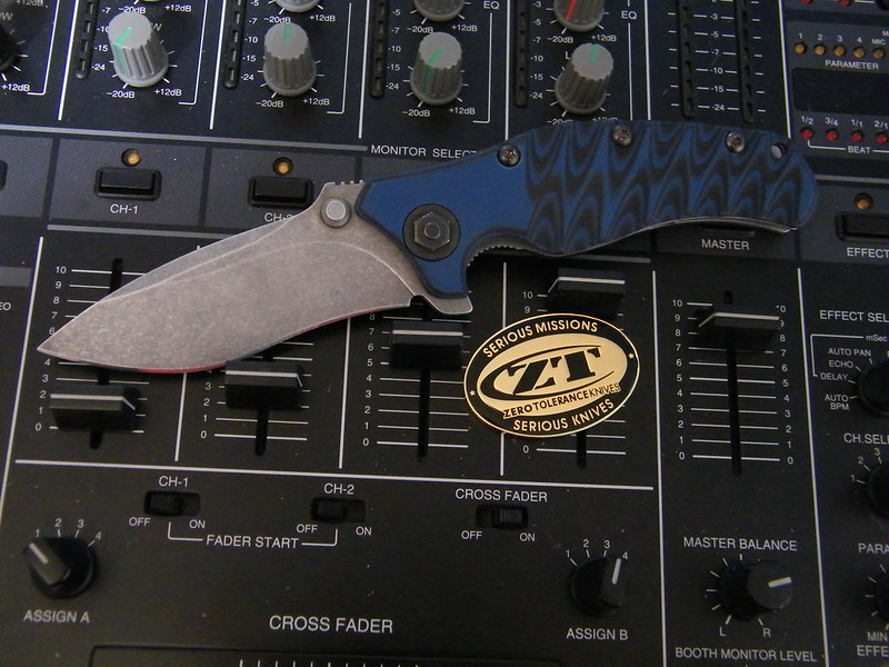

Here's the result of my DIY acid stonewash...
