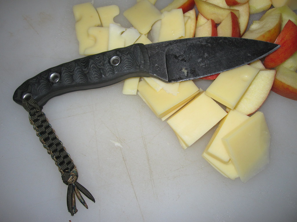

I am not sure about the coating thing. But you said you sanded the parts so that should have removed the coating . I have had good luck getting a darker finish by wiping the PCB on and letting it dry then repeat until you get the dark color you want. It will look uneven but it will even out after stone washing . Here is a pic of a O1 blade I did with this process. Different steels react differently to the pcb so you might not get that exact finish but you should be able to get a darker finish this way than submerging the parts. Best of luck getting the out come you are after.
