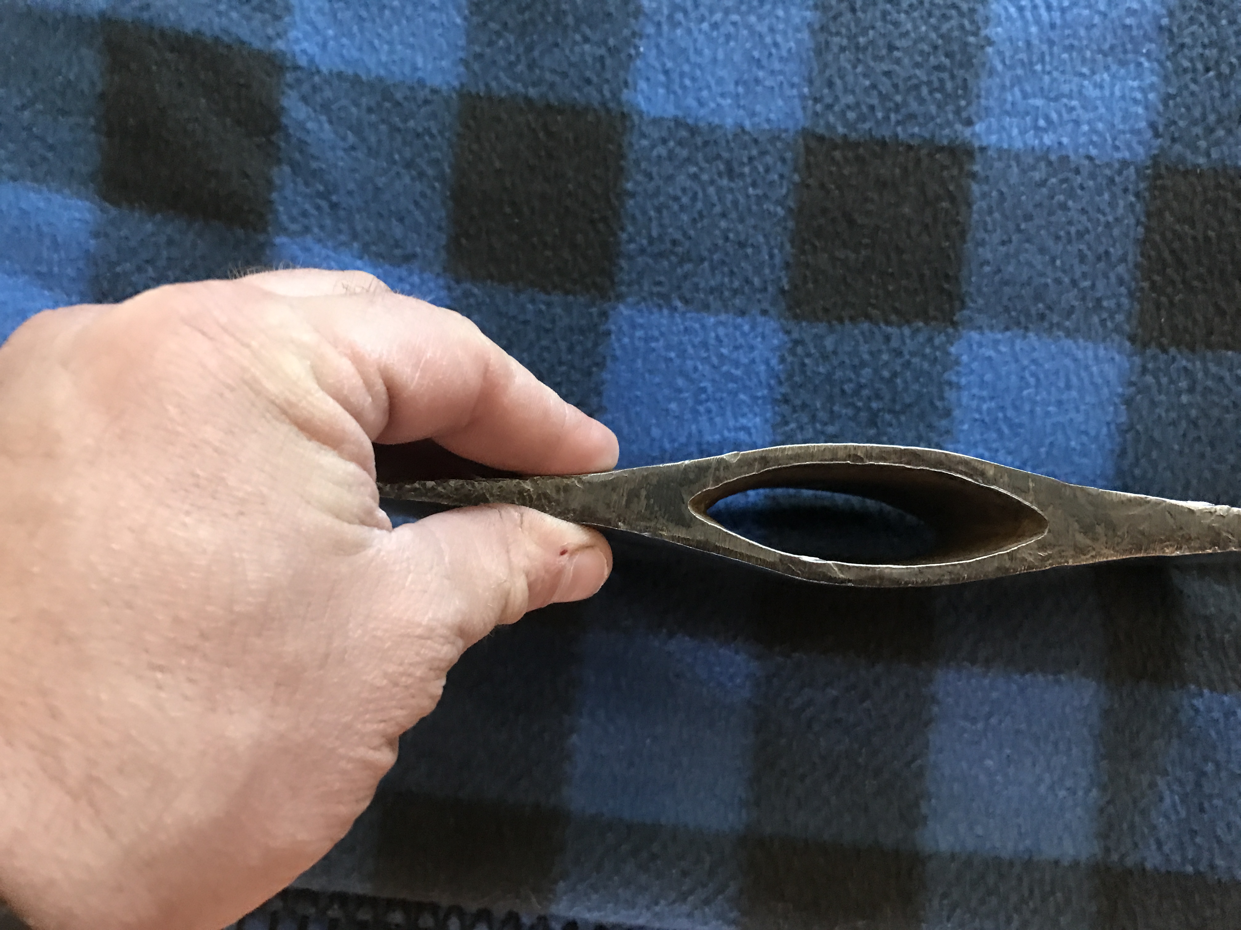

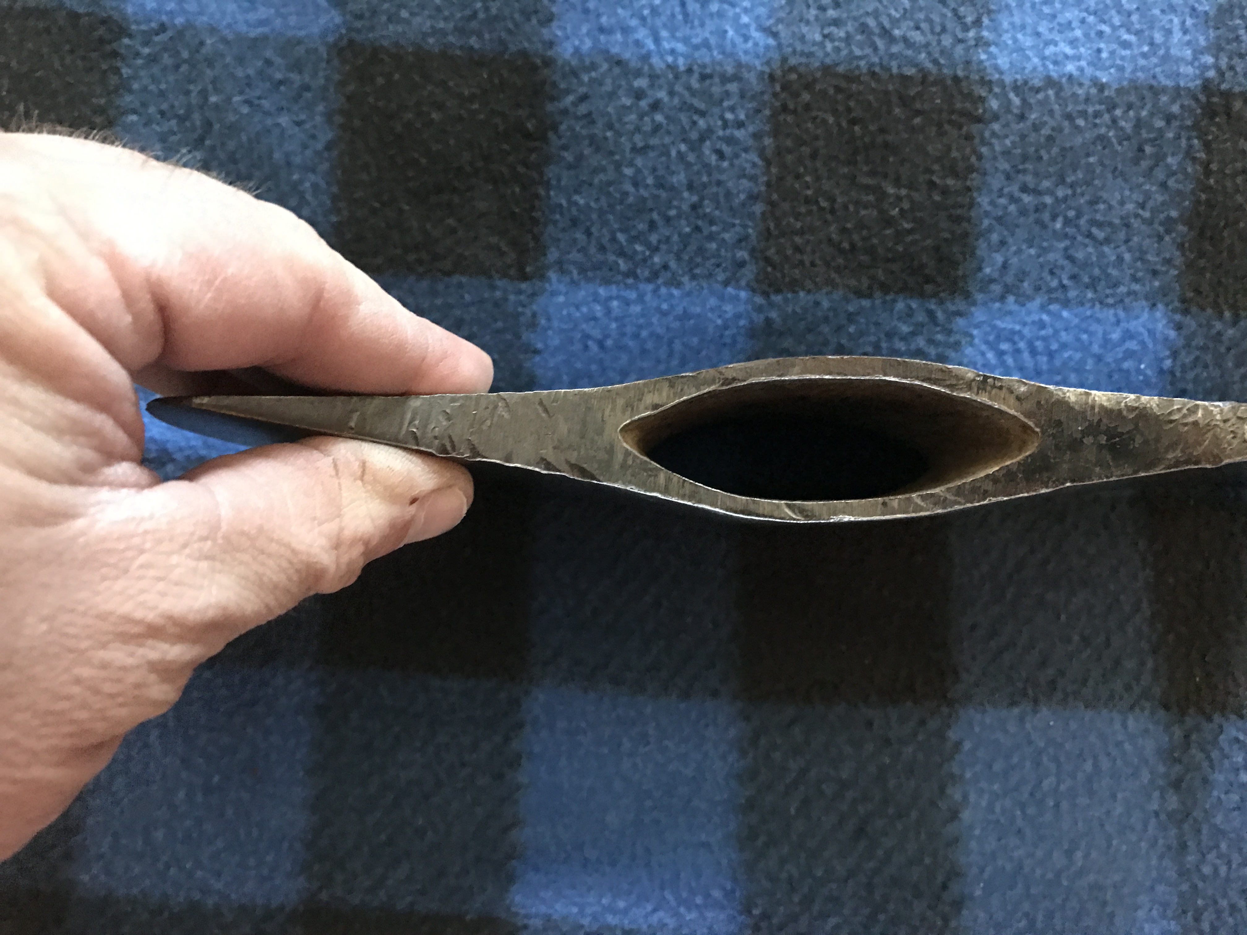

Eye size is going to dictate the choice of factory handles unless you decide to whittle your own. Anything around 2 foot long is going to be awfully short for that sort of head weight. Great first time project. You're starting off with an excellent piece of steel and straight hafts are much more forgiving, and easier to work with, than curved.

Any and all cruiser handles are going to require several wraps of hockey or electrical tape or wire in order to fill the eye of a full size head. Whittling stuff down is standard practice but up-sizing is not. Buzzing the end off a full size handle in order to achieve 24 inch will also wind up looking and feeling hokey.

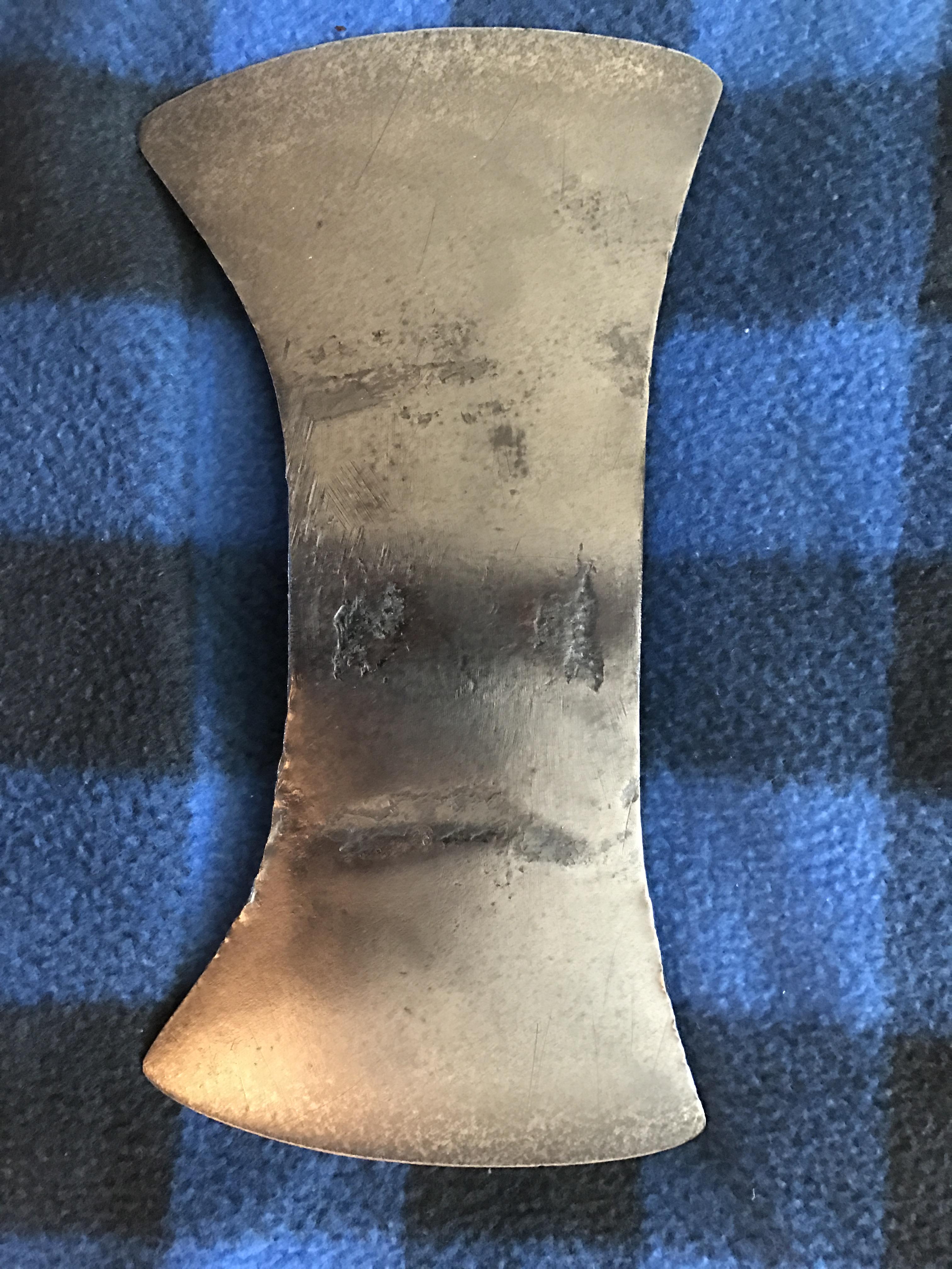

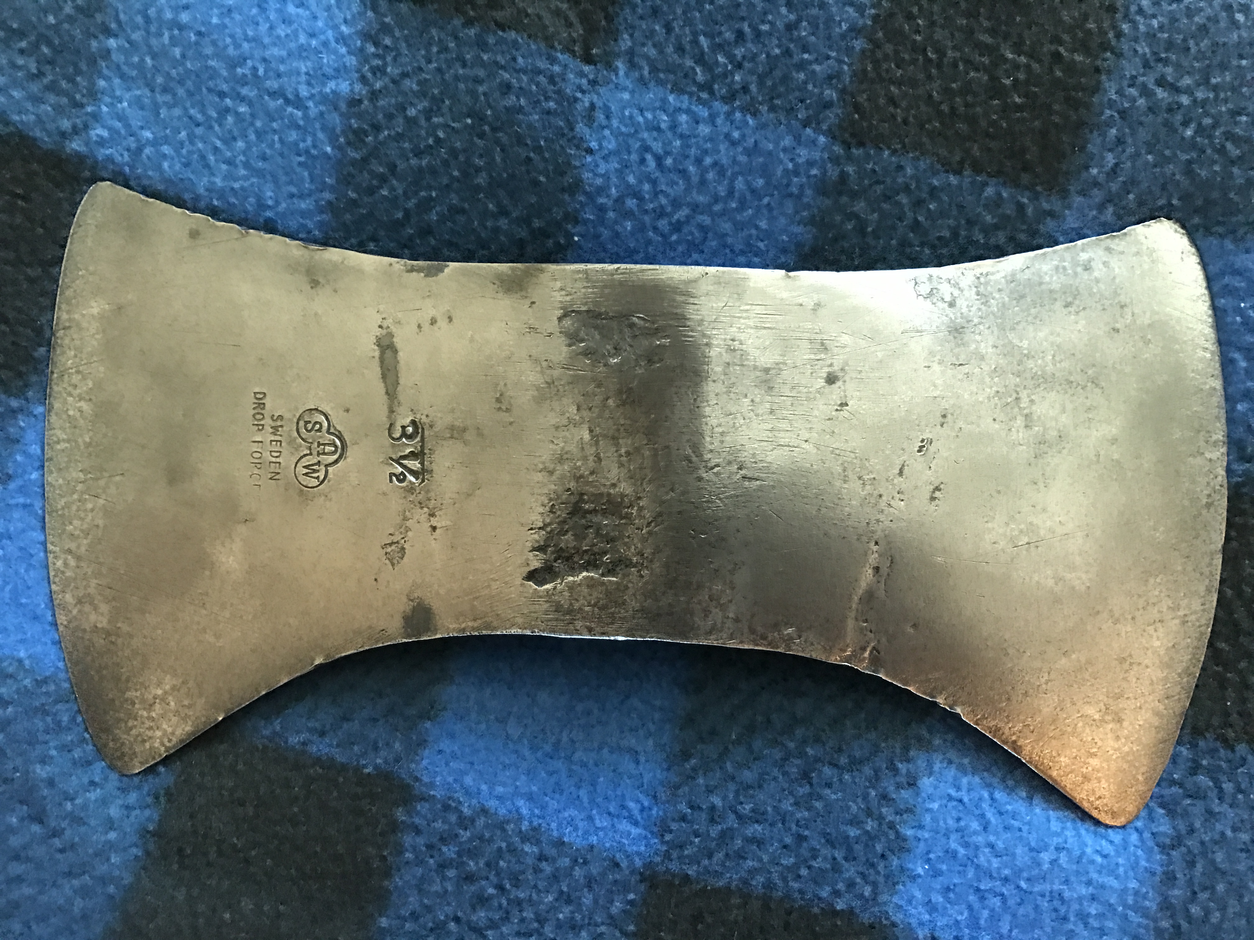

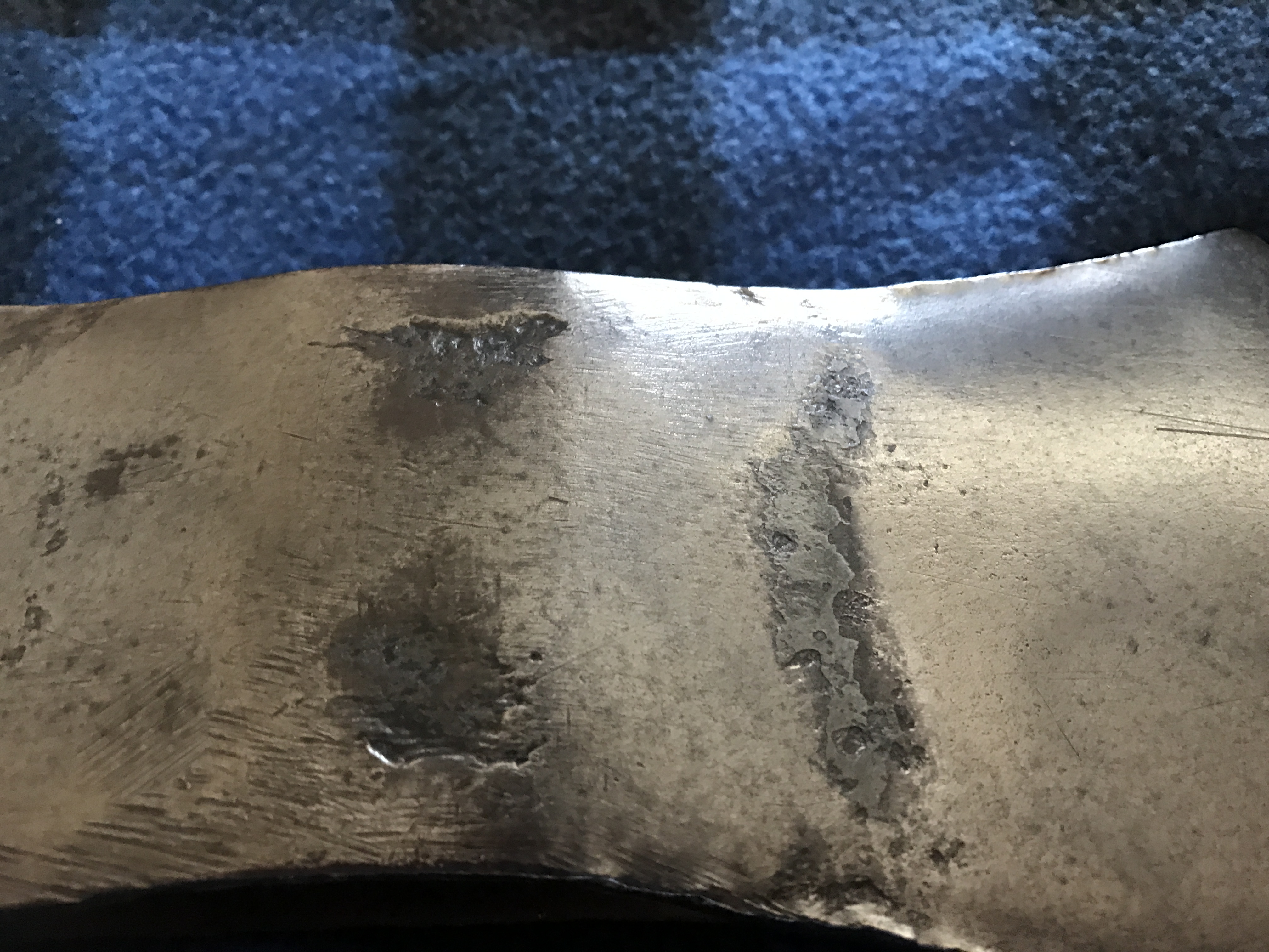

the eye appears tapered and i don't know what those splotchy spots are, they're not welds but maybe some filling of sorts. worth the 65$?
Based on the prices the vintage SAW single bit is selling on ebay these days, the price is quite good. Enjoy the tool
Those big splotches are pitting from rust, looks like spots where rust started and allowed to continue until being cleaned up recently.
I think it's more a case of surface grinding/finishing that didn't fully remove the scale from mass production forging. By the 1980s all axe makers were desperately trying to cut every corner they could to reduce the amount (and cost) of human labour. A mere few years later the Swedes entirely threw in the towel on previously-standard 'glossy smooth' commercial finishing and said 'because this is hand-made what you see is what you get'.
I could see that. It's a little hard to tell from the photos, but Either way a good tool.
