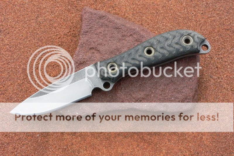

Just got back from a vaction on Prince Edward Island, Canada. Took the AD along as a EDC. Everyone who saw it fell in love with it immediately and commented on how sturdy yet "right sized" it was. It saw lots of salt water exposure and the only care it got was rinsing under tap water. It still hasn't shown even the slightest hint of rust. It's great for shucking Malpeque oysters. BTW it's a stripped blade.

It looks MUCH better with the coating removed:thumbup:

Grab some paint stripper like "circa 1850" smear it on with a paint brush. Wait a bit, wipe it off. Use a steel brush to remove any left over in the Infi dimples and you're done. Don't even think about removing the handle slabs unless you intend to mirror polish the blade. Looks good stripped huh? Still see the Busse logo.

Paint stripper does not hurt micarta:

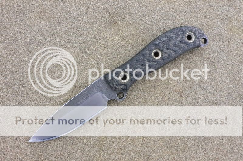

New... (Skunk's pic... but one just like it)
Soaking in stripper...
Freshly stripped...
Well loved and used...

well mines soaking, i brushed on and waited for time and it didnt work, so soaking for the time which makes it double the time. wish me luck this time around, will post pics here soon
ok, cant see the busse combat on mine at all. and it seams some color (read not finish) stuck to the ground section of the blade. maybe i'll do a light coat on the section that retained the color. any ideas why mine dosent have the busse combat anymore? i didnt scrub that portion only rubbed off. come to think of it, i was so stoked i didnt inspect that closely, though i assume it was there.
