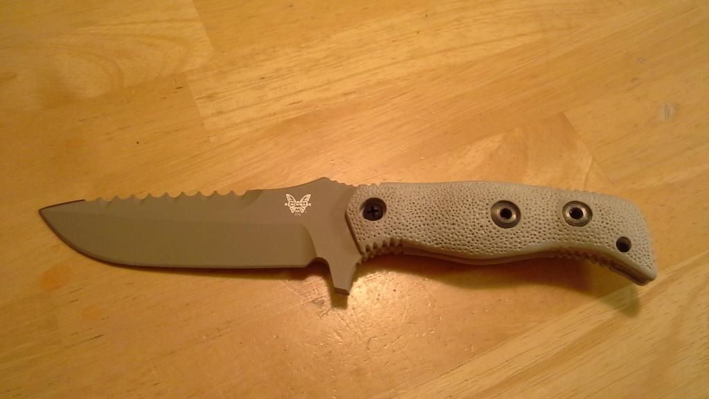

Here are some photos of my home made knife handle scales. I purchased some G10 blanks and used a dremel to craft the scales. Spent roughly 6hrs on them, they're not perfect but they will do for now. Comments and opinions would be great, hoping I wasnt the only one who wished Benchmade would have done more than just paracord on these blades.http://i44.photobucket.com/albums/f38/moonCricket1/Mobile Uploads/20140819_2105311_zps416ad790.jpg
http://i44.photobucket.com/albums/f38/moonCricket1/Mobile Uploads/20140816_100231_zpse333b090.jpg
http://i44.photobucket.com/albums/f38/moonCricket1/Mobile Uploads/20140819_210451_zpsfbca9295.jpg
Thank you, I went with a desert tan G10 from (usaknifemaker.com) . It didnt exactly match the coating on the knife but it seems the G10 is darkening with more hand oil absorbing into the handle. It's worth the time and money spent if you have the tools available. The blank G10 only cost me twelve bucks, I know there are plenty of guys doing home made Micarta like scales too but I have not seen anyone do this yet with the 375.
Those look great! They look like benchmade should make them come standard. Very nice job sir.
I recently asked if there was anyone out there making scales fro this knife because I don't like cord wrap, so it's nice to see that I'm not the only one with the idea. I bought a chunk of black wood and planned on making some scales eventually for mine. What did you use for fasteners? Brad
Brad, for fastners I went out and bought 3/4" 8-32 flat head screws. I actually used some of the hardware that came with the Adamas knife. But you can use something like rivet nuts since they have a shoulder that will lock into the actual handle itself. Just be sure to take your time on drilling holes for the scales since the hardest part is lining them up. I offset the holes so they would hold the handles in place rather than center them in the holes on the blade handle, or you can use an epoxy to lock them into place.

Thank you sir, I was some what satisfied with the end result. If I could've picked another color it would probably be olive drab.

Micarta would be nice, preferably a linen. I've seen guys make Micarta style scales out of khakis to be used as something close to a sand color, it can be done for a low cost, you just need to have a decent sized vice or clamps and some fiberglass resin/marine epoxy. I agree it's definitely a knife to beat on and I didnt spend too much on it so I wont feel bad putting it through an assortment of camping chores.
