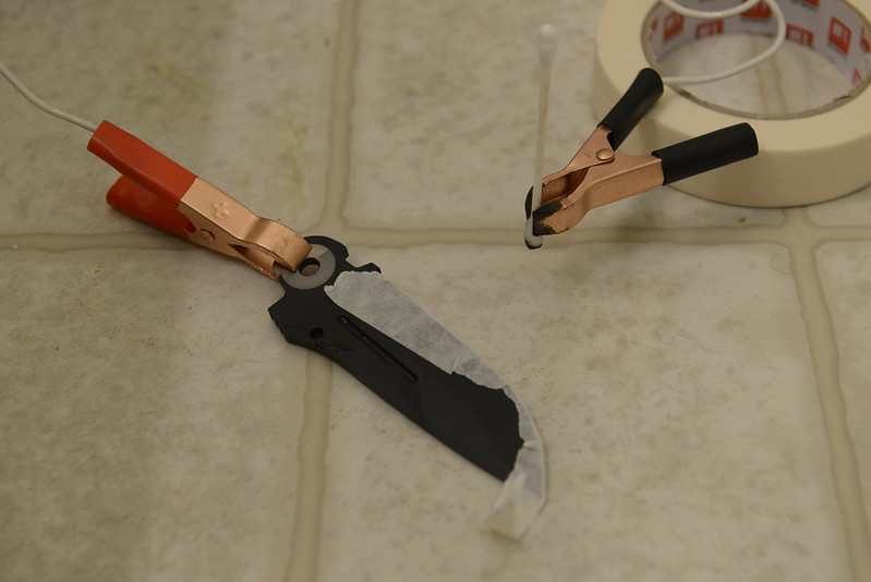

I fixed that to some degree by making stronger Omega springs and used the opportunity to mod he blade a little bit.
Following are the pictures with some brief explanations. Please feel free to suggest any more improvements or ask any questions.
Thank you.

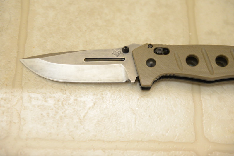

Original Blade

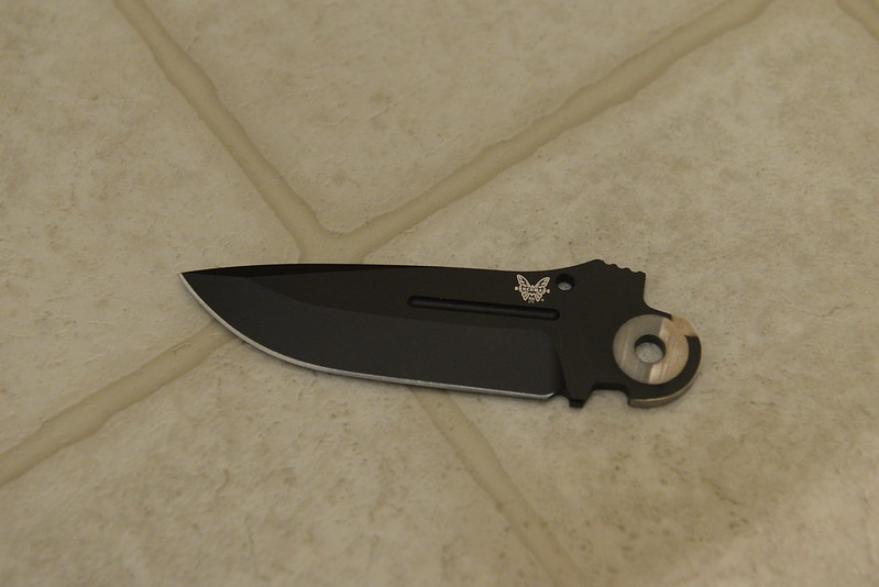

I etched the laser engraved butterfly and letters using DC and then blackened the deepened patterns with AC
The result was black patterns in a black blade

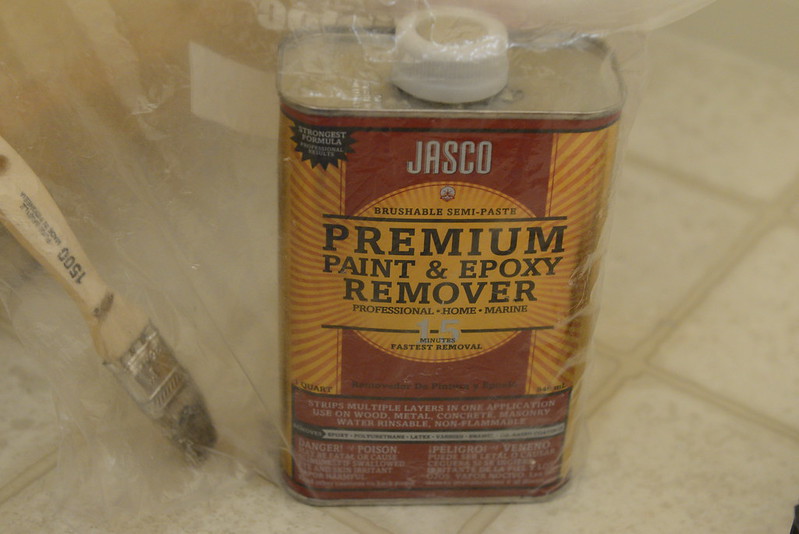

Now I removed the black coating with this paint stripper from Home Despot. Either I got a really old one or this particular brand is not very good. Even on other knives it took much longer than what other people can do with the spray version.
While stripping my BK-9 for example was hard, the Adamas was even worse. I guess Benchmades coating is just better. It took me 6 applications of the stripper for 3 hours each. (the instructions said 1x15 minutes...) In addition it needed lots of scraping with an exacto knife and rubbing steel wool over it. Still not enough!. At the end I was left with many large spots which could not be removed. It almost looked like it was bonded to the metal on a molecular level like some Anodization. I know it wasn't but that's how it behaved and looked. I took another 2 hours with a dremel and a wire brush wheel.

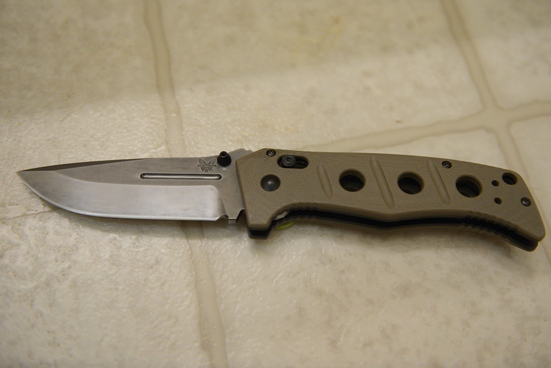

The result is as follows. Non black blade which I prefer for food prep and black etched patterns.

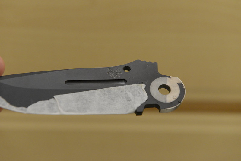

In addition I wanted to make the grooves black to make my Adamas look more refined by having the groove color matching the colors of screws and pocket clip.
I taped the whole blade and cut out the grooves from the tape with an exacto knife and used AC to introduce black oxidation.
Here you can see the part I am most proud of.

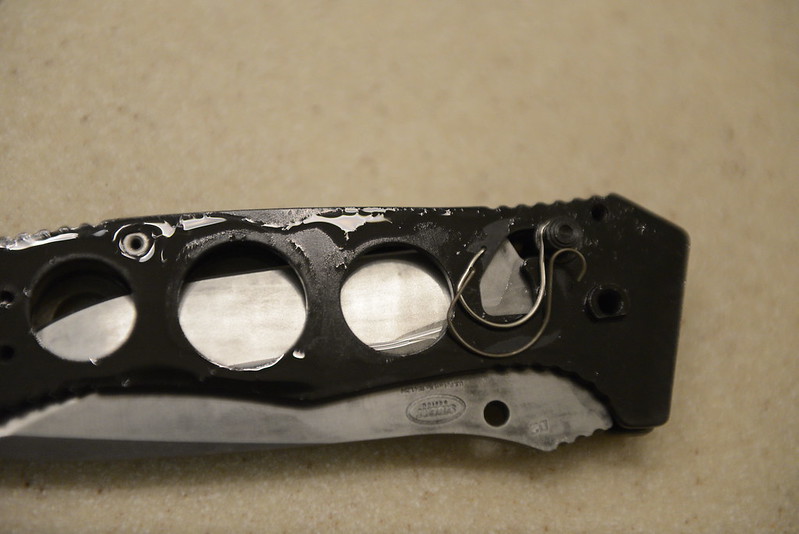

I planned to make stronger Omega springs to increase blade retention and prevent another disaster like this http://www.bladeforums.com/forums/showthread.php/1143331-Tip-Up-Disaster-(graphic-content)
Initially I planned to use guitar wire. But Rainforest would take 2 days to ship and I couldn't wait and found a cheap thin key-ring which came for free with my car keys. It was the max size wire (0.033 inch) which could fit into the frame hole and turned out twice as strong as the original spring. (Guitar Wire came yesterday and the thickest available is only as strong and thick as the original spring with 0.026 inch). Maybe that is what Benchmade is using in the real deal?
This is a photo of the spring which I bend in 5 minutes with the original lying on top of it. You can also see that the Sibert sign isn't as black anymore. That happened because the original paint was so strong and paint stripper was not enough and I had to use a wire brush wheel to finish cleaning the blade.

Nice job, looks great with the satin blade.
As for the omega springs, how much harder/stiffer is the lock to operate? I have some of the exact key rings you used so I guess ill be taking them off the spare key thing and putting them in the spare knife parts drawer.
I believe the "paint" is actually Cerakote so it's no wonder it was hard to remove, it's designed to be especially chemical resistant.

The new springs are twice as strong as the original. They are still easy to operate and don't lock up. The originals feel more high end and it's more fun to play with them. I would have kept them if they would have provided a bit more blade retention.
Side note: good thing about the key ring spring is that the big bend is already in there and all I needed to do is make the small bend around the axis and the tiny hook which goes into the steel frame. So basically very cheap and almost no work. Why not give it a try :)

Also, about the new springs you made, just how durable do you think they would end up being? Wont that type of metal break after flexing repeatedly?
I didn't take more pictures during this etching but luckily I made a more detailed tutorial with more pictures a few months ago http://www.bladeforums.com/forums/showthread.php/1130635-Kukri-Etching-Walk-Through-w-pics
Etching the Benchmade Symbols was much easier because the black paint isolates from electricity and the symbols are blank metal and conduct the DC (very very shallow laser etched by BM) So all you need is to apply the DC current like in the link. No need for taping the blade and cutting out any patterns (unless you want to add some off your own design)
I still taped the edge since its also conducting and once my electrode touched an edge of a knife and it sparked and melted a tiny chip off the edge :eek:

The spring's shape developed by Benchmade is great. Since the curved metal is much longer than the length the Axis travels no part of the spring does get bend very much. It feels like it would last for a very long time. I was playing a lot with mine and its not getting any weaker yet. I heard of some original Omega springs breaking but it seems to be only a very few incidences. I think that my thicker and stronger spring will last longer but only time will tell. Of course I could take original and mine and bend them like crazy to see which one gives up first but I am hesitant since I am happy with how it works now. :D
