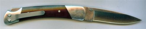

Here's a Ti clip that STR put on my Buck 501.
