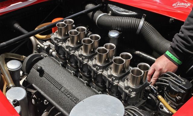

What is it about guys, at least us old guys, that loves wrinkle finish paint ? Like on an old microscope or other scientific like instrument.
The valve covers on this engine are wrinkle finish.
