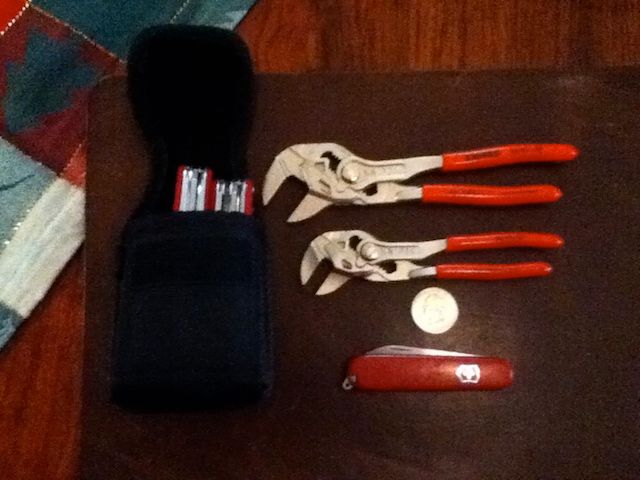

I realize it may be over reacting but I always take the clip off to tune it. Especially if it is a nonmetal scale knife. I just feel better about not over stressing the screw threads and I am able to shape the tip of the clip where the pocket begins to enter the clip. I tend to make the space between the tip and the knife side wider here but I also tend to then bend the tip down/in so that it is pretty much parallel to the side of the knife rather than sticking out which can scratch furniture or snag on stuff. I am pretty good at metal work so visualizing what I need to do and measuring my progress one way or another is second nature for me.
I use these parallel jaw pliers and if the clip is a nice one I put painter's tape on the jaws. I also have vises with aluminum jaws that prevent scratching steel work when clamped in the aluminum jaws.
