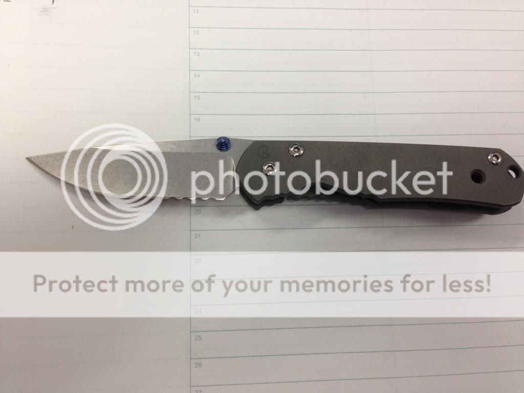

Hello CRK Family,
I realize there are likely some tips, suggestions, tutorials, or otherwise on this subject somewhere in the annals of the CRK forum; however, I will take this opportunity to not only ask a question, but to show some CRK Reg beauty as well.

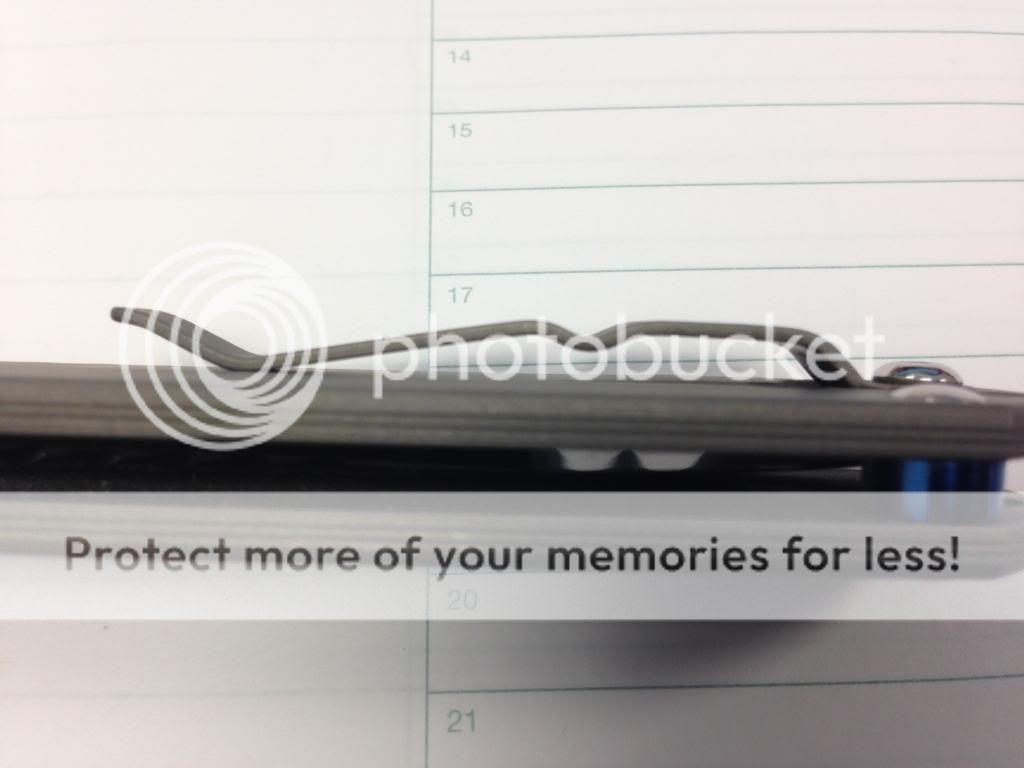

I recently traded into this lovely serrated small Reg and have found that the pocket clip tension is a tad on the weak side. It will still grab, but not as tight as I like. Also, the clip is a little further away from the body than other CRK's I have which makes the secondary hump not grab at all. The screw is tight so I think the bend may be off just a little than what I am used to.
I am asking for some step-by-step tutorials on how I may be able to adjust the clip without damaging it. I look forward to your replies!
Here is the subject:
Take it off, put a pair of pliers on the flat where the screw goes (with a cloth or something to protect it), and bent it down. That's how i've done mine. It doesn't take a lot i would adjust it and put it on, then see how it is.

Sounds simple enough! Do I need to worry about the clip losing its "spring?" I would guess not considering how many times the lockbar gets moved back and forth.
Wrap painters tape around the clip. Use channel locks or vise grips and hold the flat area where the screw goes. Use other pliers on the next flat section and bend it down. Cheers!
You can just bend it with your hands, I have done it many times. You can go as crazy as you like though, even clamp it in a velvet covered, soft jaw vice and bend it with a specific load torque wrench if you want. :p:thumbup:

He wanted to adjust his pocket clip. What would you do if you snagged it on something? I think even the least mechanically inclined person can bend a pocket clip to their liking....

You can also adjust the tension by just turning the clip 180 and keeping it on the handle to bend it. :)
Just employed this technique with my large plain Classic Sebenza....worked like a charm. Thanks for a great tip! :thumbup:
This works FAMOUSLY! I just tried this suggestion as I was sitting down to a bowl of froot loops for a midnight snack! 1 minute later I have a tight pocket clip! Thanks Haze!

One thing that makes me a little sad though folks... All these posts and yet not one comment on my beautiful Reg? Haha!
