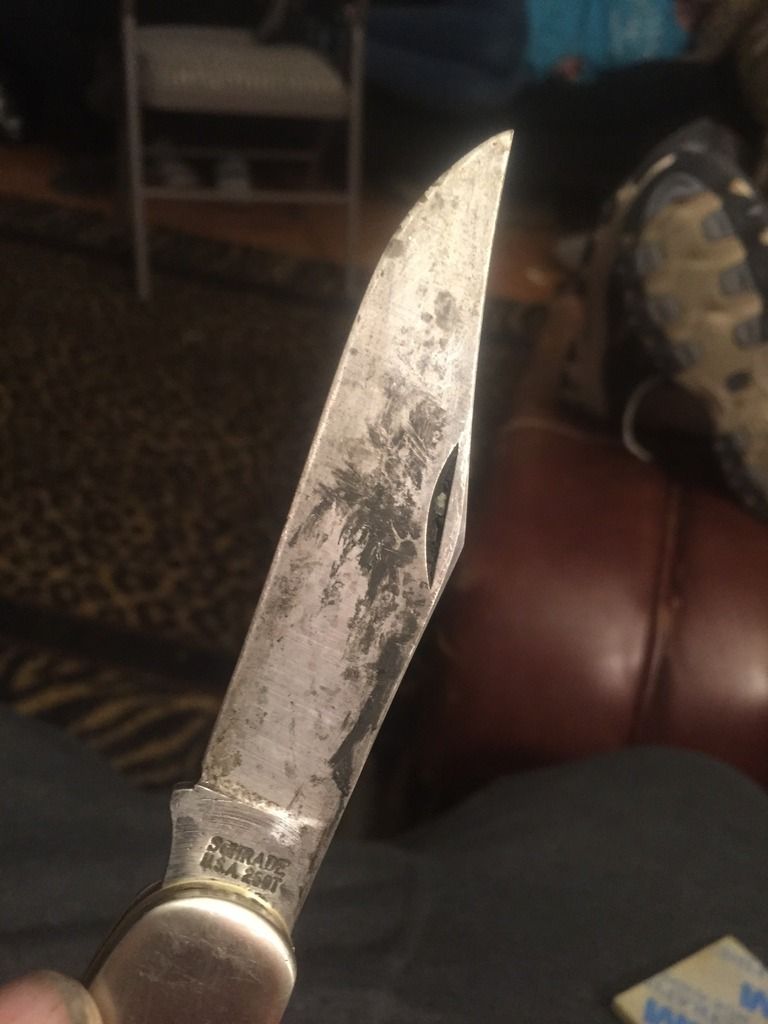

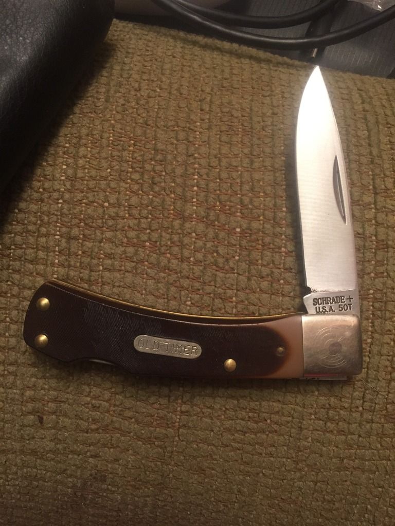

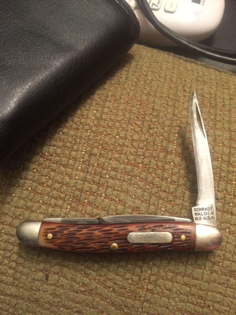

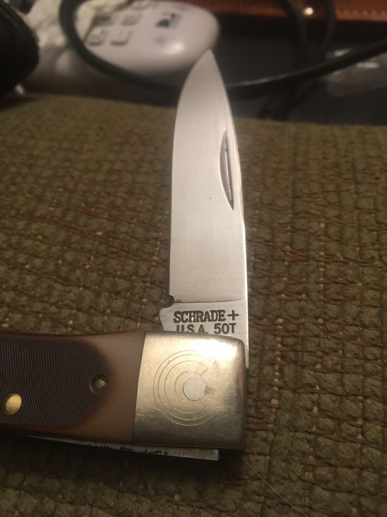

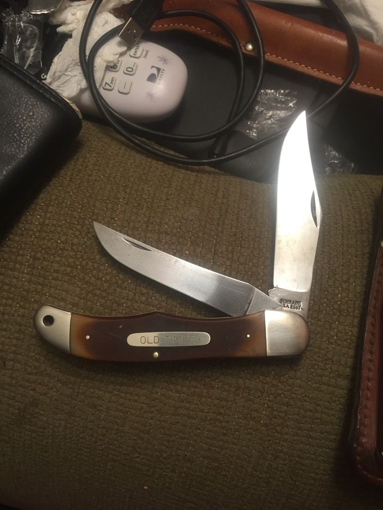

Well I went pawn jumping and found 3 homeless schrade, the 25ot was ugly but little elbow grease and she looks real good, 5ot has a C on the bolster can someone tell me way, and this little schrade welden 855 in very used shape but I didn't have one like it so I brought it home any ideas on how old it is.
Nice looking knives after the cleanup. The "C" is a company logo. Not sure of the company.
Those all look great in different ways.
I would buff that 'C' logo of of the bolster on the 5OT of it were mine.
