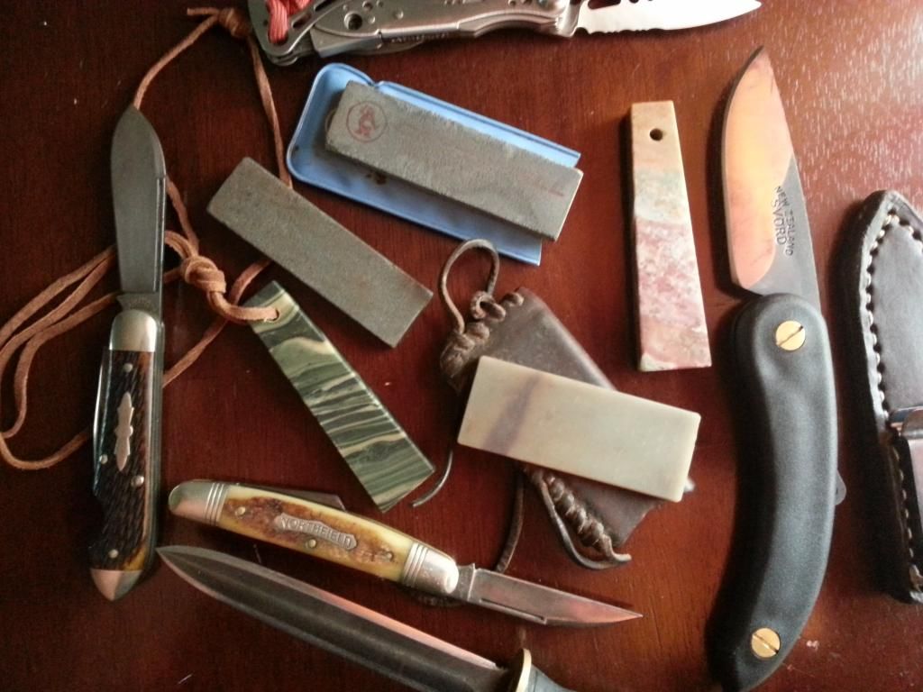

Just a self observation I made recently; by having a light stone on the left hand and knife on the right I'm able to create unbeliavably gentle pressure. With small 900-1000 grit white 4$ Ceramic rod I am able to create extremely crisp and keen edges on my knives, thanks to the attained low pressure. I have done this with a 12" carbon steel leuku, which is quite a trick with a 3 1/2" ceramic rod.
Do you often use small stones? Even if you are home with your bench stones?

I'm convinced in the truth of this. My own habits were formed around using small hones held like this (I started with a Spyderco DoubleStuff). I've made very good use of my DMT 'credit card' hones in recent months. Everyone eventually trains their hands to a given method, and when the feel develops for it, good or great results can be had. I still tend to use hones this way, all the way up to 6" - 8" 'bench' hones, in spite of not actually using them on the bench (most of the time).
I also believe the 'feedback' from the blade-on-hone is better (for me), when I'm feeling small variations in angle with both hands from opposite sides, and simultaneously making adjustments in the same manner.
The one time I might be more inclined to use a hone on the bench, is when there's some very heavy grinding to do on a large blade. Those tasks are better-suited to 'leaning into it' a little more, and the bench-backed hone makes that easier, and the hands don't get as fatigued.
BTW, my most recent sharpening gear purchase was a 3" x 7/8" AlOx pocket stone at Sears (for a whopping $2.50), if that sheds any light on my own preferences and tendencies. :D

I will buy into this theory as well when it comes to simple sharpening and touch ups. I more frequently use a small pocket stone and strop than I do their larger counterparts and the combination of increased muscle memory, feedback sensitivity and light touch used with the smaller sharpeners make me more efficient at producing a fine edge.
I started with some of the small DMT Aligners stones using them with the Aligner and free hand, than eventually moved to the 6in and 8in norton economy stones (silicon carbide and aluminum oxide). Small stones work but I find a 6in stone just feels natural to me.

I have really come to appreciate small stones. Especially the beautiful natural stones used for honing, but the more coarse artificial stones are very useful as well.
I think their best feature is that they can be tucked and stored just about anywhere, making the occasional sharpening task much less of a process. Especially if you are on the go, you can just slip one in your pocket. All of my larger stones are stored in a tool box with leather, sand paper, flitz, diamond spray, and all of that kind of stuff. That tool box only comes out when I am doing a serious amount of sharpening. Otherwise, the little stones are more convenient. I keep one by the computer for sharpening during long bladeforums sessions.:D
