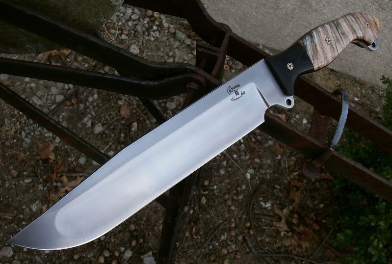

I have a few pieces of INFI (SAR 5, CABS, BS CG, Wardog) and just picked up a used Rodent Solution. After using it this weekend I believe it will replace the CABS as my go to hunting knife. I have a few questions on grinds as I also have some Mora's and find them incredibly sharp.
1. What grind did the RS originally come with?
2. Is there an advantage to changing to a Scandi grind?
3. Is the Scandi easy to sharpen?
4. Will my Work Sharp grinder sharpen this easily ( I am seriously challenged)
5. Will changing the grind put the SR101 at risk of becoming weaker at the tip?
6. Should I Scandi grind my RS and will it make it a better slicer than the factory grind?
I am a very hard user on a knife from cleaning at least 10 hogs a year, numerous deer, cutting feed sacks, hay bale twine on the bale, spine as a screwdriver when needed, digging out fence staples (how I broke the tip of my KOA)to stripping wire. Looking for answers and all opinions welcome.
If I do make the change I am sending it to a professional.
1.) I believe its a full flat grind with a v edge.
2.) Not really, you will possible give up edge durablity and it can be difficult to resharpen though I can see why you would want to do that as the RS is thick at the edge.
3.) It requires a lot of metal remove every time you sharpen it, not hard if you have a coarse stone, but a full flat is easier to touch up.
4.) Yes, it will sharpen but the work sharp will produce a better convex edge then a scandi. Take care not to burn the knife, keep it very cool.
5.) Possibly, but its a tank of a knife.
6.) Better then factor yes, but there are far better edges you could put on the knife. I would just thin out the shoulder of the edge, a lot, until you get the desired sharpness you want.
Scandi grind's biggest advantage for me is ease of sharpening. I can make that bit*h sing when my hands are numb in the dark. I have a customized noe that is getting a scandi grind as we speak.
I think the major advantage of a Scandi grind is to the manufacturer/maker. They're quick and easy to do. You just need a little practice on your FFG V-Edge, IMO it's superior to a Scandi already. :)

I don't know what grind the Rodent Solution came with, but I'm sure it was either a full flat, high flat, full convex or high convex as those are the standards for most busse kin knives of that size.
Choosing a geometry is mutifaceted. A simple guide for what you should be looking for as far as edges go can be this: 'absolute minimum to resist damage, thus maximum for cutting performance' (which I'm actually paraphrasing from Cliff Stamp). If you add metal to a knife to increase weight for chopping it should be at the spine, not at the edge. Busse kin knives tend to put overly thick edges on anything thats expected to see a chopping, prying or batoning, especially on knives like the tank buster. Heres an example of a bad geometry (for general use as apposed to breaking apart concrete) vs. a good geometry (for general use and cutting/slicing) from busse combat:

So... should you make the high flat/high convex of the roden solution into a scandi grind? not on a hard user. Scandi grinds have zero edges that are much thinner than most flat grinds because it's "zero" edge, you have a perfect triangle instead of a triangle where the point is made more obtuse by a secondary bevel. Even with a microbevel, it'll still be thinner than normal. If you really want to increase slicing ability while maintaining strength for digging out staples you should keep the grind as it is, just thin it down so the edge thickness is thinner - but leave the tip and forward curve alone. That means you'll have a thinner full flat or thinner full convex for slicing on the main edge but with a thicker tip for taking damage when prying.

I hit the local "knif shop" today and he had hte same opinion - no scandi and it will be difficult for me to sharpen myself. Did get a free sharpening though on my RS, War Dog, and KOA Caper. Busse's are at 20 degrees convex and the KOA Caper at 17 degrees.
