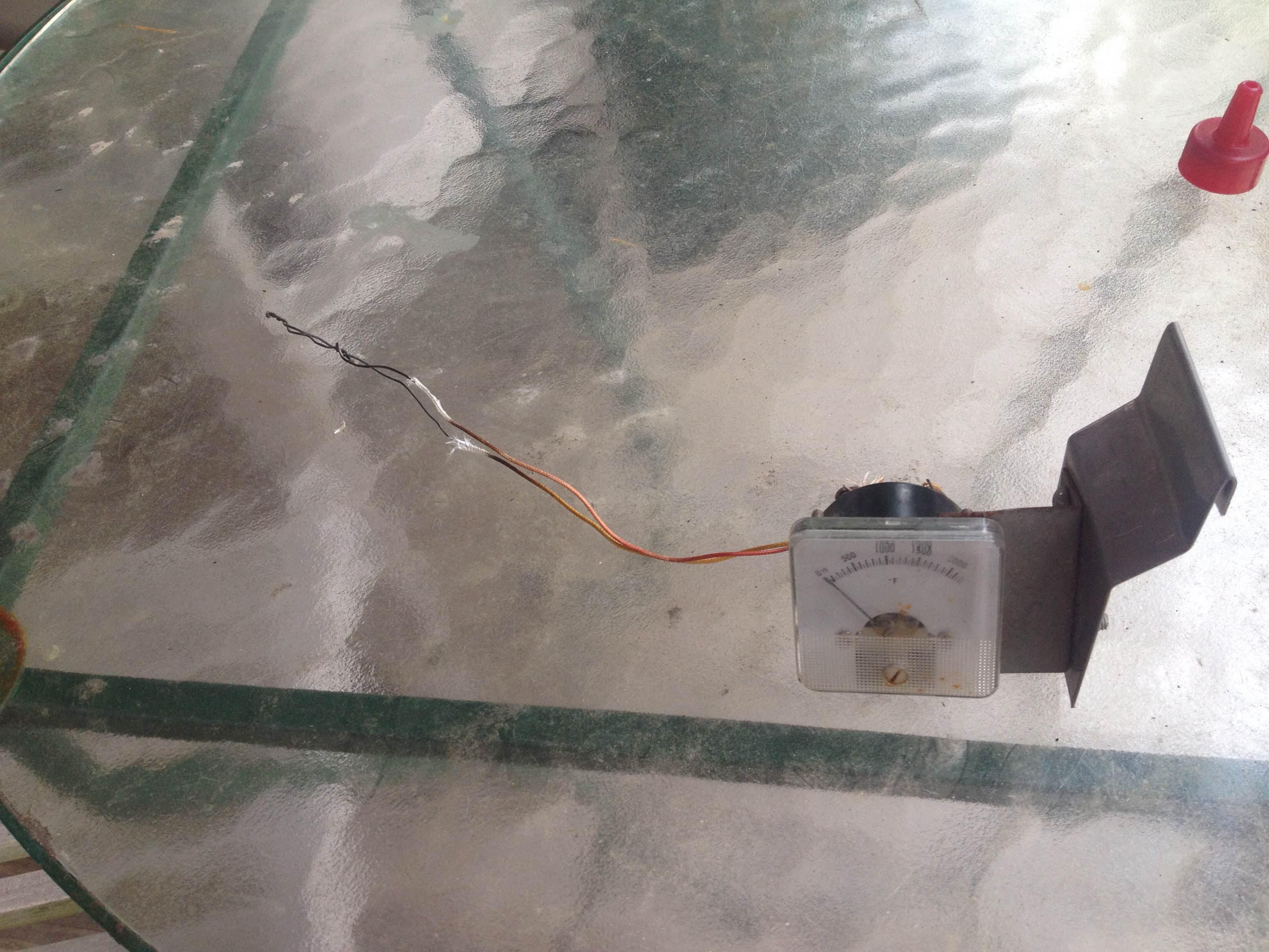

I wonder why the TC died? They last a long time normally. Can you post a photo of the TC you used? It should be 8 gauge type K for best life.

Here's the TC.
I got all the parts from a glassblower, so I trusted that everything would work with the necessary temperatures. He actually gave me a 220 element, but the only outlet I have for it is outside. The 115 element is pretty much new, so I'm not too worried about it (or I'm just being stubborn).
That TC isn't really what you want for a HT oven. It will work, but is very light duty for something that will sit at 1500°F for long time. An 8 gauge Type K TC and reading unit would be far better.
Once a heating element gets fired, it becomes hardened. Any subsequent movement or bending can easily break it. Even if you got it re-installed in one piece, it would likely fail soon.
I ordered a heavier duty type K and digital readout that should arrive today. IIRC, the source on bending elements said to heat them with a torch to make them pliable. I think I'll try it, only because I'd be ordering a new element anyway. I appreciate the help, as always.
