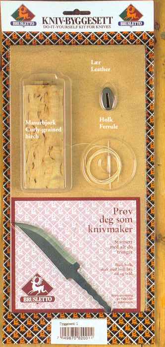

For a while Ive been lookin at doing a bit of knifemaking, just dont know where to start. Im not sure how serious I want to get into it since im at school and dont really have ready acess to a shop, but I have seen blades and kits on places like Texas Knifemakers Supply. Im going home at Xmas for a few weeks and might find myself in need of a project or two to keep myself busy, but as we have no forge at home (rats) thought that a kit like that might be good experience for getting into this sort of thing. Figured I'd ask a couple of folks with more wisdom than I in such matters if this might be a good way for a knifemakin noob like myself to get his foot in the door.

I heartily recommend you check out www.ragweedforge.com for a number of reasons. Blades, fittings, kits, even helpful instructional articles about how to mount a knife handle or make your own sheath, it's all right there. The products are top quality, the prices very reasonable, and the service fast, friendly, and dependable.
Here's a sample of the kits (this one's my favorite)
If you do decide to order some stuff from Ragweed Forge, tell ol' Ragnar that Robert of Yorkshire sent you, that'll make him grin. :D He's an old friend, a good man, and I have no shame at all in sending business his way.

This is great stuff. I had nevere found the blades and kits at that site. Thanks Sarge.

They are far too rare in the part of the world and the most useful, attractive knives you will ever see. 'Ragweed forge' is a good resource as is 'Thompson Knife Supply' and www.brisa.fi
