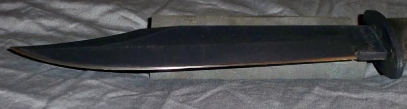

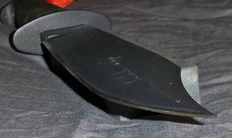

So today I picked up one of those Smith's precision two stone sharpening systems, with the diamond sharpener, arkansas stone, sharpening compound, and two angle adjustable clamp. I figured having some sort of locking guide system would do a lot better than trying to freehand it. And from what I've heard from others here, diamond stones are supposed to aggressively remove steel with moderate pressure.
Well that didn't happen. Barely anything got removed regardless of how much I tried. This precision sharpener didn't do a bit of good at putting a 20 degree bevel to the edge.

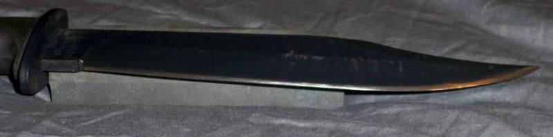

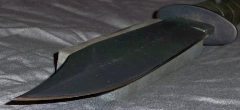

So this is the result of my efforts at reprofiling the factory edge. I don't know if I made it better or made it worse.
Charlie, You have to use a coarse stone. What was the grit rating of the diamond stone? You at least tried and that's something way better than not trying. There is now a chance you'll move into learning. DM

I don't know what the grit rating is, the instruction didn't say. All it said was that it's a coarse diamond sharpener meant for aggressive work.

I actually bought a sharpener to use. Smith's two stone sharpening system, with a clamping mount that goes right onto the blade, and provides slots for 20 and 25 degree edges, along with guide rods to keep the stones straight and level.
What I'm wondering now is if I should approach this gradually over the course of several days. Maybe so many passes a day, gradually reshaping the bevel until I get the desired results, rather than trying to get everything done in the course of a few hours.
