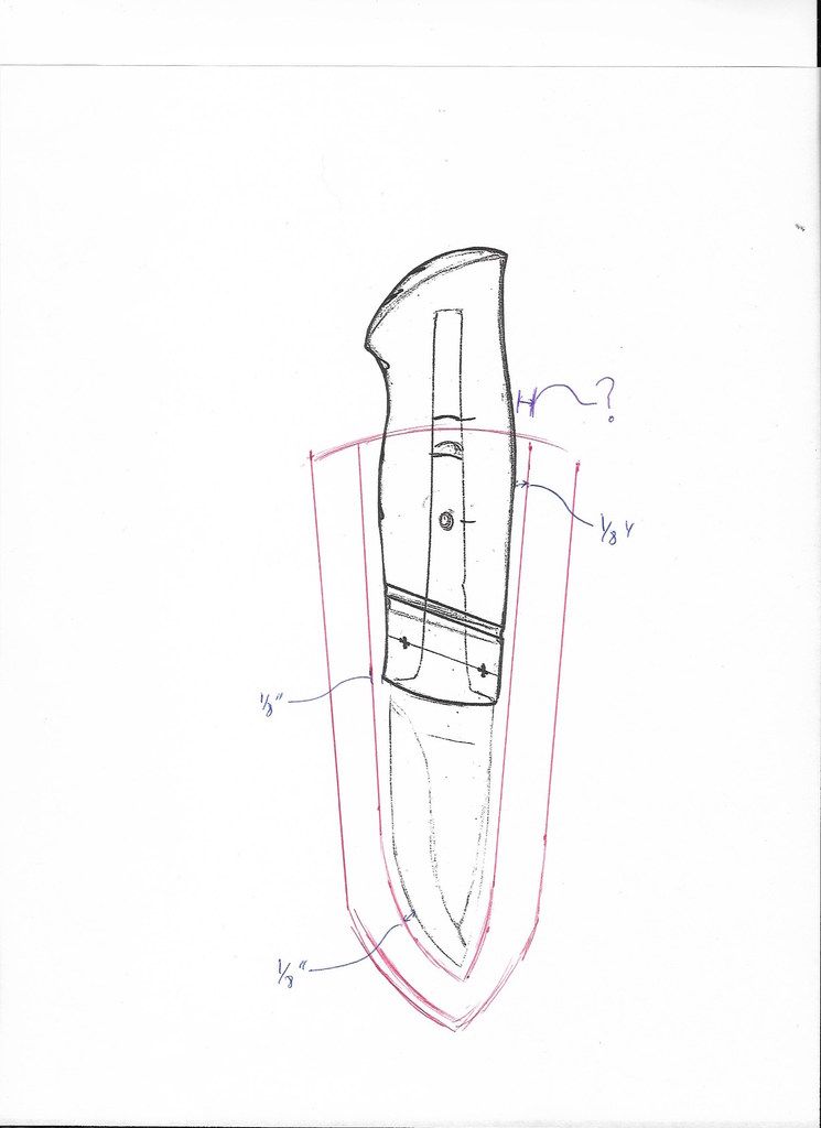

In any case though I am still a little unsure about the welt design. In my head I would do the following.
1. Trace an outline of the knife in its side.
2. Make an 1/8th in margin around the blade it self.
3. I would find the widest part of the handle moving away from the blade (For this sheath I am assuming i would do it on both the belly and spine of the handle.)
4. At the widest locations, make a mark 1/8" away from the outline of the knife.
5. Connect the lines with a ruler.
As you can see below in most cases this will leave you with gap larger than 1/8" but in my experience,one that will most likely require a wedge (is not several) no matter how thin the handle is.
Most of my handles run ~3/4" thick at the widest part that would be in the sheath and I was wondering if there is a rule of thumb with the spacing of the welt from the knife handle at the mouth of the sheath (see the "?" in the attached) I could use to get a tight fit without needing to add too many wedges.
Is it as simple as say using the dividing the 5/8-3/4 approximation used to make the butterfly style pouch sheath in half and using that as the spacing at the mouth?
[URL=http://s46.photobucket.com/user/Groy87/media/WIP%20and%20Shop%20Pics/Scan%2025_zps9hwph3im.jpeg.html][/URL]
On your illustration I would move the mouth width out to about 3/8" maybe a little more while keeping the 1/8" on down closer to the end of the knife. This could result in a slight curve about mid sheath. You will probably still need a single thickness wedge on each side down about 2".
Paul
Paul
Thank you sir. Just to clarify your are advising at the point where the blade meets the bolster, adjust the angle of the welt outwards to increase the width of the mouth resulting in an hourglass type profile? Or are you advising to move welt outwards at the bolster are parallel to the current lines, resulting in a fatter shield profile?
From the bolster to the tip I would leave pretty much as it is and with a curve as opposed an angle I would widen the sheath from that point up. The curve would tend to make the transition look less outstanding than an angle. The interior line of the welt can retain the angle, it won't make a bit of difference there.

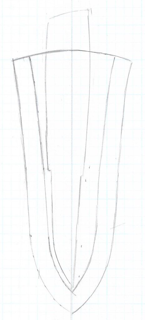

Something like this?
[URL=http://s46.photobucket.com/user/Groy87/media/WIP%20and%20Shop%20Pics/scan26_zpsyi3xkcvd.jpeg.html][/URL]
On the spine side of the blade the welt can be more than the 1/2" and can follow the blade shape more (on the interior). This will help to increase retention value inside the sheath. Doing this does not affect the exterior lines (profile) of the sheath. This action will, however, create a dedicated left or right hand sheath. The knife can only be inserted one way.
Paul
Paul
