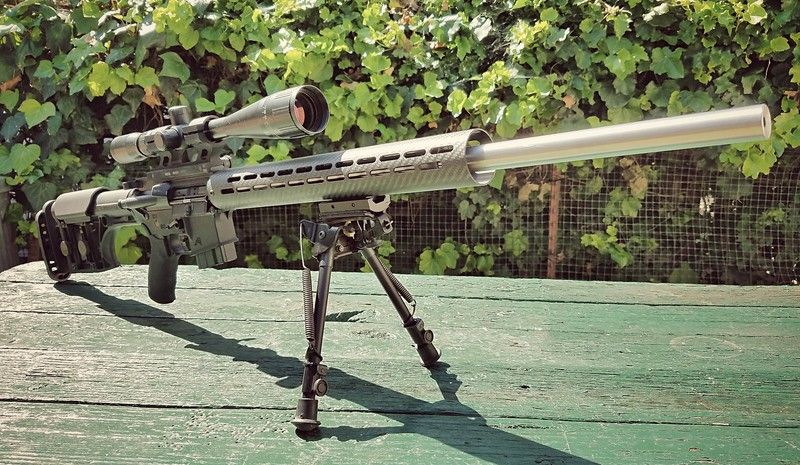

And when you're ready, you can build a full custom long range competition rig like this...

Hell yeah. I can't wait to get a long range rifle. I want something in semi which would be an AR, as well as a nice precision bolt gun. For the bolt gun I'm thinking 6.5 creedmoor definitely..... For the AR if I stick with 5.56 I can just get an upper and swap it on to my existing lower. I really want to do some long range shooting, it's super fun. Around here to get past 100 yards I'd have to drive over an hour but it's worth it. But even then it's nothing crazy.... maybe 300 yards. Not like out west.... those 1000 yard ranges and such. Damn that would be cool! Takes some real skill though!

I'm not a big fan of the 6.5 creedmoor, I like 6.5x47L and 6BR. Both hold many world and national records than the CM. 6br is economic to shoot with using little powder, but is a bit finicky to get to feed in a repeater. 6.5x47L is a bit more expensive up front for reloading, but brass lasts up to and over 20 reloads! My next project is a 6.5x47L, just finished a tactical/hunting rifle on a M1917 action in .30-'06 that is showing promise so far with factory ammo.
Back to AR's, for 300, I see no reason not to stick with 5.56. A 1:8 twist 20" barrel would be perfect with 69 or 75 grain bullets out to 500y.
