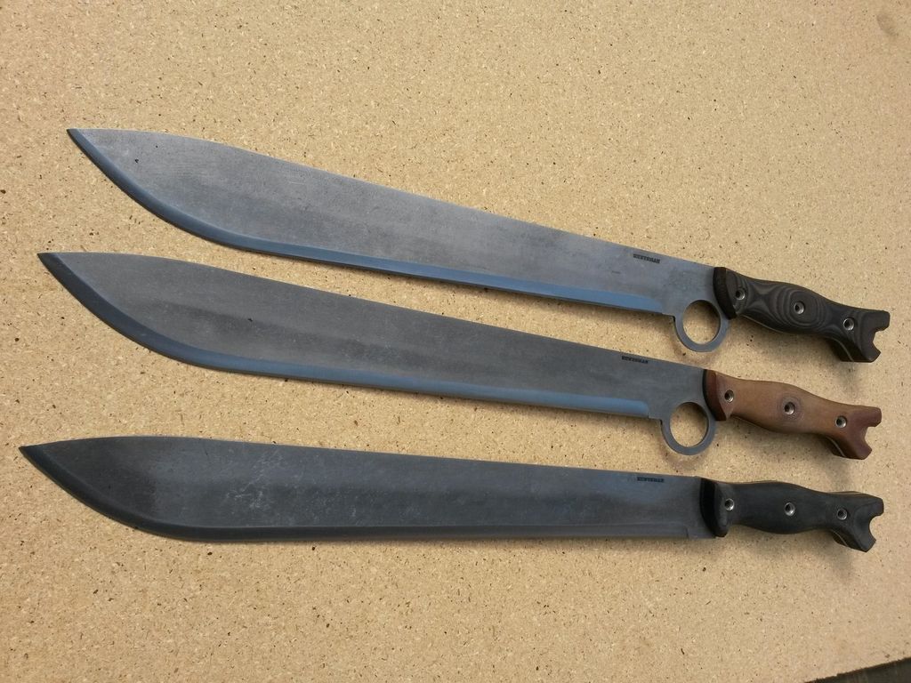

Unfortunately I'm out of them right now (working on getting another run done at the moment) but my Baryonyx Machete was designed with the North American temperate zones in mind.

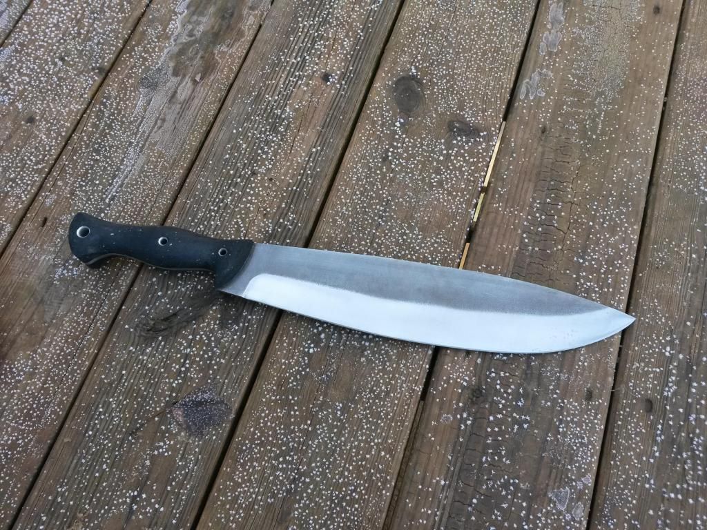

A slightly heavier-than original (1/4" or 5/16" to 3/16" distal tapered) JEST bolo pattern works pretty well-the one I made for my own use is a 9" blade, maybe 16" OAL.
This was it's twin:

The Baryonyx machete looks too big in the picture, but then I watched your video and the size was smaller than I expected. And the vegetation being chopped in the test, what I'm looking at is very similar. The Baryonyx looks like a great tool for what I need, so please tell the guys in South America to get grinding :)
