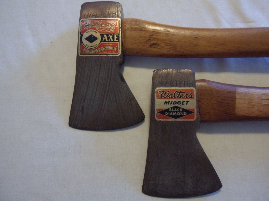

Here's a bunch more Walters hatchets. The Montreal pattern shown (mid 1950s?) is original including the paint on the head.

Sort of looks like these -
The hafts on these are thin, and tiny. Almost like you are holding nothing at all. They are 11.5 and 13.5 from eye to end. I thought they were more marketing than anything else due to there size, I am not sure what practical purpose they would hold. I guess some shaving or very light work.
I think they were meant to be boy's first axes 2-3 generations ago, to go with that first 22 Cooey single shot rifle and a Boy Scout kit. When you see them today they tend to be at the bottom of now-become-grandpa's tool kit or tackle box.
