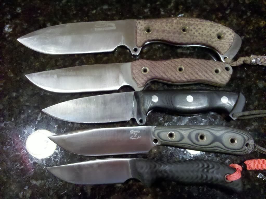

Here is what I did to a CS MUK handle - black paper micarta, started out real thick and ropey/chevron-ey with high raised and almost sharp edges that felt like you were holding a spiky pickle and took all nimbleness away from this knife, I bought a tan linen LE after I did all this, and should have gone there first. However, now I have 2! and the CS is actually noticeably smaller blade-wise, not a ton, yet noticeably...
