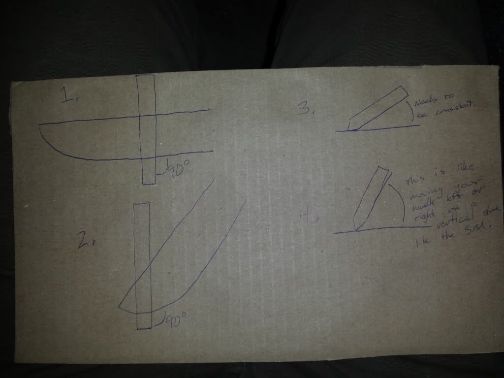

1 and two explain why you want to rotate the blade. 3 and 4 are why you don't really want to move your hand left or right. It will kinda do the same thing as rotating forward, but with little to no consistency because you lose your point of reference.
That lack of consistency is why freehand sharpening can be such a challenge, and the SM is designed the way it is: vertical stones so you can hold the blade plumb. Everybody has a natural ability to hold something straight up and down, but it's tough to hold something like a horizontal 17 degree angle. It can be done, but it takes practice. Hope that makes sense.

I'd really like to help you guys out, try out what I said, you will undoubtedly see some results. No more rotating left to right,and keep that edge at 90 degrees, rotate forward to keep it at 90 to accommodate the belly.
This is the best way to take advantage of the SM, there are other ways, but they take practice and don't make much use of the benefits of the SM.
