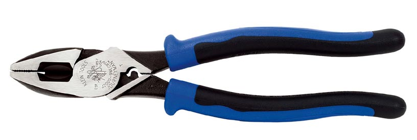

I would get a good pair of Klein linesman Pliers
Next I would get a 5 in 1 Klein Screwdriver (maybe even 10 in 1)
those are 2 tools I am never without.
You can get the pliers in "high leverage" which means
they put the center pivot closer to the front so you can
cut some really heavy duty wire.
I have cut chain link fence wire with mine in the past.
I have removed bolts/nuts with them as well.
makeshift tack hammer, etc etc...just a great tool.
Heavy,but well worth it in an urban environment.

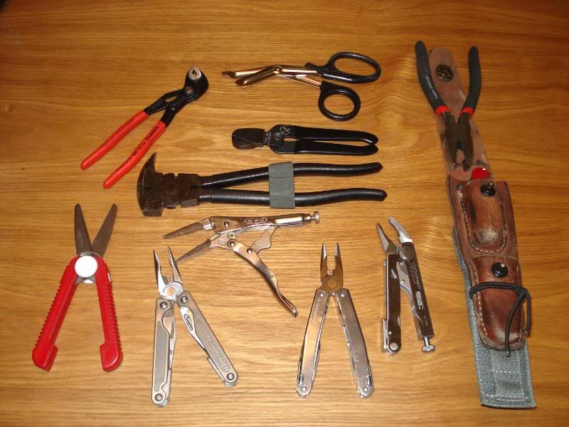

For pliers, I would look at a good 8" adjustable (my favorite is the Kniplex Cobra).
To combine both a hammer, pry bar and wire cutters...my vote goes to fencing pliers. If you still want a compact pry bar, Stanley makes some decent 8" sized ones that I have stashed in my bag.

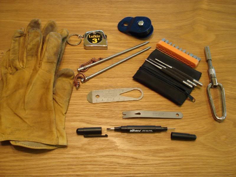

Here are a couple of things I carry in my 'works' bag which is pretty much always with me at work.
The Lenox saw has already been mentioned - a really useful piece of kit with a wrecking blade and a finer-tooth blade for metal.
My scrwedriver set is a Wera Kompakt 62; they do smaller sets though. It's a solid, quality set and sees a lot of use.
The leatherman's just for scale ;)

These can be solved with 2 multitools; one full sized, and one small. I'd go with SOG powerlock/assist, and something like a leatherman juice, or gerber clutch (or similar). both these multitools would weigh less than all the tools alone, and can be carried easier.
or check out a swiss-tech utili-key for a couple different size screwdrivers; then you could leave out a small multitool.

+1 on fencing pliers. Though I carry a Wave as well with the full driver set and some sort of SAK.
Sometimes (seems like quite often) one pair of pliers isn't enough

b) a pocket screwdriver -
-The best ones are the cheap advertising type you get from the tool truck. You can pick them up off ebay for about $2 a piece. You can destroy them as a prybar and not feel guilty.
