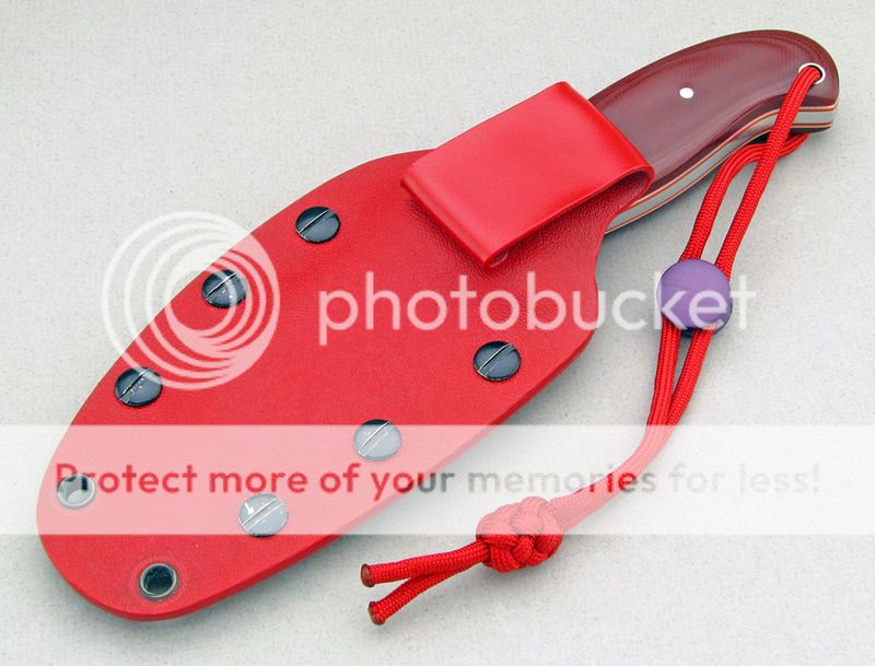

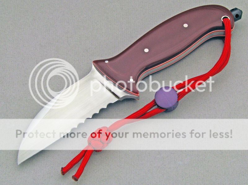

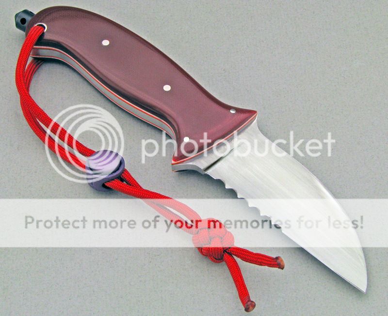

Greeting everyone,
My daughter joined the local volunteer Fire Department, so I made what I’m calling a Rescue Knife for her to use while on duty. I used AEB-L steel for the partially serrated blade, red G10 with orange and white liners for the handle, and titanium for the pins and thong tube. The edged portion of the blade is about 3.5 inches long. I’d call the blade shape a Wharncliffe, but perhaps it’s actually a Sheepsfoot (I’m not really sure of the difference).
This was my first go at serrating a blade, but I think they came out alright. They certainly breezed through the rope I tried them on. I also drilled and tapped the tang for the removable glass breaker.
The sheath is molded of EMT Red Kydex, which I got from KnifeKits.com.
that's pretty neat- I like it. Great purpose built tool, there
some grip tape might help keep it in the hand when it's wet or gloves are on
That glass breaker isn't very sharp .You should try it out on auto glass .My car tool is a large size automatic center punch but it has a much sharper point .How glass works is to scratch with a glass cutter then snap it . Give it a try.

Mete, I don't have a lathe, so I had to buy the glass breaker. I bought the one I did because it had an 8/32 thread, which was the largest I could get into the knife's tang. I wondered about it not being sharply pointed, but none of the tips I found were. In fact, some of them had ball ends, as you can see in the photos below. I don't think anyone will volunteer their car windows to test it out, so I'll have to wait until my daughter gets a chance to try it in training or at a crash. I know that when I was a Police Officer, our old captain had the bright idea to equip our cruisers with Life Hammers, and the tips on those were pointy as heck. I never saw anyone use one on a window, but they sure made a mess of the steering wheels and aluminum dash that the bored cops kept tapping on them.[FONT=&amp][/FONT]
Rolf, I thought long and hard about putting a chisel point on the blade, but in the end I decided against it. I even have a piece of L-6 that I was going to use for the knife. However, it seems to me that, unless you have the chisel tip at 90 degrees to the bade, it's not going to be very useful for prying. And, if you do make it a 90 degree angle, then the tip won't be any good for penetration. Also, a 61 Rc stainless blade with a relatively thin edge probably won't hold up well to prying in the first place. On top of all that, she's working for a Fire Department, which has all kind of prying and chopping tools in their vehicles, which are usually only a few feet away.

Chris , the sharp one in the drawings is the way ! The problem with rescue hammers is that if your car is under water the water will greatly reduce the hammering force . auto- center punches avoid that problem.
