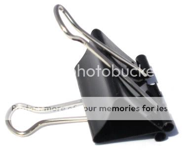

Use yablanowitz's diagram and some binder clips. This has always worked for me.
Binder Clips:
