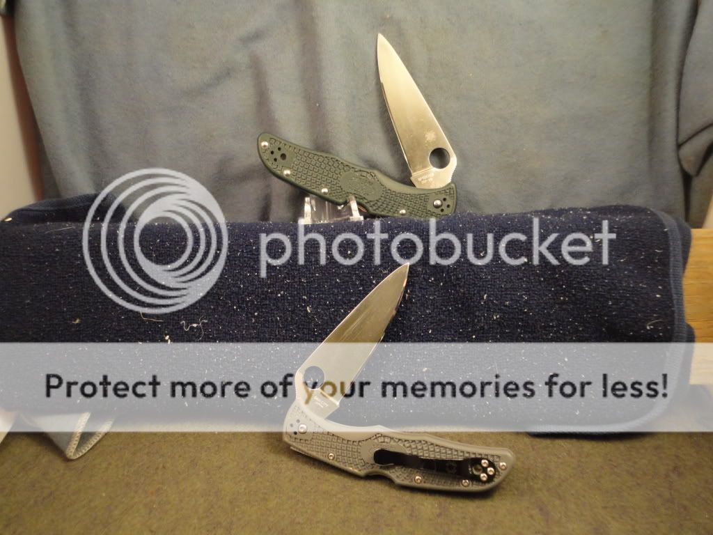

trying to show the mirror edge
these were done after a few days practice with apex edge pro. hard to photo, my thanks to ankerson for tips.
dennis
I also get mirror finish with my Edge Pro Apex, The problem is that the knives are not that sharp...Having a hard time holding the blades correct....or???
Another possibility is that the stones are different widths, meaning that once you move to a finer stone, you are no longer hitting the very edge even if the edge itself shows a perfect mirror.If you are getting th edges to burr, you may be rounding the edges with too much pressure once you get to the fine stones and polishing tape.
Make sure you ease up on the pressure too, and raise a burr (however small) at each step.
wong ki i have the ultra fine bench stone by spydie. i do,nt know if they make a finer grit.
So-Lo posted a video recently showing how he could free hand a sucession of grits ending with the x-fine spydie to make a mirror edge that was as sharp as any i've seem made on the forum.my hand & eye are not good enough to accomplish what So-Lo did but he showed it was possible to do by hand the same results that the edge pro could achive.
