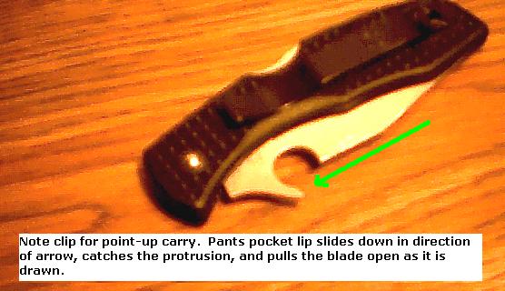

you could do something like this
The secret to the ghetto wave is to put two zip ties instead of one. The second ziptie negates any "slipping" or mis alignment. Even plastic zip ties would do.
Have this on my Endura and works like a charm.
I also agree with Marion David Poff . I will however, add that another trick to the zip-tie wave is to cut the zip-tie in such a manner that it is angled, and the tip of that angle digs into your pocket, thereby enhancing the wave action.
