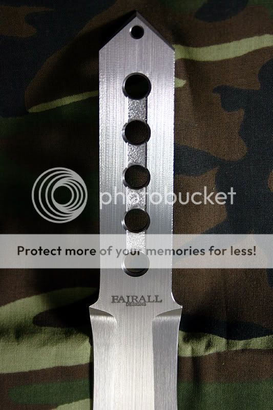

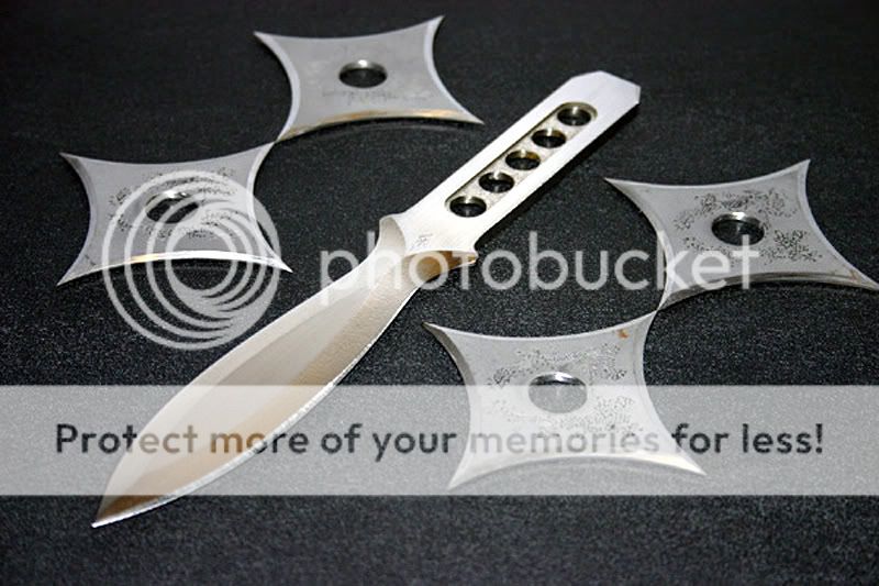

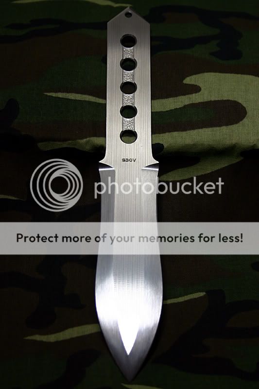

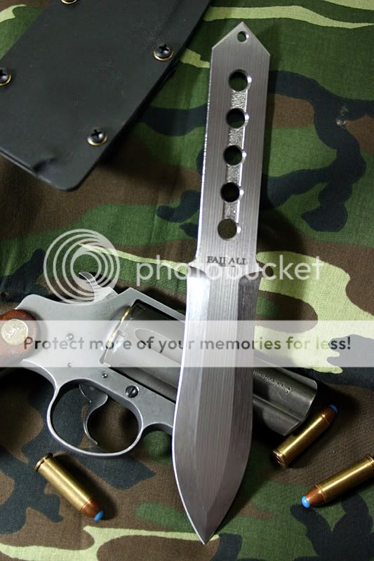

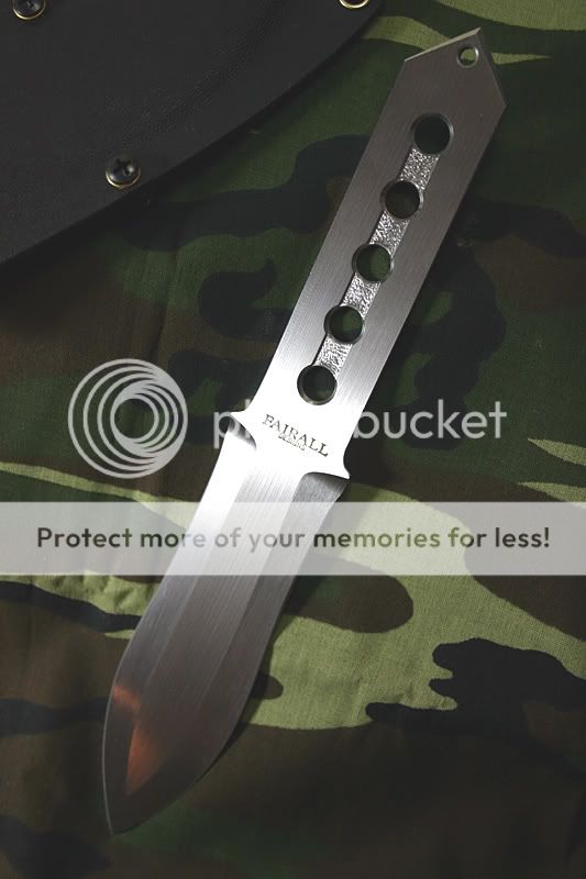

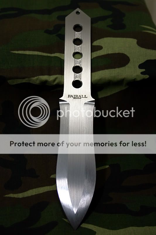

"Agent" Thrower Proto#2 by Fairall Designs.
Specs:
Steel: S30V .135 thick, 50-52 RC.
Overall length: 9.25"
Blade length: 5"
Width at widest point 1.435 "
Micro nugget engraved.

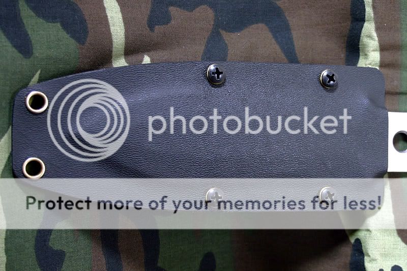

Kydex 4 position Sheath.
Thanks for looking.

I would LOVE to try that sucker out!
How much does it weigh?
The balance point is centered and the weight is 4.8 oz.

I like the overall shape of this thrower, and the pointy handle is ok although I'de personally prefer it without. The texture and the holes in the handle is excellent and really looks like it would allow a lot of control over the release.
S30V is an excellent choice at that hardness. Some folk might think; "that's pretty deluxe material for a thrower", well to that I say S30V is tough! Tougher than most carbon steels I wager and oxidization resistant to boot. Now with that being said, I think to take it all the way this knife should be polished.

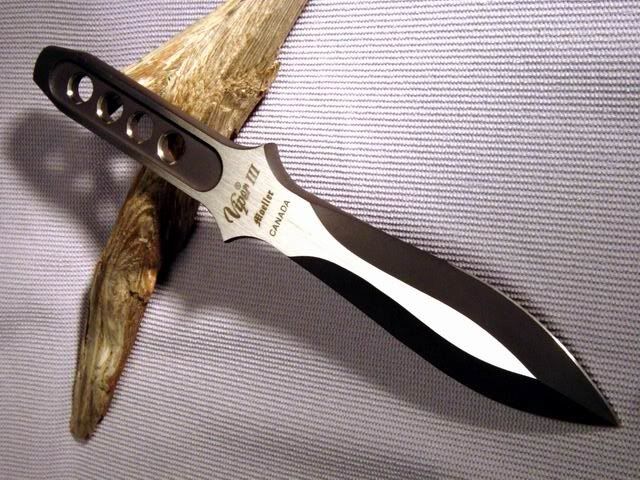

That's just my take. Like I said, I'm just a backyard knife lobber. I really enjoy it and don't mind investing in a quality thrower that's gonna last and my favourite is Moeller's Viper series. I have two IIIs and they are excellent, but a little small.

My Vipers are 440c, and they're soft enough to be tough.

man, that's a good looking knife. Love those ninja stars too!
