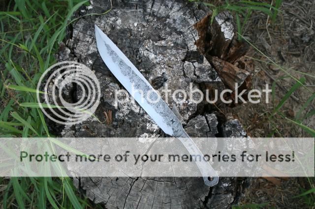

I had traced the blade of it prior to wrapping the handle, so I had a pattern to start with. I made a few suggested changes to make it more practical, which I made in blue Sharpie, to which he agreed. We also both agreed that retina-searing orange would be a poor choice for a sniper, and settled on a more subdued wrap for his.
I made a posterboard pattern of the altered design, and after a couple of false starts, got the blade forged. It took several cycles of cutting away excess metal, cleanup grinding, and re-forging to get the desired profile, weight, and balance.
After normalization and an overnight vinegar soak to eat off the scale, it was time for stock removal and heat treatment.
