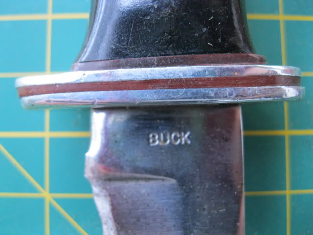

Ran across this thread the other day and became very interested in the remarks on how to zero in on the dating of this knife. For the sake of keeping the information in one place I thought it would be better to include my post on this thread as opposed to starting a new one.

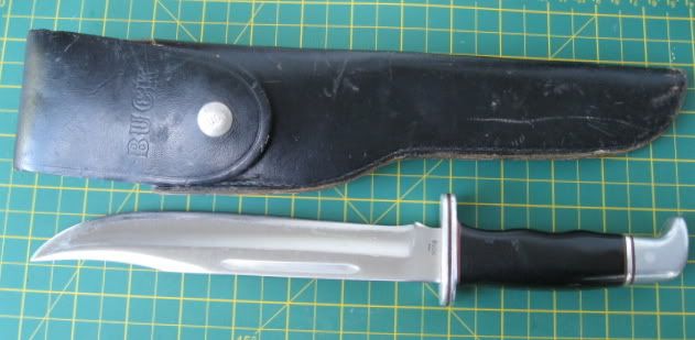

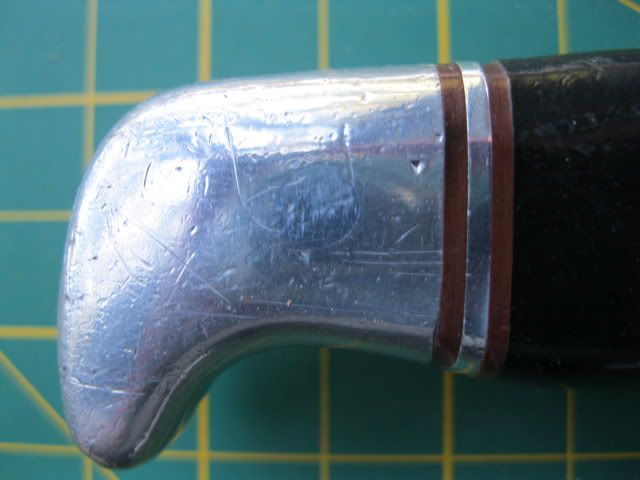

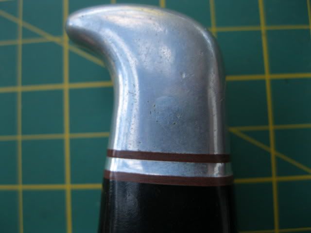

Below are some pictures of two older Buck fixed blade knives that I believe are from the 60’s period.
A 119;

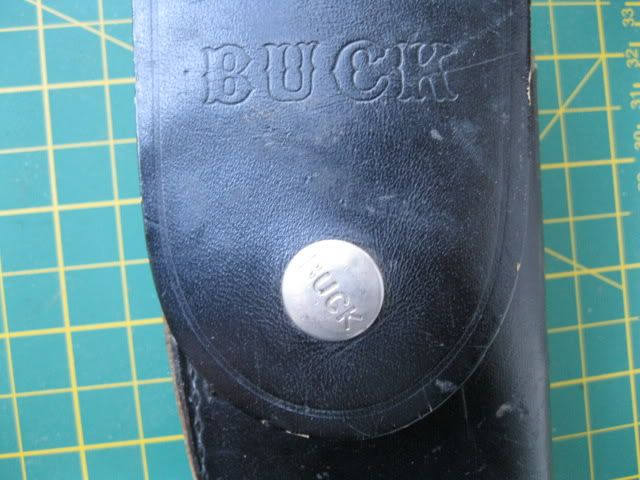

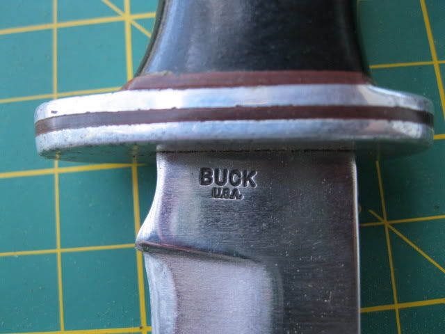

Here is a model 120 that I’m sure is later but haven’t been able to zero in on the date.

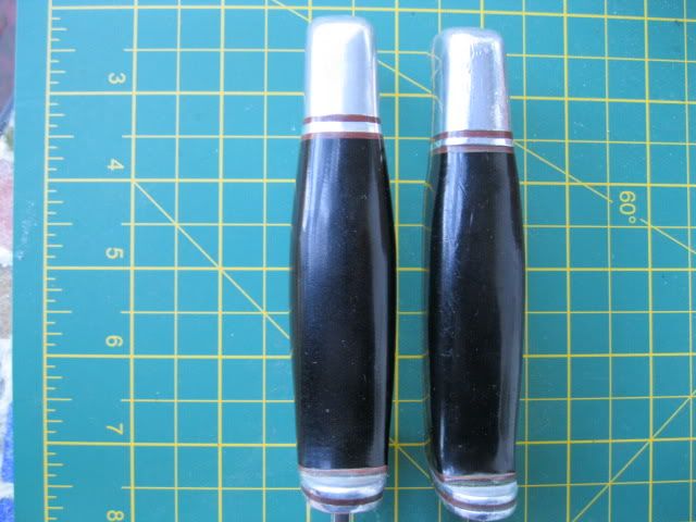

In case it might help. Heres a look at the profile of the two grips. 120 on the left.

Well, I know that first one is very early 1967 or Pre-1967.....that's all I know about that.
The second is late 1967 to late 1969.
The first is a single line stamp, manufactured in between late 1961/ '62-'66, and the second knife having bone hard fiber spacers was born in 1967/'68. Love the old ones...

Post incorporation 1961 ( incorp. April of 1961)
BUCK , Barret Nut construction 1961-1963
BUCK , 1961-1966
BUCK* , 1967
BUCK, USA , Made with bone hard fiber spacers 1967-1969
BUCK, USA , Made with Micarta spacers 1969-1971

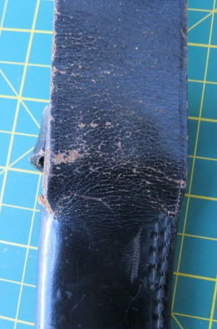

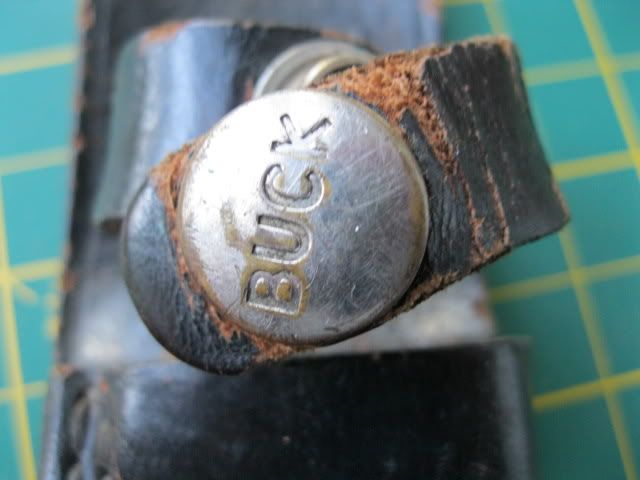

Any thoughts regarding the sheaths?
Regarding the one with the 119 I’ve been told that Buck switched over to the flap style sheath around 1964. (?)

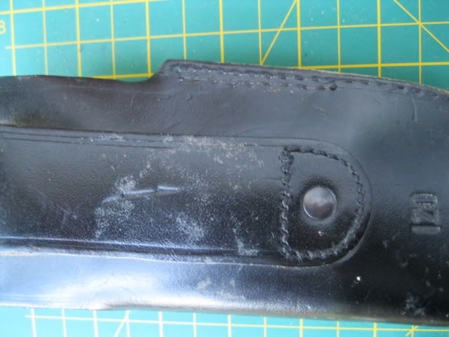

In the case of the 120 I’ve wondered if the (120) embossed on the back of the sheath may indicate that the sheath would be a likely replacement for that specific knife or if there would be an overlap of that knife being factory supplied with a model number stamped sheath?
Hope these questions make sense.
It's understandable that there are variations in notes and sources. If you got the conflicting sources together they'd probably be the last to argue that their opinion was correct and the other was wrong.
As the years march on.......the facts recede farther and farther into the past. Memories fade.
Conflicts occur mostly on end of year and beginning of year production.
The Buck Asterisk model, for instance, was indeed made in 1967 and probably not at all in 1966 or 1968.
But, the "Buck" only (Single-Line) may have intruded a little into 1967 and the "Buck U.S.A." (Two-Line) may have started a little before 1967 was over.
Those famous bone fiber spacers were probably used into late 1969 and there was probably a period when both Micarta and bone were both in the house at the same time--transitions rarely happen seamlessly.
Most of the guesses on dates of particular knives have some margin at the edges.
Sheaths are another area where you can end up pulling out your hair. The way I understand it is, prior to 1969 Buck out sourced the making of their sheaths to several different companies. In looking at your pictures it appears that your sheaths are correct for the period on both knives. Your 119 sheath is the first sheath made for the single line stamp knives ( its early in production). I've seen the fold over sheaths on single line stamp knives more times than not. I believe they changed from the collar type, like you have on your 119, because hunters were complaining that they were loosing there knives too often. Buck went to the flap over sheath to reduce this loss. In 1969 Buck brought the sheath making in house. The pre '69 sheaths have the railroad tracks on the belt loop, like the sheath you have for your 120.

Yes, the Flapover started in 1964 and really became the norm only in 1965.
The stamped 120 is probably correct.....I have a couple stamped 120 from that era.

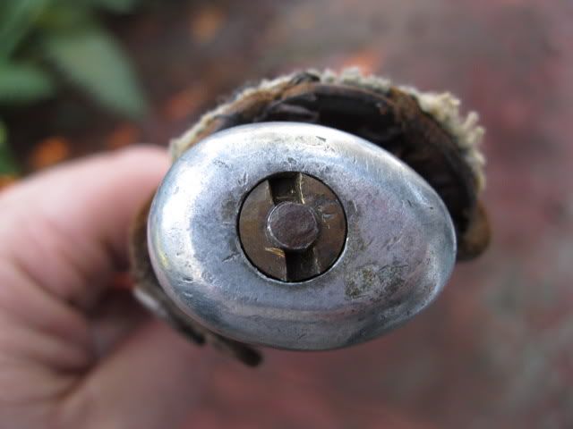

Please forgive my ignorance. Would this be an example of “barret nut construction”?
Or am I completely out in the weeds?
