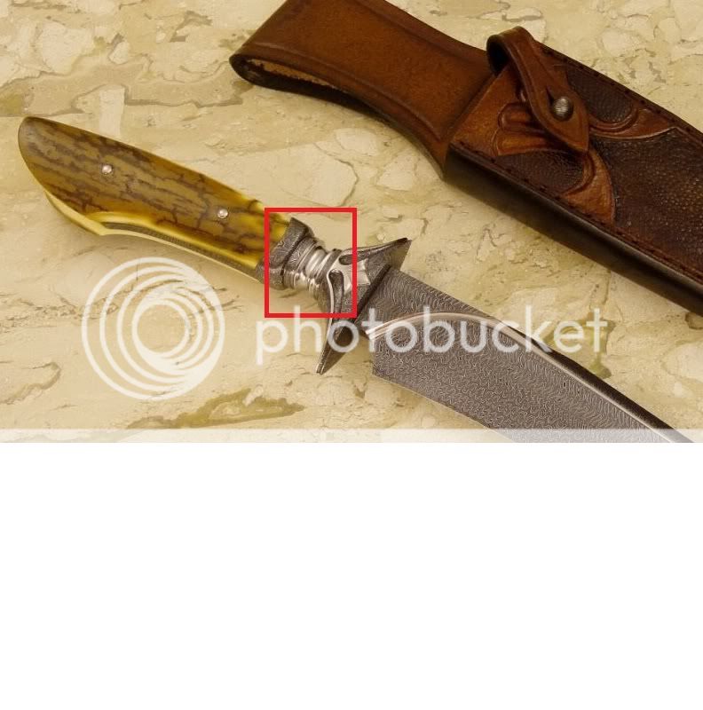

I am sorry to ask this stupid question. But I can not apprehend the reason for such structure.
Will the handle part in red rectangle weaken the connection between handle and blade?
I'm sure many will agree that yes this is the weak point of the knife, but it would take a HELL of a lot of torque to break it. By weak I only mean the thinnest point which is probably 3/8" x 3/4". A hidden tang knife of this size would have a much thinner cross section behind the ricasso. I feel this is a beautifully and well constructed knife.
It is essentially a monolithic piece of high carbon steel. There isn't really a "connection" between the blade and handle as it is all one piece.
