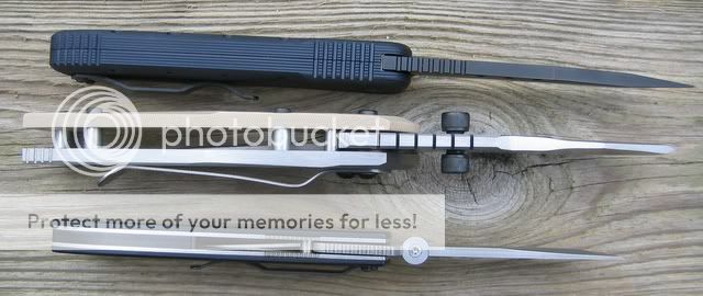

Here it is in comparison to a Severtech and a BenchMade/Emerson CQC7b.

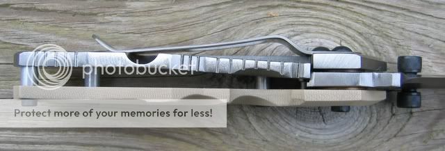

Note the lock cutout on the blade. I don't remember seeing this type of framelock before. PLease refresh my memory if you know of other knives that have this. I don't really know if this is a functional or aesthetic touch.
Lockup is solid and I couldn't get it to flex or release.

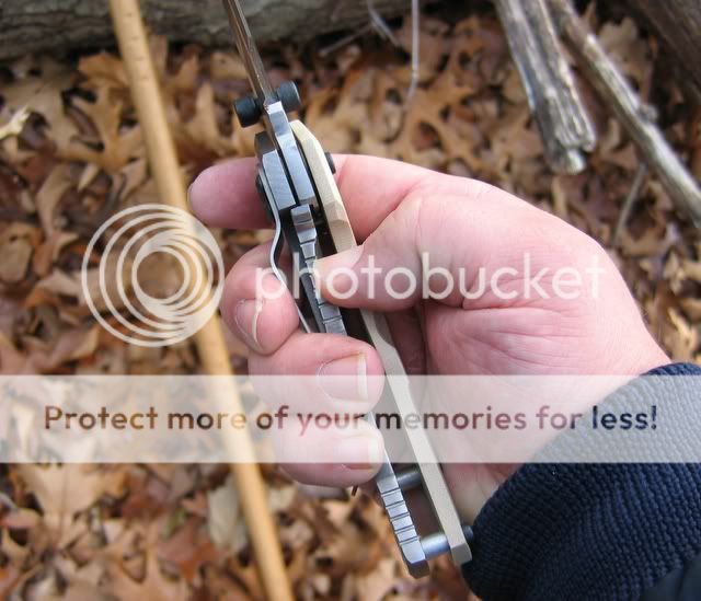

In Hand it is quite large and thick.

The sculpted sharp handle dug into my hand making any really hard thrust impracticable.

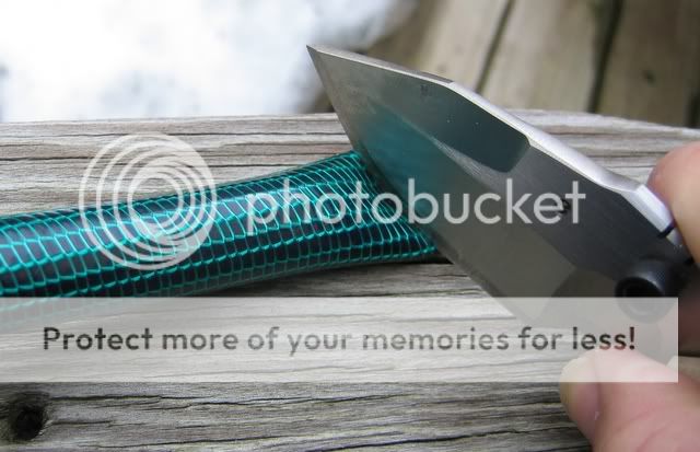

Cutting reinforced garden hose was disappointing also. It only pull cut so/so with a sawing motion
Push cutting on a hard surface didn't happen...tho I may be weaker than most folk, lately.

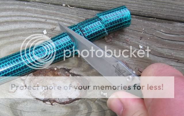

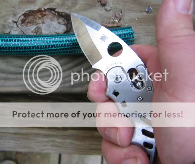

I compared two knives I had in my pocket for the push cut.
A Spyderco Polliwog
and a Benchmade 941? both plain edge.
Both EDC knives did the pushcut very well and easy.

The scales are among the thickest I've held.
Much thicker than the Severtech or BM/Emerson

added that you can see in the push cut pic of the Airkat that it was really compressing the hose. The edge never had a chance to bite in...

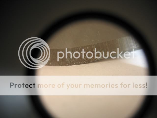

Thanks for the details, can you check the edge under magnification, I am curious about the possibility of a more obtuse micro-bevel.

ALso for hard use the pocket clip has to be removed or redesigned, it hurts too much to grip very hard. Also the thumbstuds teneded to snag for me. I'll email Dwaine and ask what the sharpened coil is for.

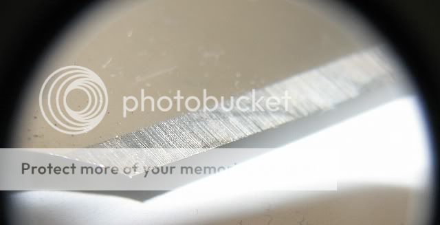

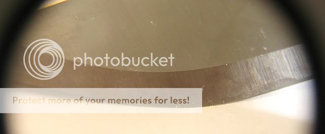

There is a slight slight slight secondary bevel seen under 10x magnification.
Near the choil 10x
10x
10x
Tom
Slight is an understatement. That looks more like an uncomplete grind rather than an on purpose micro(secondary bevel) or maybe a few freehand swipes on a fine stone before shipping. The whole layout of the knife doesn't scream precision and fine woodworking. To me it says "cut through the door skin of a Russian helicopter and slam me right through the pilot's sternum". Of course, this is utterly ridiculous but on first glance so is this knife. It seems to be more of an exercise in form rather than function. Regardless, this is what appeals to me most about it. Maybe it's meant to dismantle SCUD's or cleave Zombie's in two. Maybe it can function as a capable albeit large EDC for mundane tasks in the hands of supersized folks. Maybe it's just a cool looking showpiece that was never meant to be really used. I'm looking forward to the other passaround folks to chime in and let us know what they think.
