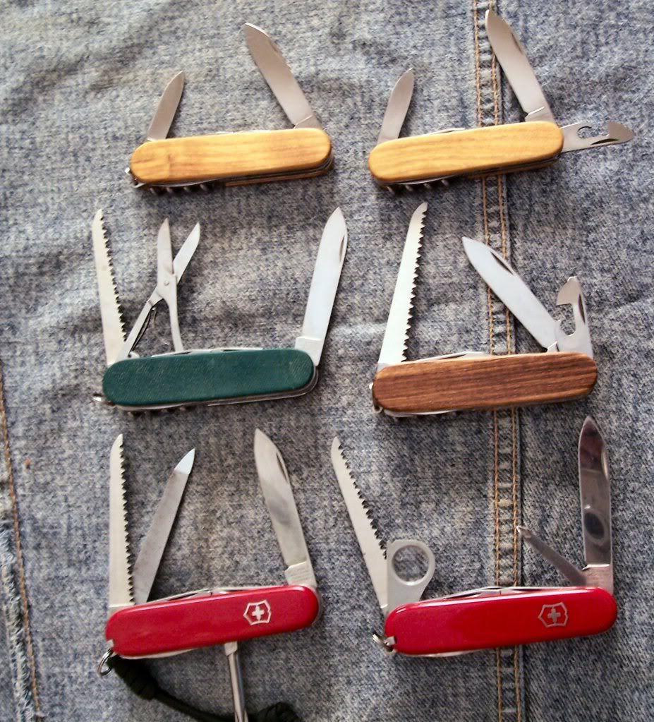

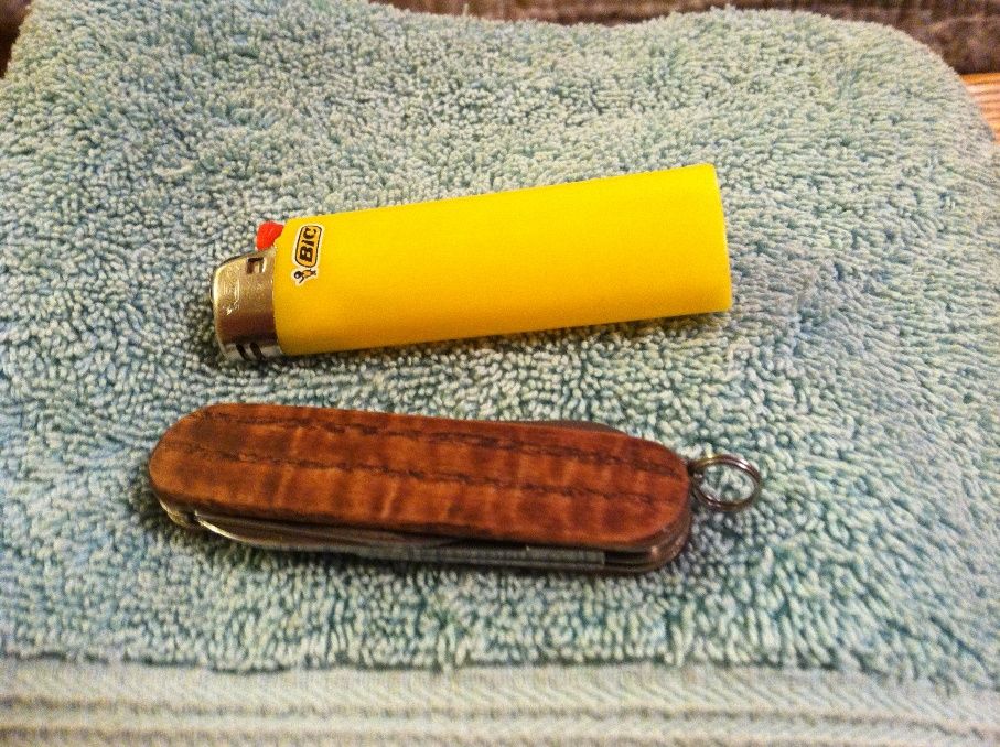

Here are a few I did, using various woods and micarta.
The two on the bottom have standard scales, but are modified to non-factory tool combinations.
Those look really good! I might have to do that with a Rambler instead of paying an arm and a leg for green alox.

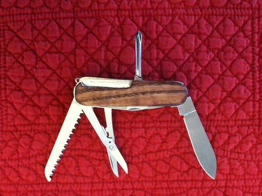

The journey resumes.

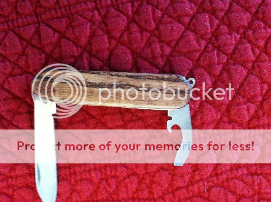

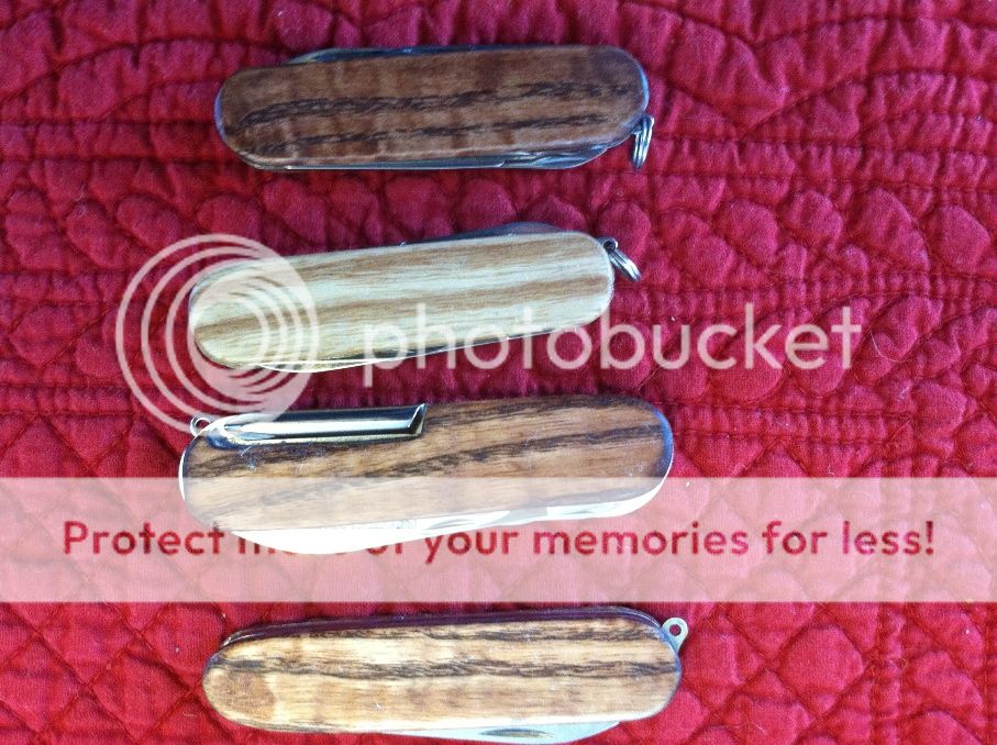

Coworker ran some hardwood scrap thru his planer and I found an old Craftsman scroll saw on Craigslist to do the cutting. Even so, they required considerable hand fitting and sanding. I have 4 done...behold!
My photography skills are low, but the scales have turned out as well as I could have hoped.
mogwai, I gotta take my hat off to ya!
You may have created a bunch of lemons through your own action of boiling the SAK's, but it looks like you made one heck of a pitcher of great lemon aid.:thumbup::thumbup: Some great looking SAK's you got there. Some of the grain in those wood scraps is striking in it's beauty and contrast. Darn good job.
Carl.
Thanks Carl,
I have about 10 more to build. The next ~6 will have walnut scales; will post some pictures when they are ready. Hopefully, it won't be another yr. :D
