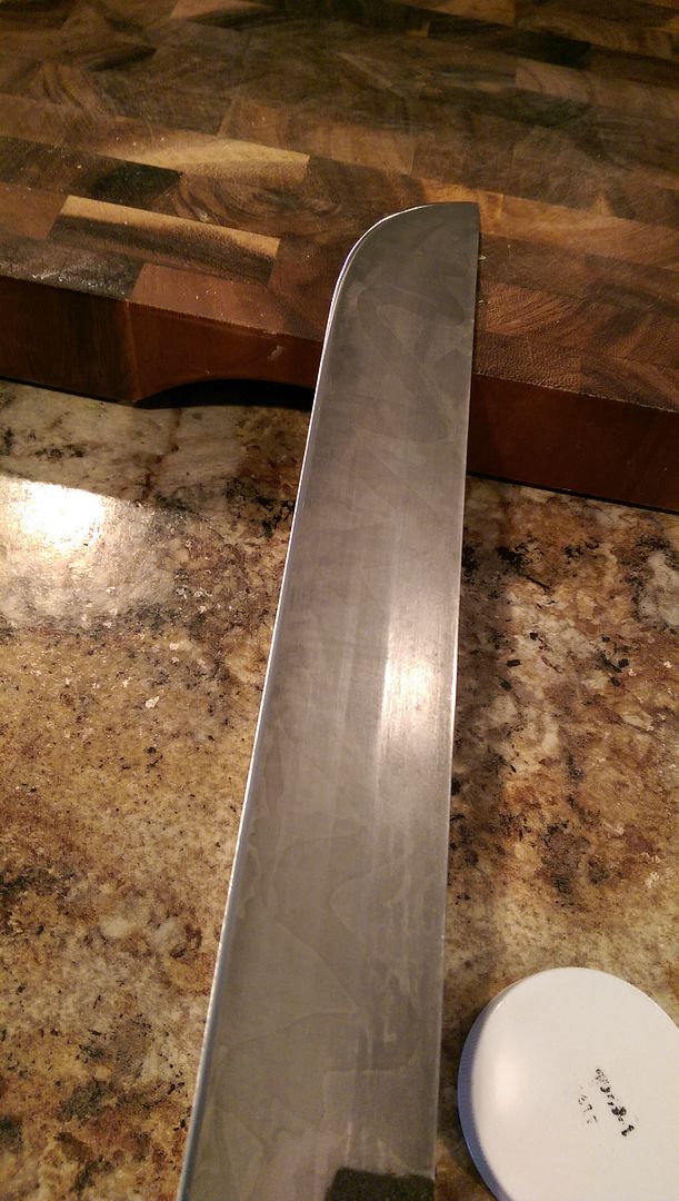

I may strip mine and force a patina. I strip all my infi if I don't get satin. I have a 1311 that's stripped and has a forced patina, it holds up well with basic care but I'm not sure if it is sr101 or sr77
What do you do to force the patina? I've read about using different citrus type fruits
You can use vinegar, mustard, lemons, bananas (probably more than that really those are just the ones I know) I usually use vinegar and then put some Tiger stripe type designs on with mustard after. You can also use gun blue
Here is my 1311 with the vinegar and mustard
Man that turned out nice. I'm a little anxious about doing it, but I'm just not a big fan of coatings for the most part.
