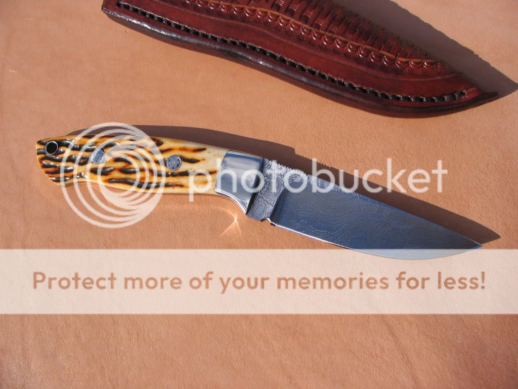

This knife was from a bar of Brad dammy
Spencer
