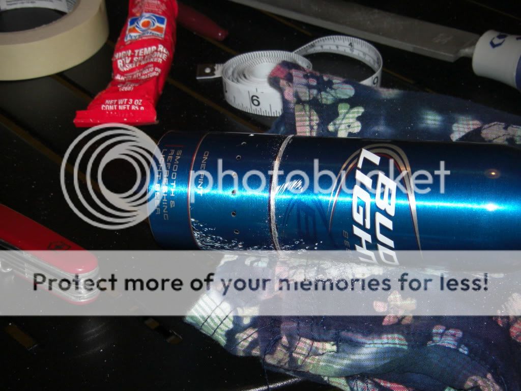

Alright guys and gals, here is a chronical on the process of the building of my first functional stove.(built an exploding coke can stove once).

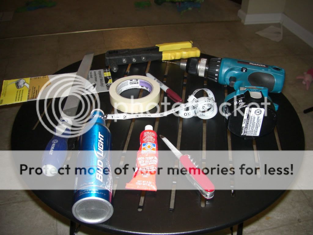

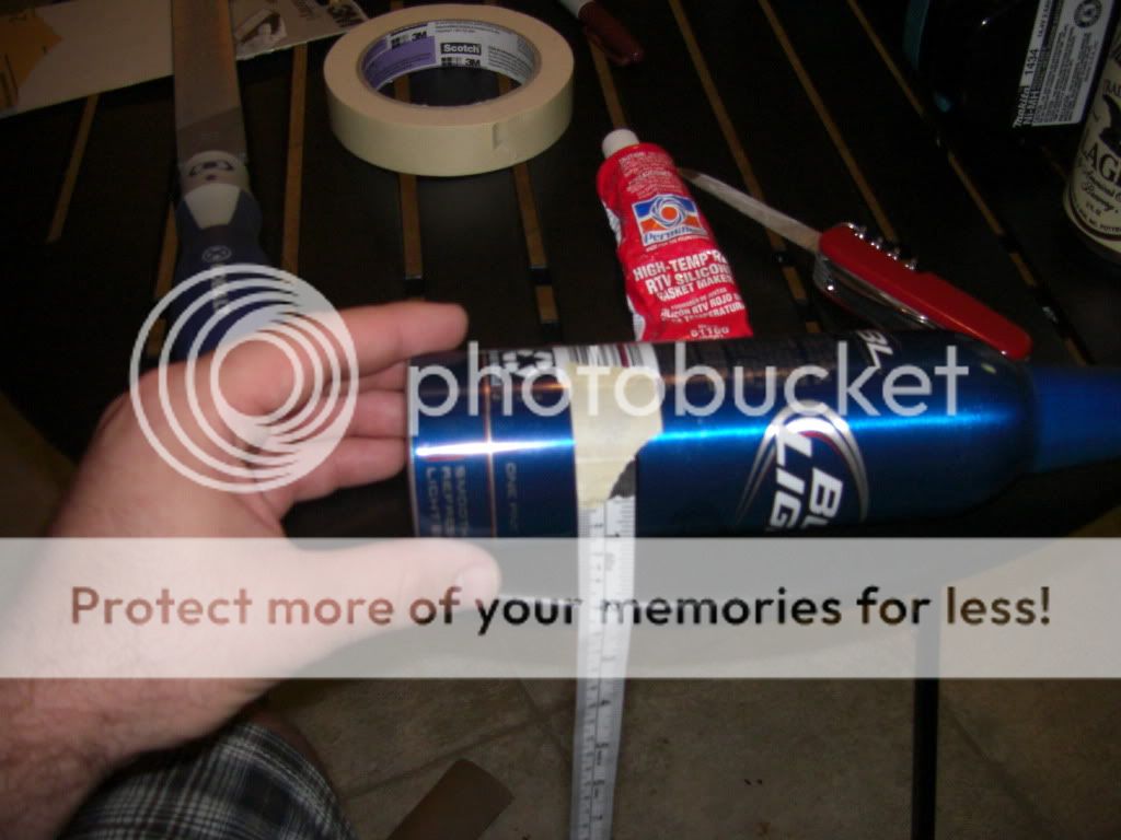

Here is a pic of the tools and equipment that I figured I'd need. I ended up not using the the red rtv and the rivet gun.

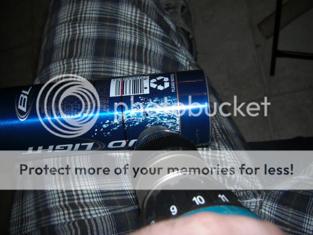

I placed a sharpie on a book and rotated bottle against it to mark the height.(no pic)

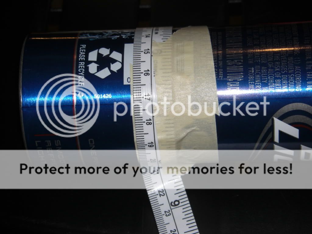

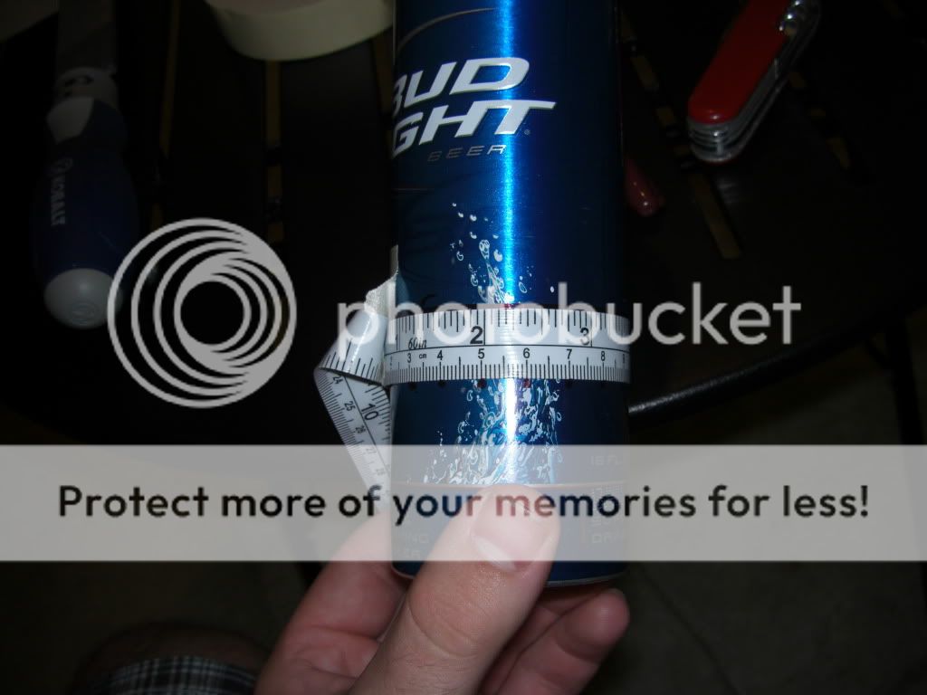

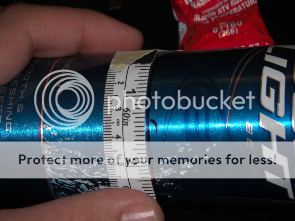

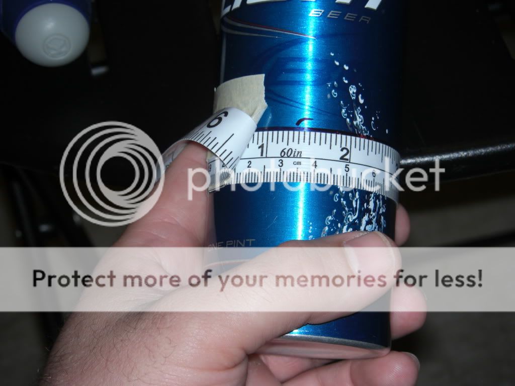

I taped a flexible measuring tape to the bottle @ the marked Line.
I measured the bottle to be about 190 mm. So I placed a row of dots @ the underside of the tape measure(wide=1/2 inch) 10 mm apart for a total of 19 holes.

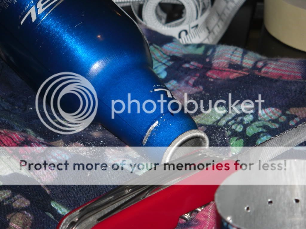

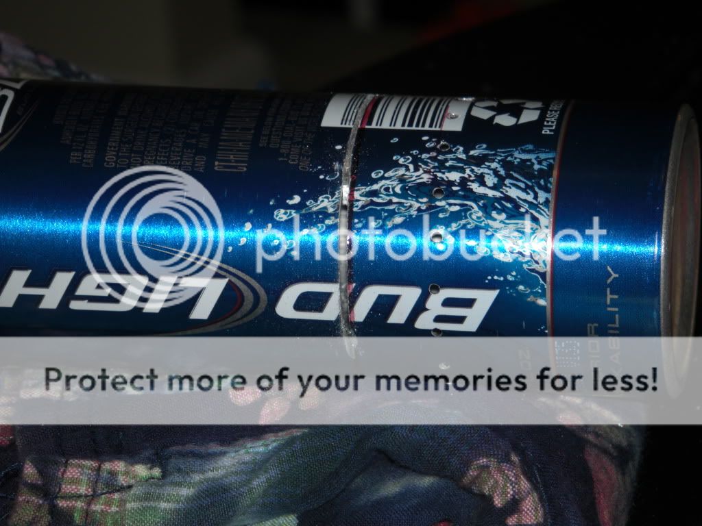

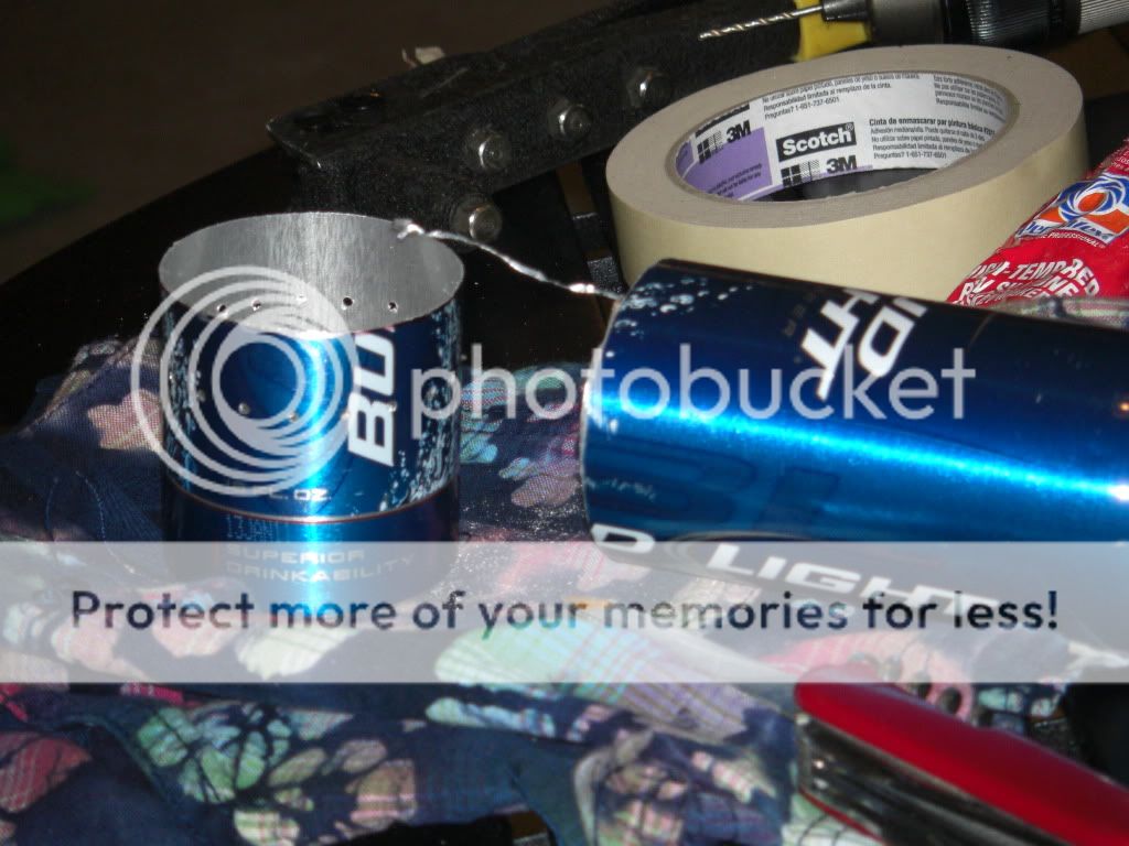

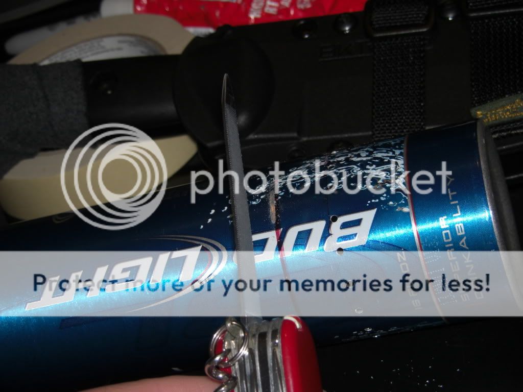

Drilled the holes

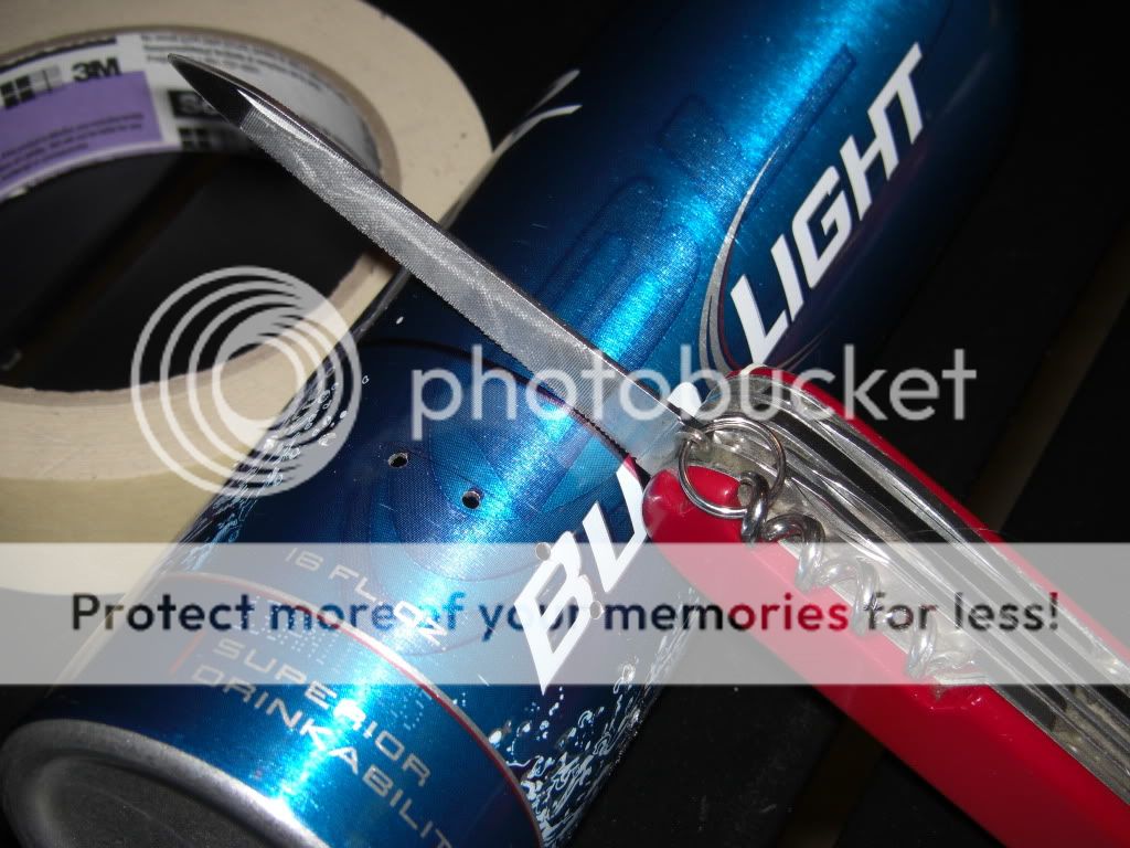

Cut out @ the marked line w/ my trusty SAK. I had to score all the way around to keep file sided saw from hanging up inside the bottle.

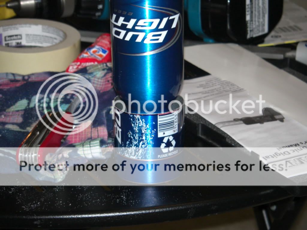

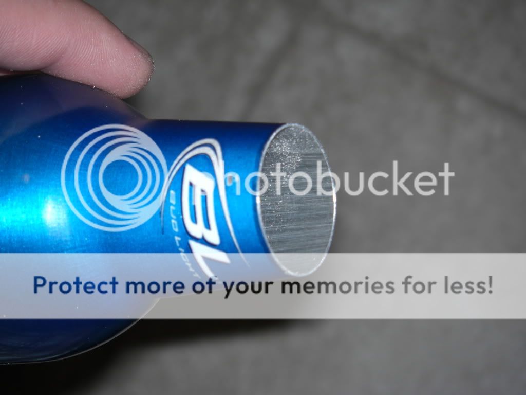

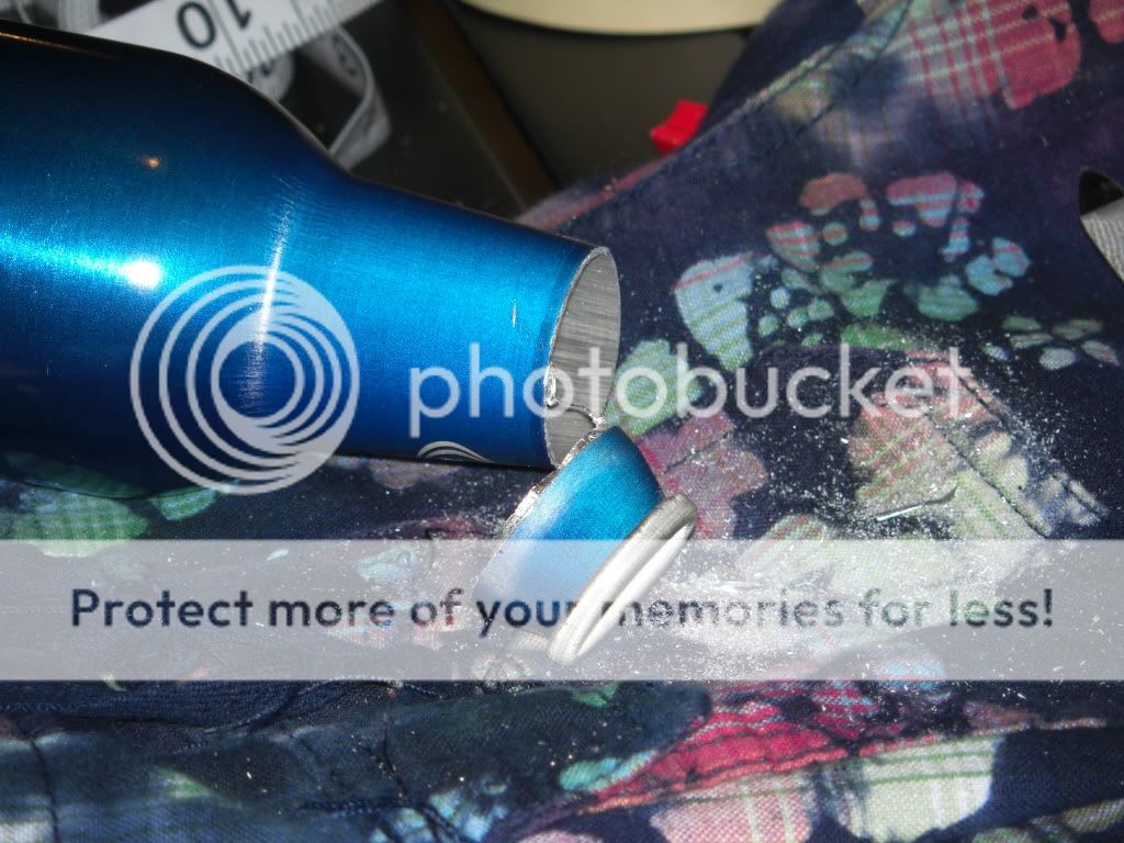

After cutting through, I placed the neck in the bottom to eyeball the amount to cut off.
Marked the amount to remove with a sharpie on a small book. Rotating as before. Then began to score the mark.

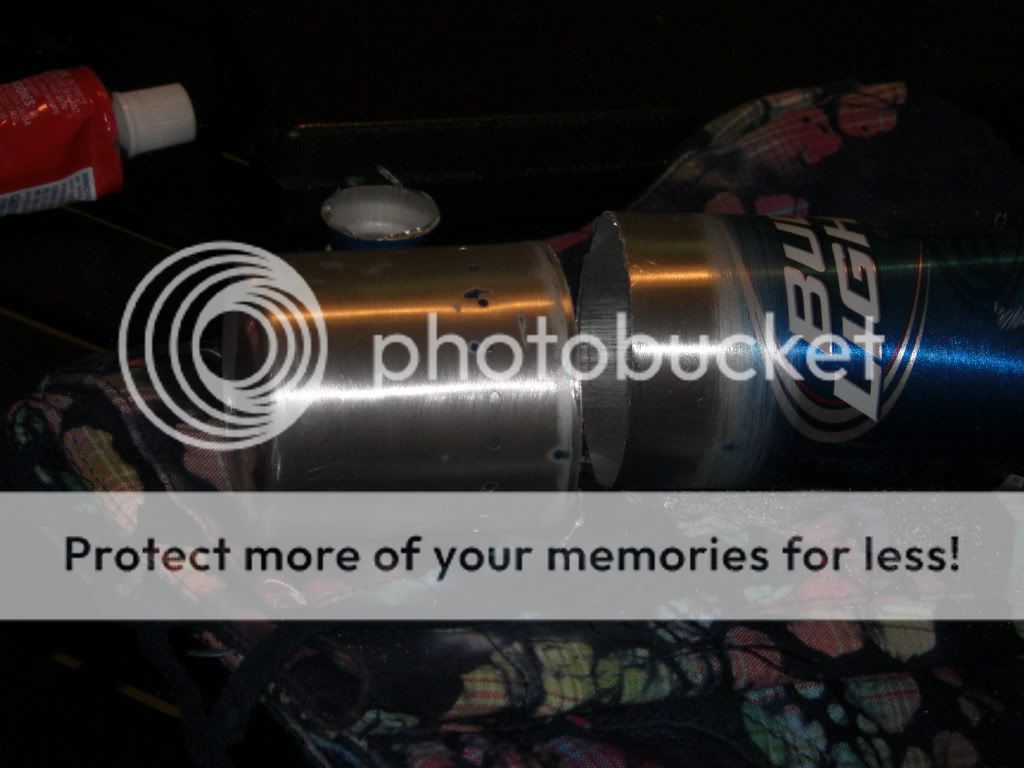

test fit the internal piece.
I used the big file to give me about 3mm clearance to the bottom of bottle.

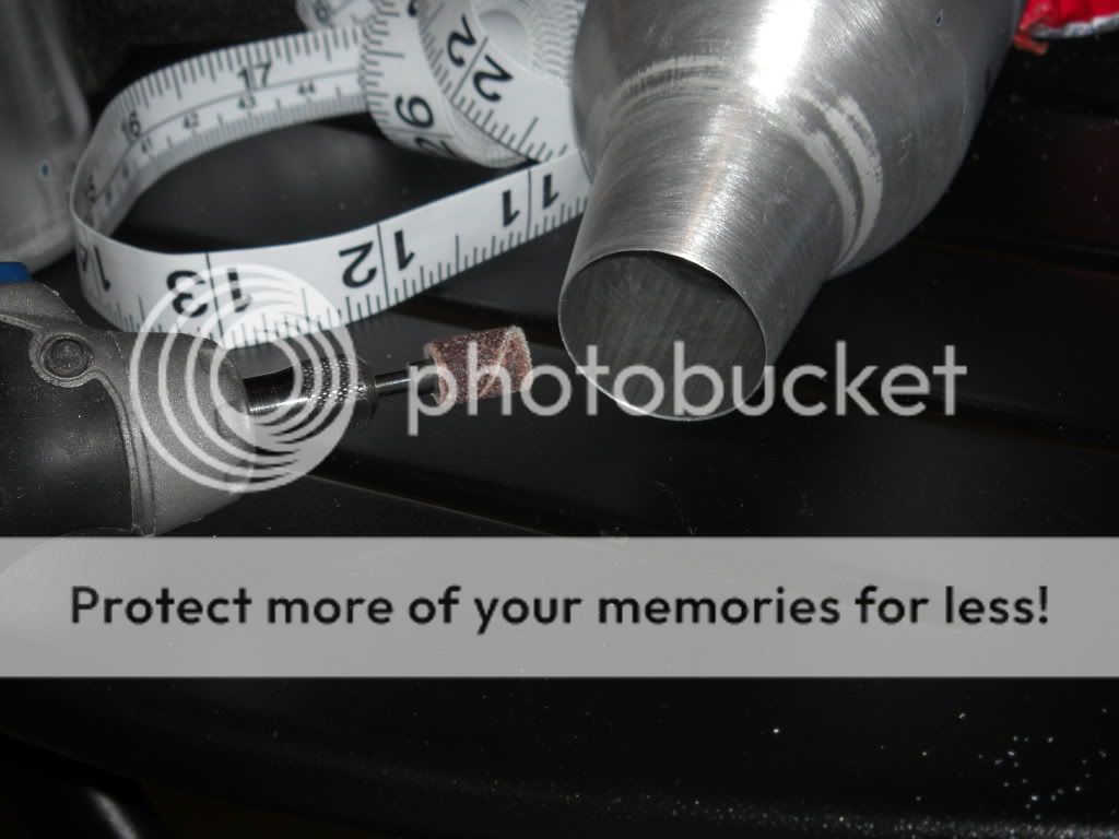

Used dremel with sanding disk to make notches. I got excited ad forgot an "after" picture. Also sanded off the painted finish.

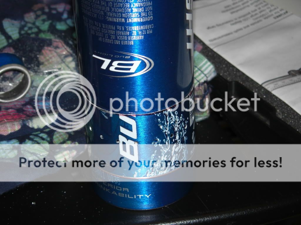

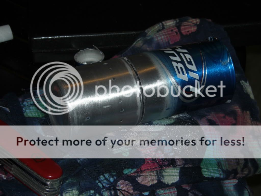

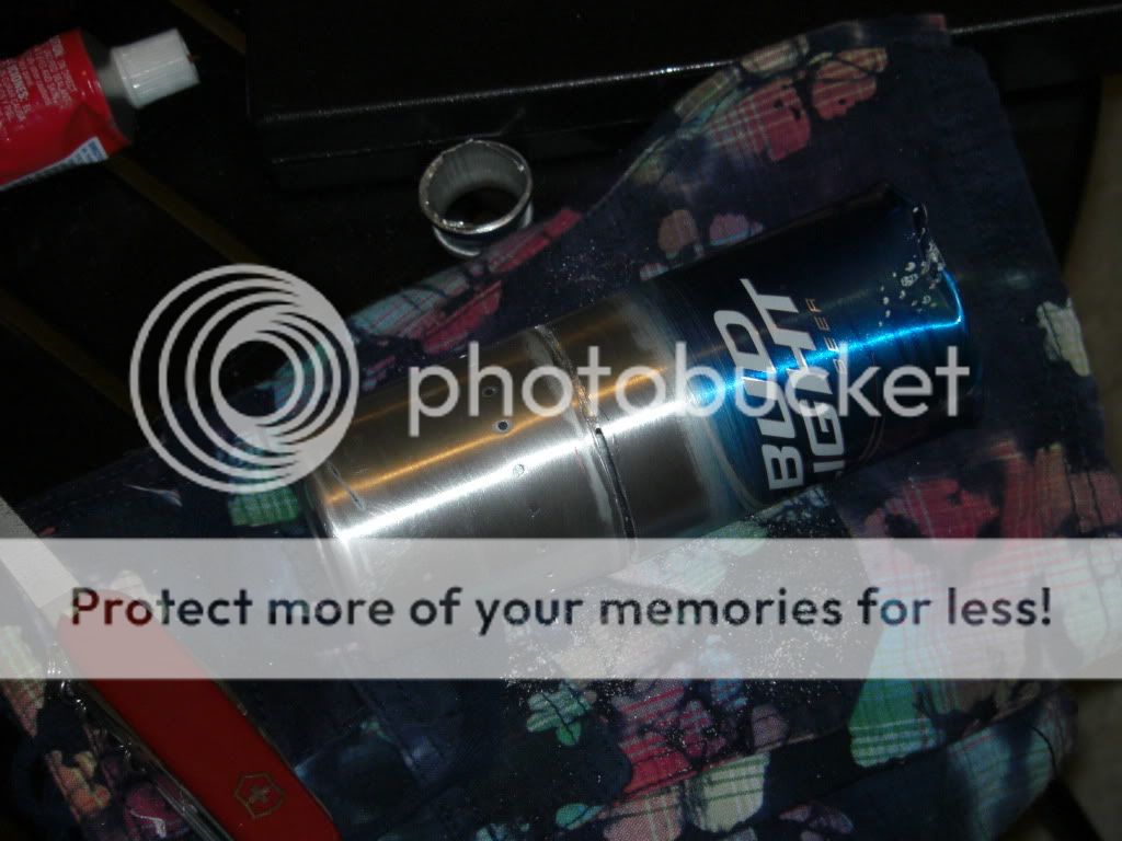

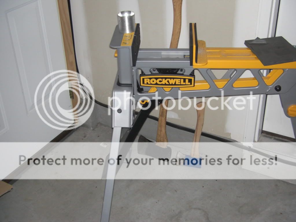

I press fit the 2 pieces using a jawhorse. Here is a pic of after.

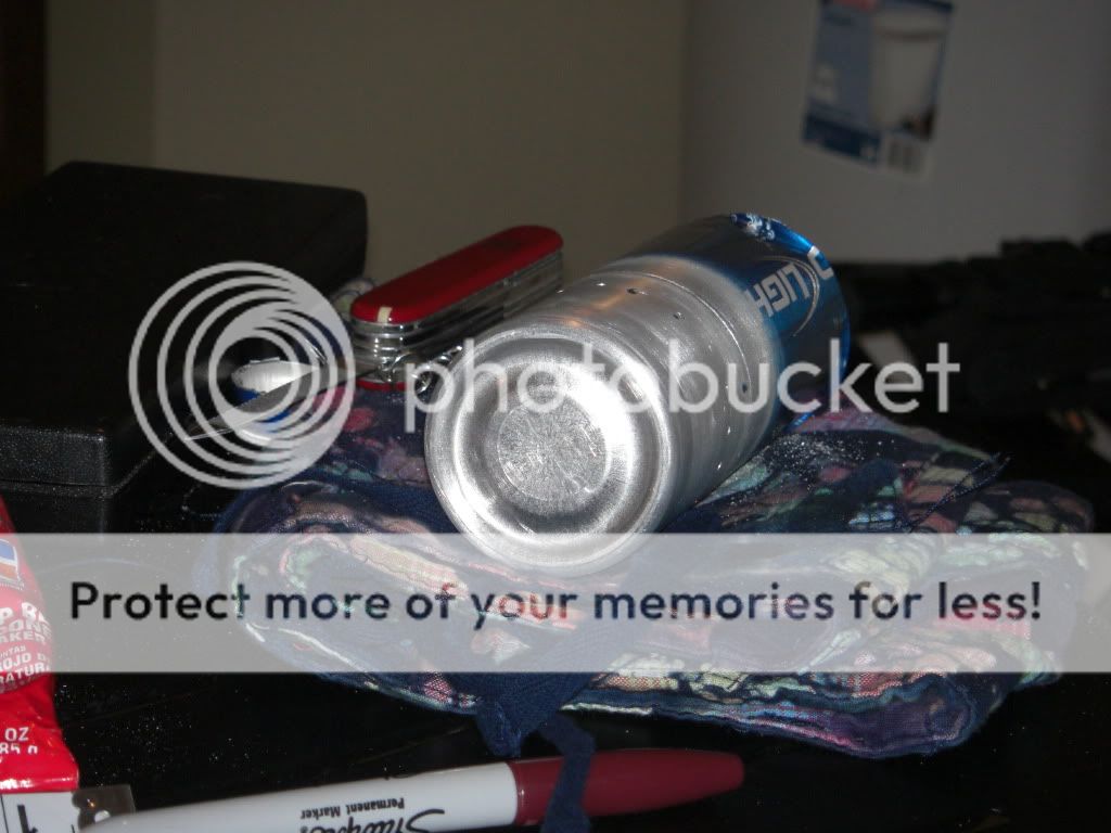

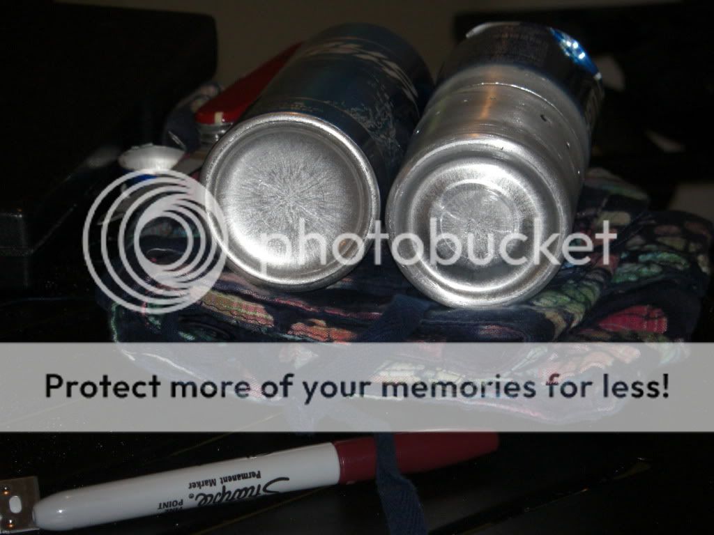

The pressing process altered the bottom of the can.
Here is a comparison.

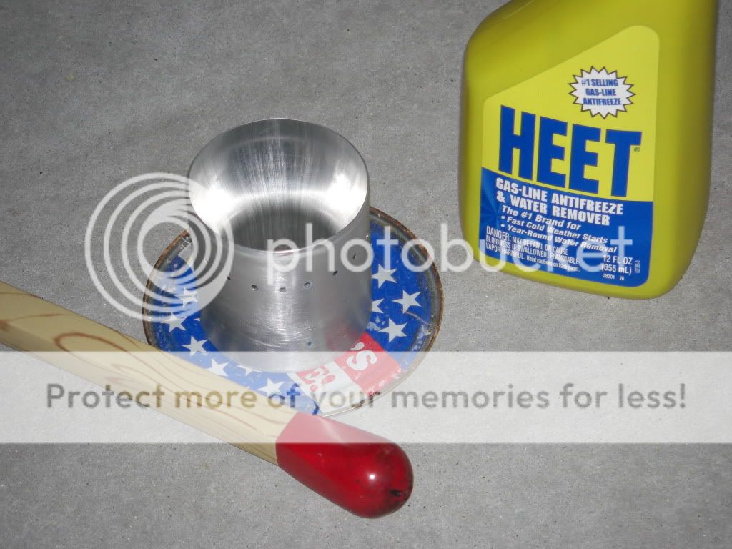

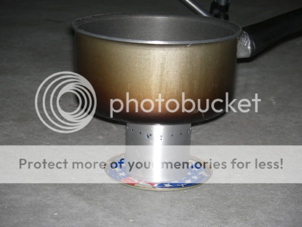

placed on a can lid as a preheater.
The stove was burning, but the flash hid the flame.

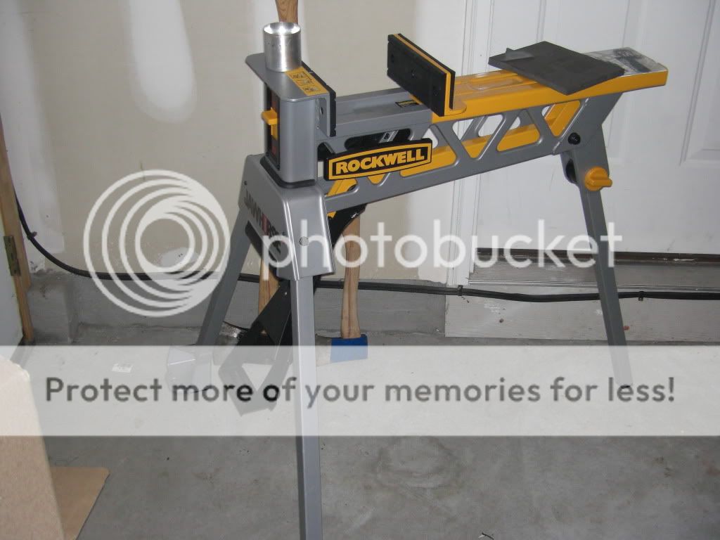

O yeah, this is a jawhorse in case you were wondering.
The jaw is operated by the foot-pedal allowing 2 free hands for placement.
