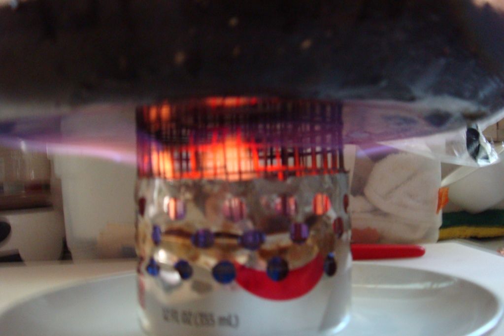

I have a Trangia for hurricane backup, but it works best with denatured or specialty alcohol like "heet"... I wanted one that would work with 70% isopropyl rubbing alcohol.... looked on the net and a couple of designs worked...they seemed to need a screen preheater and a lot of air supply, low in the body of the stove... I used some 1/4" hardware cloth, a double loop for strength at the edge for pot support, and a slightly shorter column in the center for a preheater... centered on a small disc at the bottom... the holes were done with a hand paper punch...screen needs to be red hot before placing pot
pic shows burning 70% isopropyl alcohol

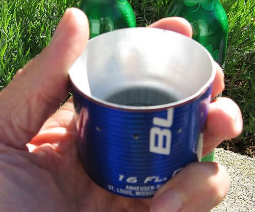

I make my own pop can stoves. I do the penny stove variant. I mostly only use them in the mornings when camping to heat up my coffee and oatmeal water. I like them because you can get yellow HEET fuel de-icer (or generic version) in practically every gas station in the U.S.

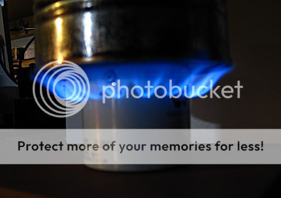

Are you waiting until the alcohol gets boiling good before you put the pot on? That's important with the Supercat stove. If you put the pot on too soon you'll waste a lot of fuel before the stove finally gets going well enough to pressurize itself and start producing some real heat.
