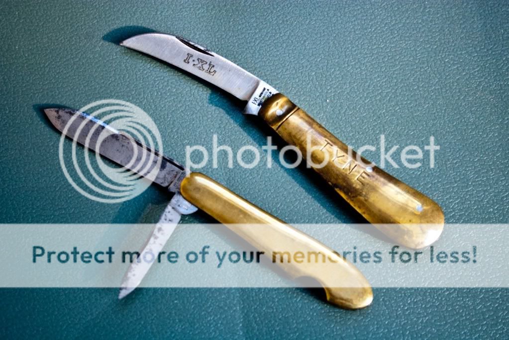

No reason not to make a slipjoint out of all brass. Here is a picture of two vintage slipjoints using brass frame construction. The Ulster (teardrop easy opening jack) has brass pins, the George Wostenholm (swayback pruner) uses steel pins.
