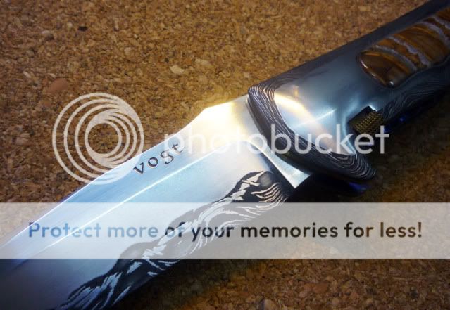

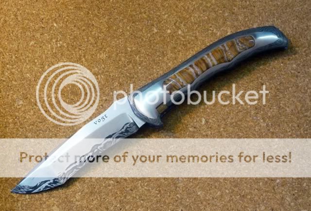

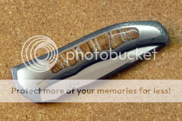

This is for a client who wanted something different, and this is the result... at least different for me!
It's an auto, shaped in something similar to a Darrel Ralph model, that I allways liked.
Blade and scales are san mai, with damascus core in laddered W's from Marcial dos Santos (scales has a tighten pattern), and I forged the san mai with 15n20 on the sides.
Scales have mammoth tooth inserts.

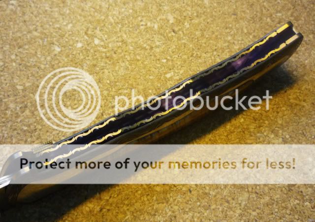

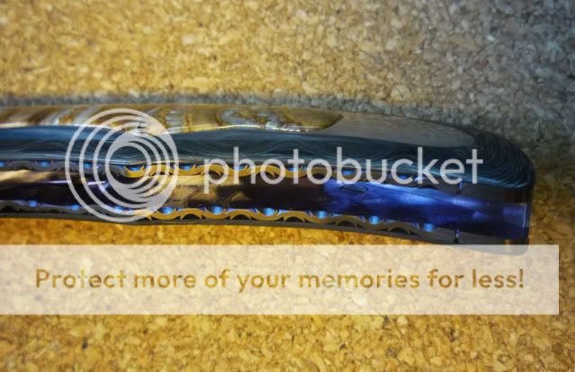

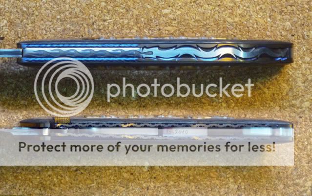

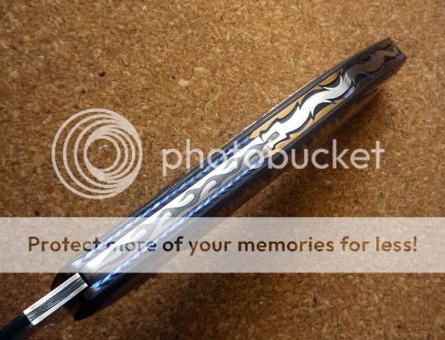

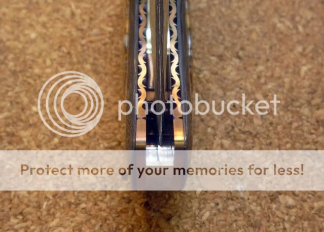

Liners are titanium, fully fileworked, jeweled inside and anodized (my first one!). Opening button is TI too.
Spacer is Bolher N678, fileworked and etched, and has an mammoth ivory bladestop inside.
As I wanted a clean image, I made it with hidden screws.
At the end is a video...
I hope you like it!!!
Any questions and comments are allways wellcome!
Javi
