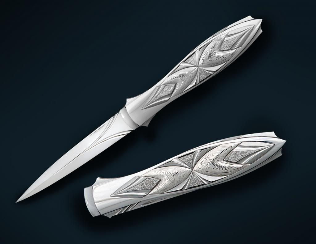

Another one completed. I have a hard time photographing these all steel knives. This one truly looks much better in hand. The inlays blend together nicely, the photograph makes them seem somewhat disjointed. The clean look of the all steel pieces do appeal to me.

Wolfgang, can I ask how are the steel inlays attached?
Again, gorgeous knife.
Patrice, like all interframe handles, I cut/file an inlay pocket into the handle. Typically I go about .090 deep for the cavity. To allow for the carving, sufficient thickness of the inlay components is a must. That makes gold inlays expensive, they need to be at least 1/8" thick, more in many cases. The inlays are fitted to provide a light press fit, then held in place with adhesive.
